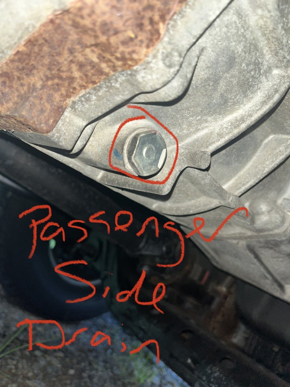

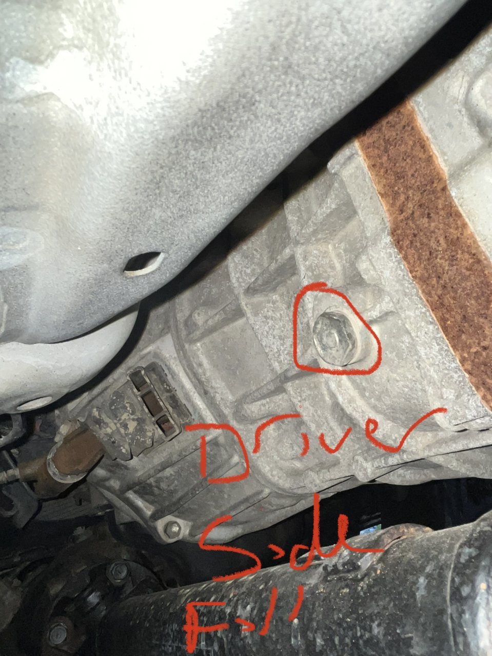

    I got a 2012 2.7L 5 speed manual and am going to drain and fill the fluid I just wanna make sure I got the drain and fill plugs correct. Let me know. Thanks.

    Those look correct to me!

    Looks correct. :thumbsup:
    FYI-remove the fill plug first. Use 6 point sockets. Not a bad job to do.

    I've seen it happen where someone drains a transmission, transfer case or rear diff and then can't get the fill plug out. Not fun.

    Be careful you don't strip those out when reinstalling. Use a little Teflon tape and just snug. I don't know the torque but you're screwing into aluminum.

    There’s a torque spec in the sticky section at the top of the thread.
    https://www.tacomaworld.com/threads/the-torque-spec-guide.318116/
    Yes sir, I have also seen that happen. Bad day.
    There are crush washers for each plug. Replace those and tighten to the proper torque spec.

    I know the crush washer is the 'proper' way to do it but I like Teflon tape. IF you don't get it tight enough, I like to think the TT will keep it from vibrating back out. It's just always been my preference.
