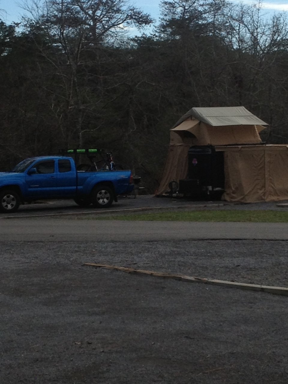

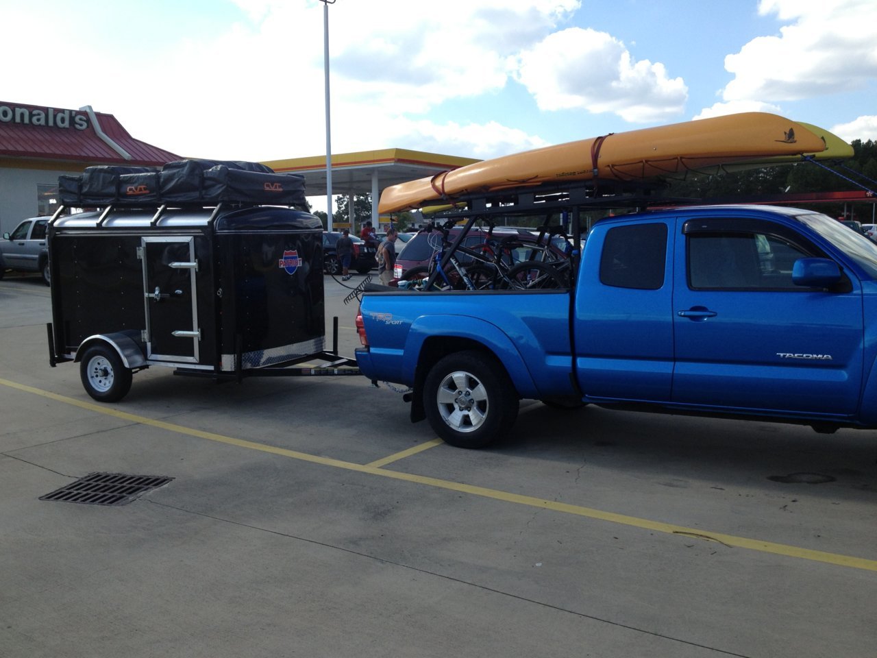

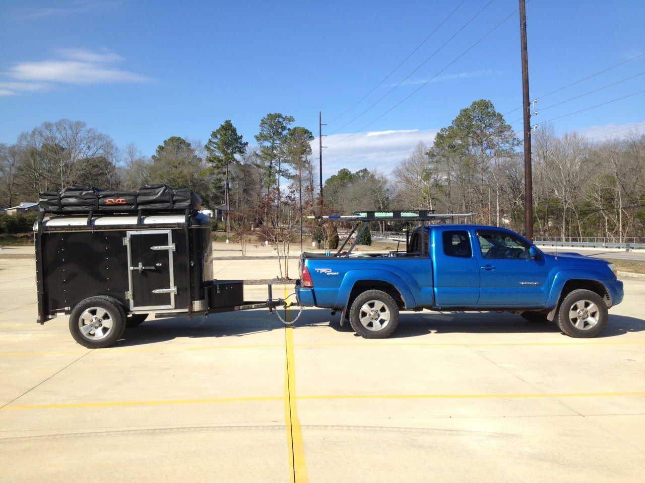

    I’m looking for a newer 6sp double cab 4x4 TRD in blue. Has to be blue. 16358D93-65BE-4FEB-9B9F-67983F3831AB.jpgD04B633B-8EB8-492C-82C9-25FCD30C67B7.jpg F265995A-8DEF-4523-B065-C9A99B041605.jpg
    The second picture is before suspension upgrade and the matching wheels in the trailer.
