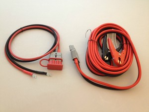

    ok that is what i bought. I just want to make sure so i don't screw crap up. I was also thinking of make quick disconnect jumper cables would i need a fuse on that line?

    ok.
    plan on doing something like this
    Those damn quick disconnects are not cheap.

    Jumper cables?
