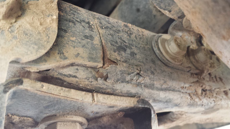

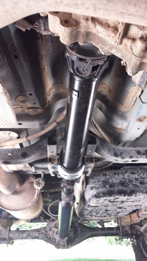

    Revised Drive shaft
    I just found a crack in my cross member:(

    Damn. Driveshaft looks brand new.
    Did you read that thread where Monkeyproof had the same cracks? I think you can just weld them, grind them smooth and slap on a layer of paint.

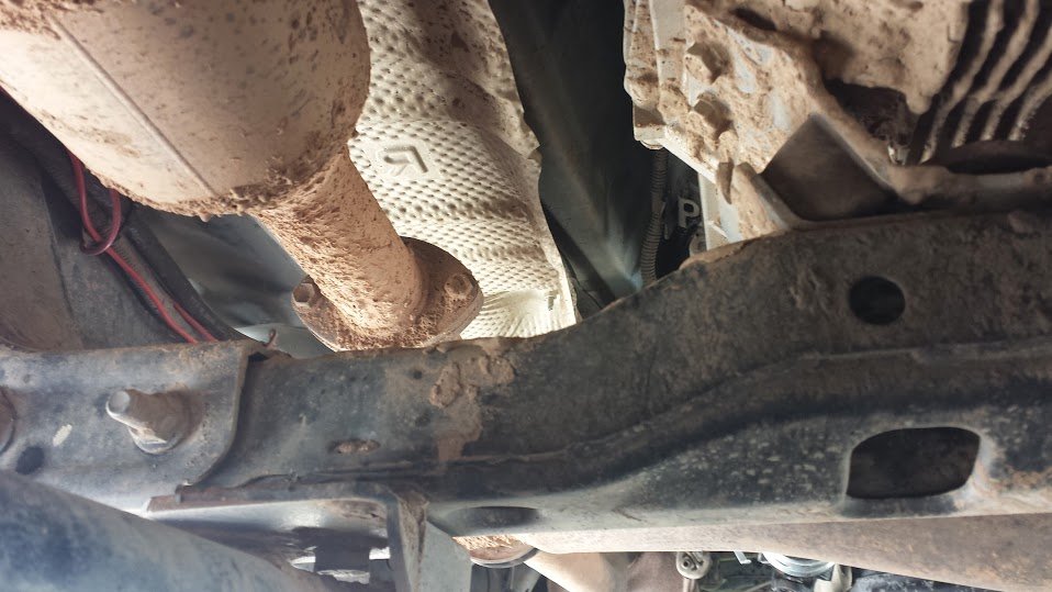

    Transmission crossmember.

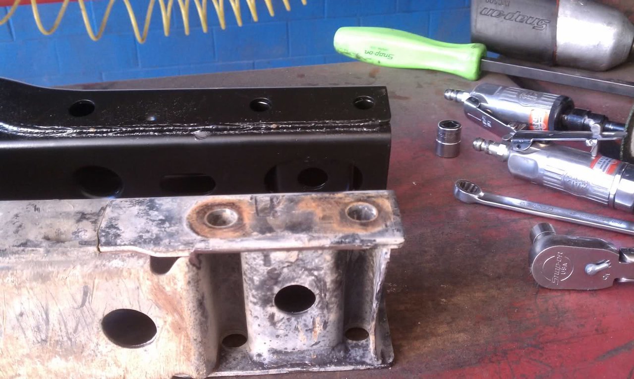

    Interesting in difference between the new cross member and old.

    4" Bodylift 20" Offroad shock spacers Turbo Encabulator
    That is strange. Seems like it would be easier to just box it the whole way like the new one instead of having the ends open like the old one. Are you gunna buy a new one or fix the old one?

    Thinking of having HBTACO02 plate it.
    The crack is only on one side, look like tom had it on both.

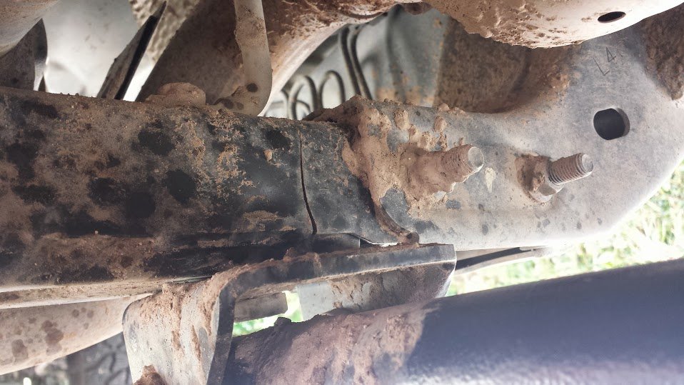

    ID
    here is other side.

    ID
    Damn drive shaft was easier to put on than take off :facepalm:
    Really? What issues did you run into? Just unbolt the carrier bearing and the 4 bolts to the 3rd member right? For me it was the opposite. Harder to put back on but only took a few extra min.
  16. Jun 23, 2014 at 10:26 AM
    #2556
    Manwithoutaplan
    Manwithoutaplan [OP] the full Monty
    Jan 30, 2008
    #4500
    54,643
    ID
    Yea cause the Drive shaft was seized on to the 3rd member and transfer case.

    DCFB
    Yup, that old cross member was definitely a bad design. The break is right at the end of the weld. Bummer!
