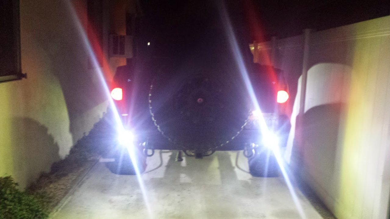

    woot i figured it out. When i back up i get the stock reverse lights and led lights :woot:

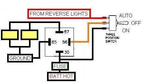

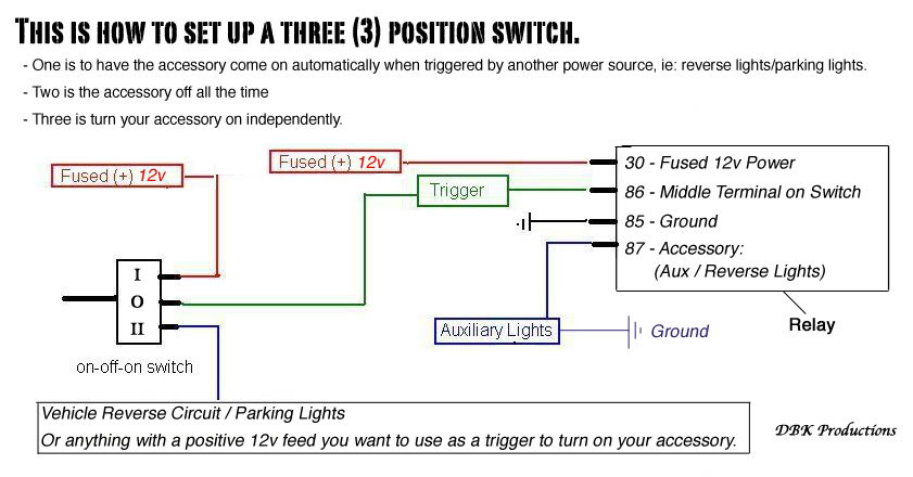

    1 position / ON - leds and reverse lights work together. They both turn on when shifted in reverse
    2 position / OFF - leds are off. Just reverse stock lights go on.
    3 Position / on/ manually - leds turns on by a switch. This will be useful when i am hooking up the trailer and camping.

    23717d1165266382t-aux-reverse-light-wiri_469192386f3c30c82317f6d39e702063c75814f7.jpg
    use this diagram simple but easy to follow.

    Got ya! I converted my reverse lights to HID and wired in a switch and diode so they come on in reverse or with the switch.
  16. Apr 23, 2015 at 8:12 AM
    #4236
    Manwithoutaplan
    Manwithoutaplan [OP] the full Monty
    Jan 30, 2008
    #4500
    54,641
    ID
    What does the diode do?
  17. Apr 23, 2015 at 8:30 AM
    #4237
    BradyT88
    BradyT88 Well-Known Member
    Nov 3, 2011
    #66419
    36,723
    Keeps the power from going up stream. haha When I would flip the switch my reverse light on my dash would come on (and the light for whatever gear I was in, so I could have it in drive and reverse! haha) and my backup camera would come on.
