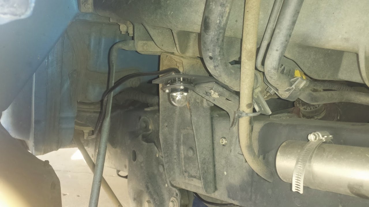

    That looks amazing man, so you just purchased some scrap metal pieces from home depot and made them with say a dremmel?
    If you can point me in the direction of what scrap pieces you purchased and tools you used to make it that would be helpful, I have an idea in my head and I want to see if I am on the same page. Looks awesome dude.
    Edit: Where did you mount them in the rear?
    Thanks again man

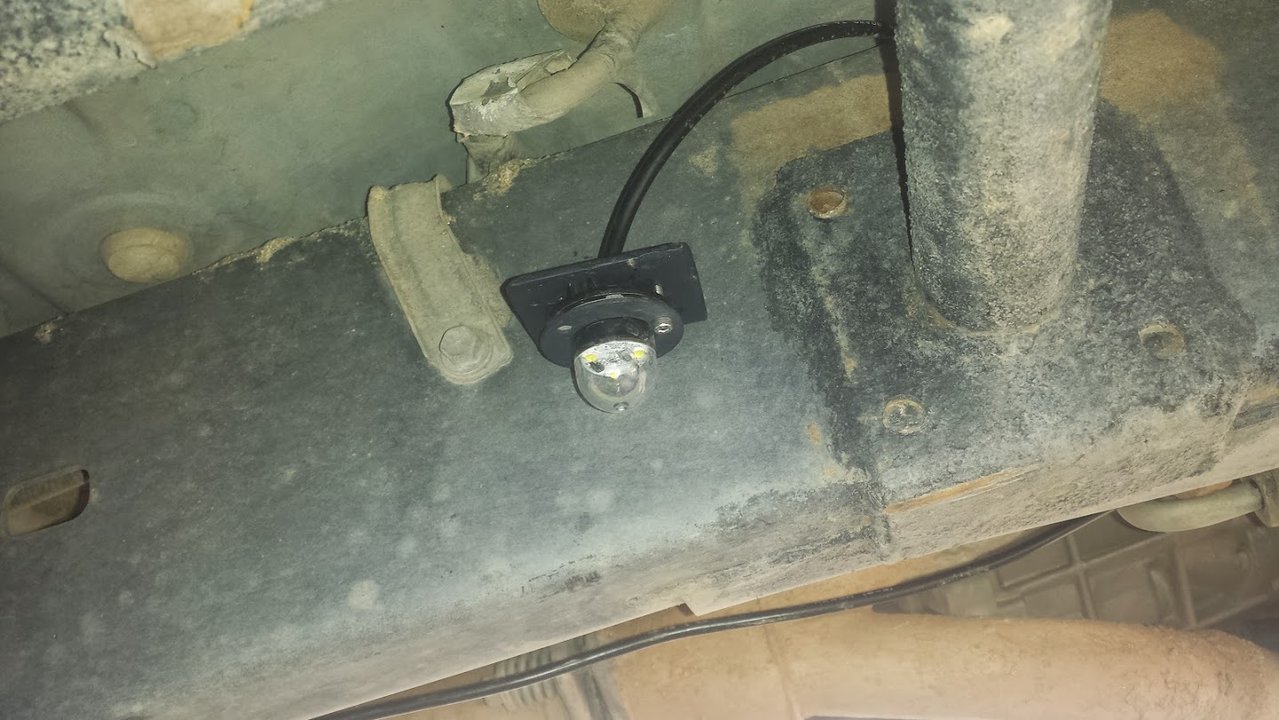

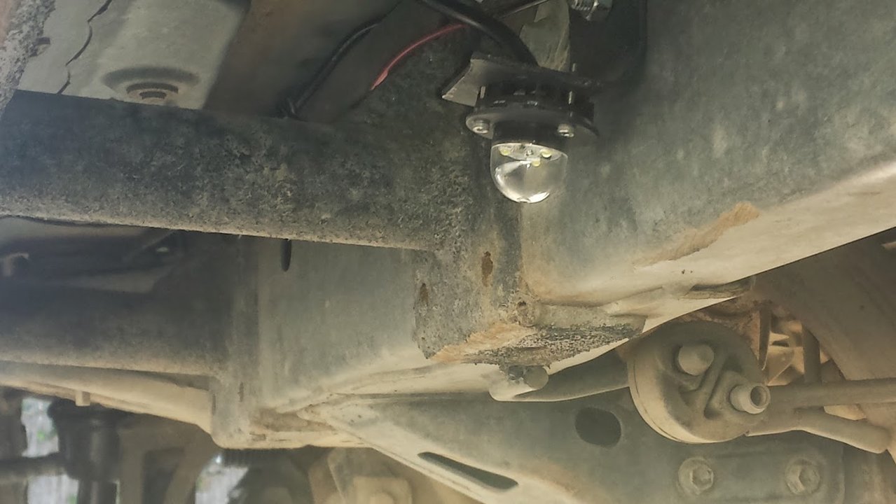

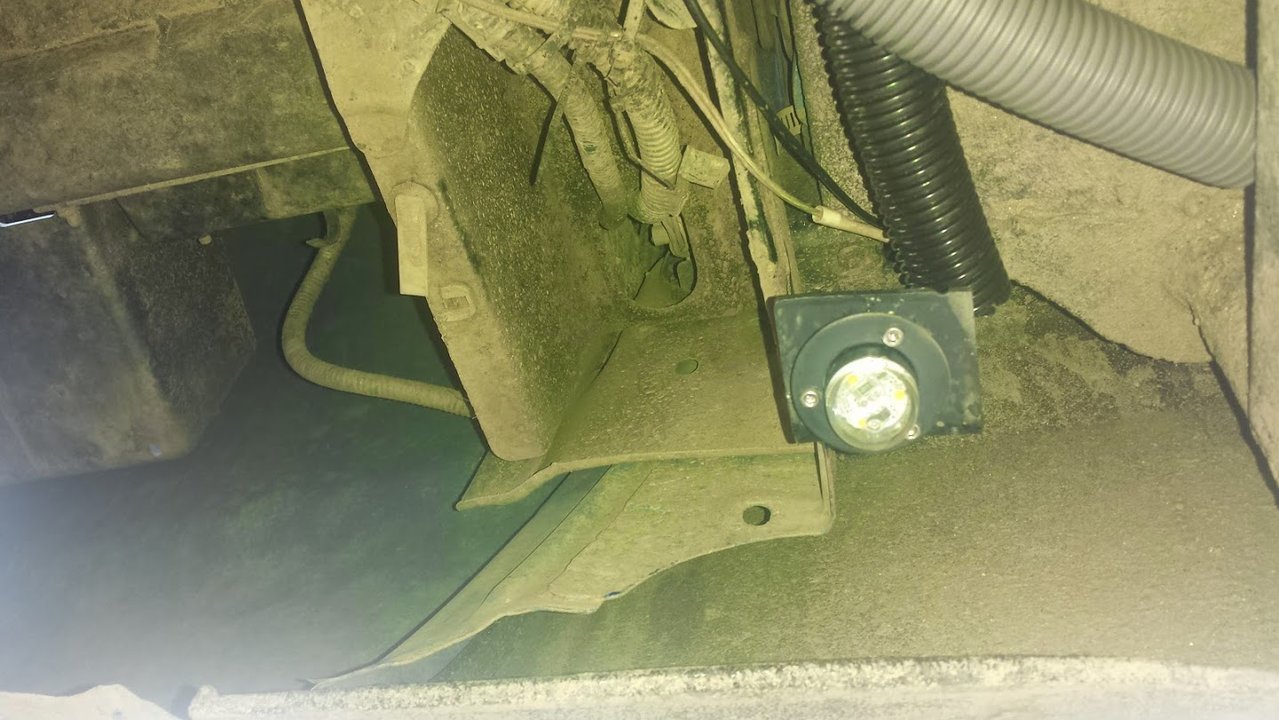

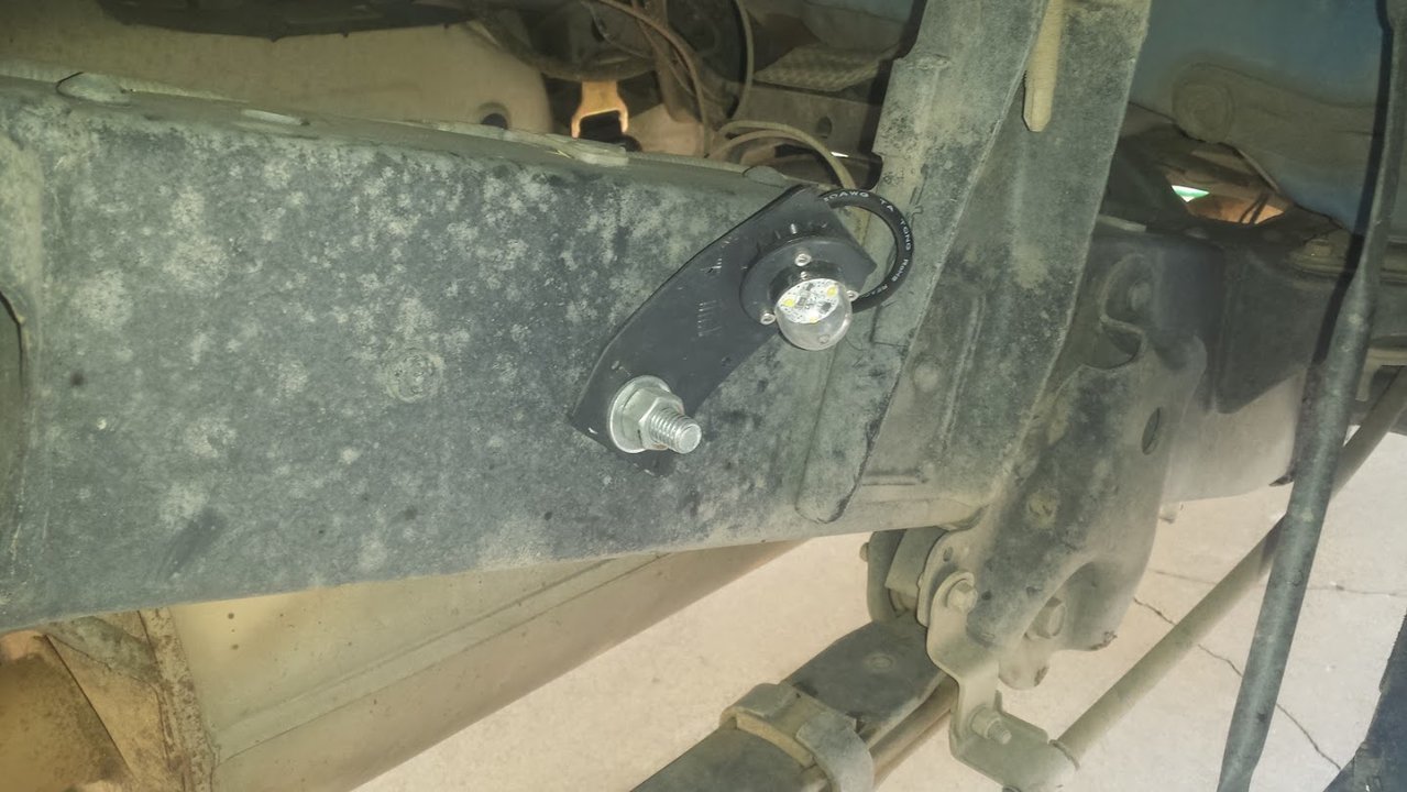

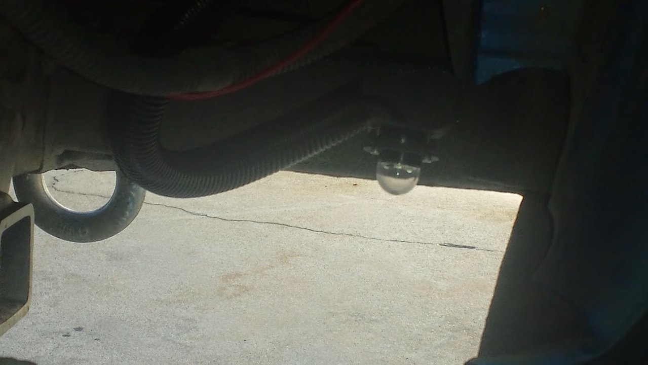

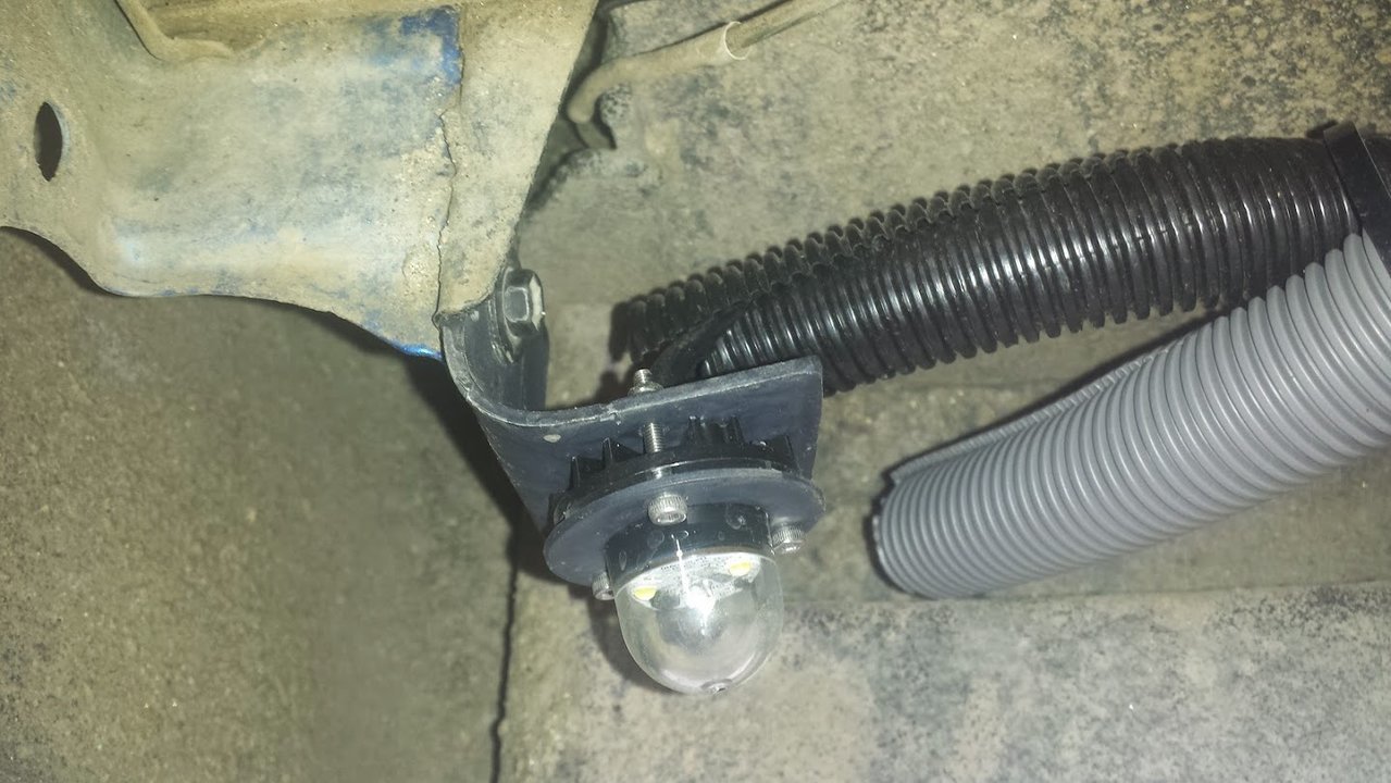

    I went to home depot and bought about 18 inch of fence post 12 gauge that had pre drill holes. I cut the pieces with my sawzal and then measure where to put my three holes to mount the lights on. Then i took the bracket and bent them in a vise or my case i clamped them to my trailer bent them. Most of the lights i used pre existing holes instead of drilling into the truck.
    here are pictures of the light in each position
    Driver side frame under my door
    Driver side rear
    driver side gas tank hose.
    passanger side rear
    passanger side under door.
    driver side in front of rear tire.

    Thanks for taking the time, I will try to follow your lead. You helped save me some time for sure!
