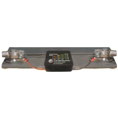

    That blue sea setup is nice and simple, but it has a pretty low amperage rating compared to some of the other options. The national luna is the most common one i've seen (and helped instal). it has a good capacity, and also has a monitoring display. sorta pricey though. talk to PSUtaco85 about his dualt setup though. i forget the name, but it functions in a similar fasion to the national luna. it doesn't have the in-cab monitoring, but can handle higher amperages, and costs about half if i remember correctly.
    that second link is just something you'd add to a battery, regardless of whether it's a dual setup or not. if you go with the national luna, it has those exact monitoring features built in.
