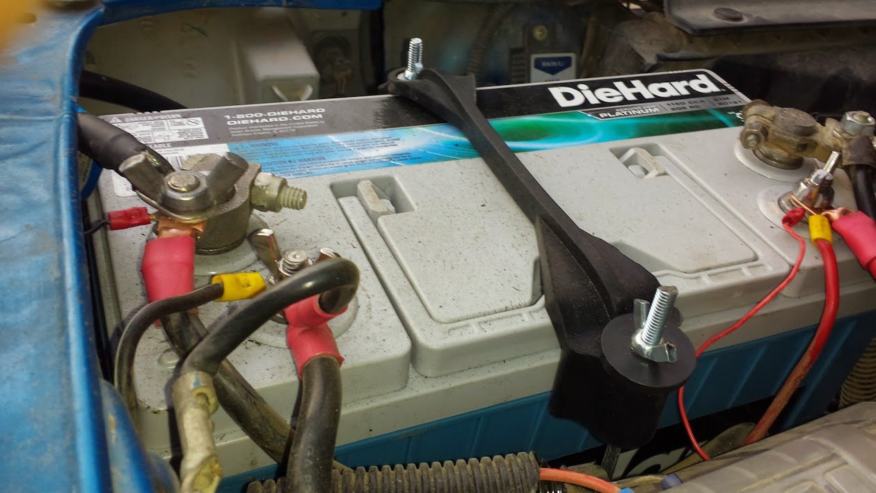

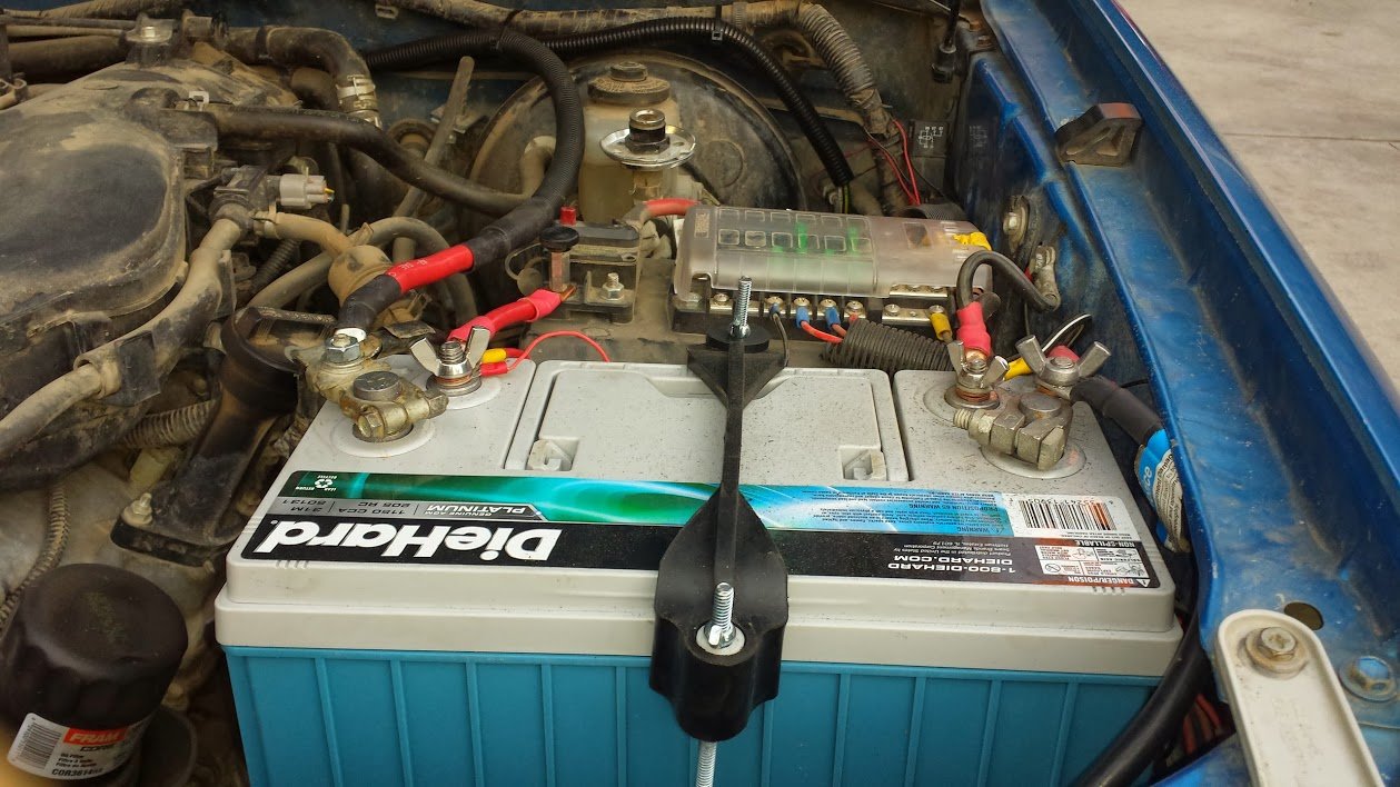

    Stuck this huge bastard in today. Need Tyler from Pelfrey to make me better battery mount.
    oxBfGauJiS0wbA_NEzVSc7QPwZ2mrAQLUfrH2fll_9c6852d4d9cd2743e06e0925a8a87789aee792dd.jpg

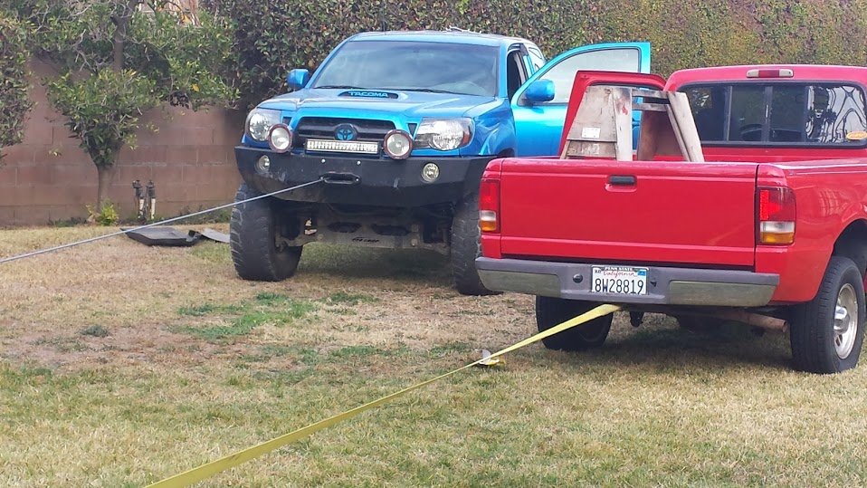

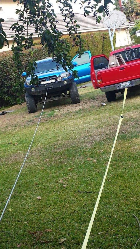

    Tested out the winch with new battery on sunday.
    M6kCipt_Y5SRjrQLupMODuW9NwBuFhEGr-MbV7Y__76fd69cd7e2ca45520d67a5902bdd34268a77211.jpg

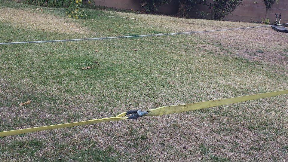

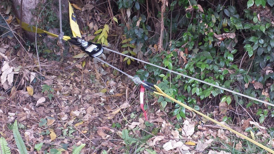

    Nice! Is that the best way to do it? With a pulley?

    When u use a pulley you have more pulling power.

    Only if the object being moved is tied to the pulley. In your photo assuming the red truck is anchored you are applying double the force to the tree, but both trucks see the same force just redirected through the pulley. If you want to slow the pull on your own truck you would attach the hook on the end of the winch line to your own recovery hook and use a line to connect the pulley (snatch block) to a big tree or something solid. This will then double the force and cut the net line speed in half, the drawback being you only have half the pull distance.

    Thanks for info man. Still learning how this crap works. But i figure do it in control situation before the real thing happens.
