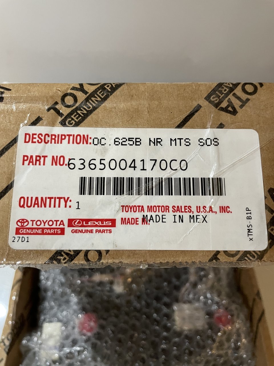

    EE7EE4F8-DF4D-41D9-BDB3-F3A3B9BDEF88.jpgThis is the part number that was for my truck.
    Was around $350. Purchased from rhymes with sharks. For some reason you can’t post the name of the place.

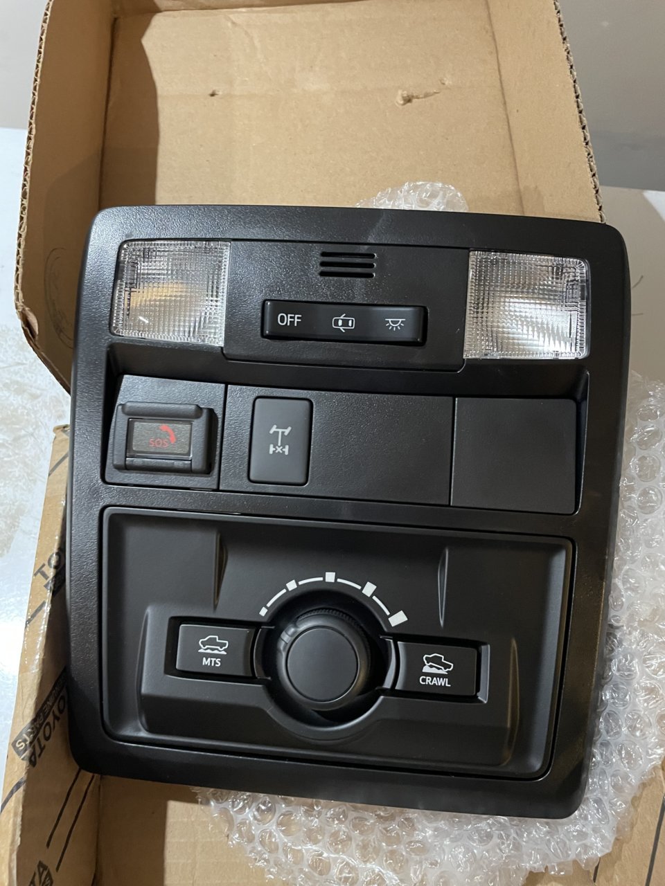

    E25BCED5-79C5-4D96-9622-3BB6786DF128.jpg This is a photo of the overhead console that I damaged.
