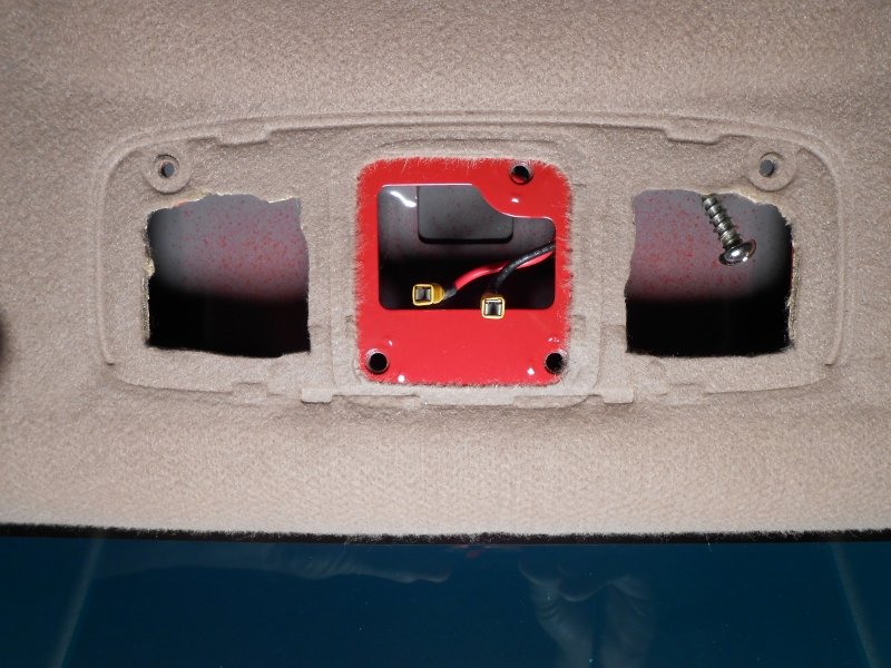

    Why yes, yes I did.
    Just pulled her off to get a pic for you. Na, just had to refresh my memory.
    The pic should tell all. I stuck one of the outer screws into the shot for reference. They are sheet metal while the 2 inner are machine thread.
    Also of note, the unit is grounded to the body by the screws. The 2 wires shown are fished from the regular dome lite. One is the "always hot" the other is switched from the doors.

    I did this and ran both wires to the dome light because in my extended cab I want both to light up the interior for getting in and out or letting people see with, its also great because when in the truck you can turn on left or right front lights or the rear dome by simply flipping the switch on the light you want.
    if like DP you don't want the fronts on with the door then the switch has a built in "off" switch so that feature is turned off.
    if you are going to do it IMHO its best to set it up so "everything" works then you have all the options there and if you ever sell the truck the next owner may have reservations about electrical things not working and no matter what you say its not going to sound good to say you went to all the trouble of installing the light but didn't hook everything up on it. if someone told "you" that, then i think you would have to have some reservations about what else wasn't done "as intended" electrically on the truck

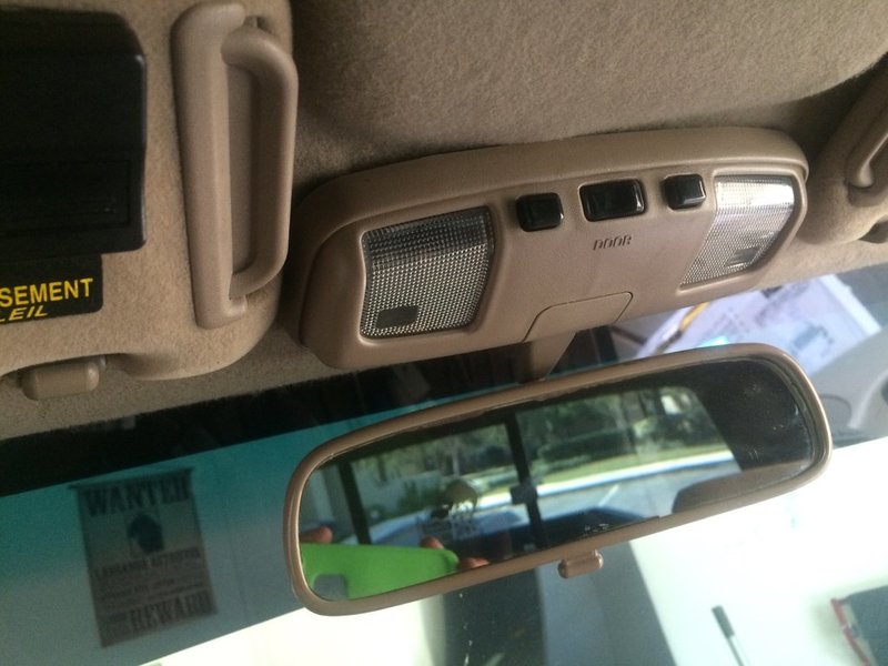

    Replaced my single map light with a 2000 4Runner dual map light and LED lights.
    Bolted and wired right up. Has the door and both light options,
    Replaced the stock mirror with a gentex mirror with compass, temp, auto dim.
    For the mirror power and temp sensor wire I ran the power wire down behind the right pillar to under the dash.
