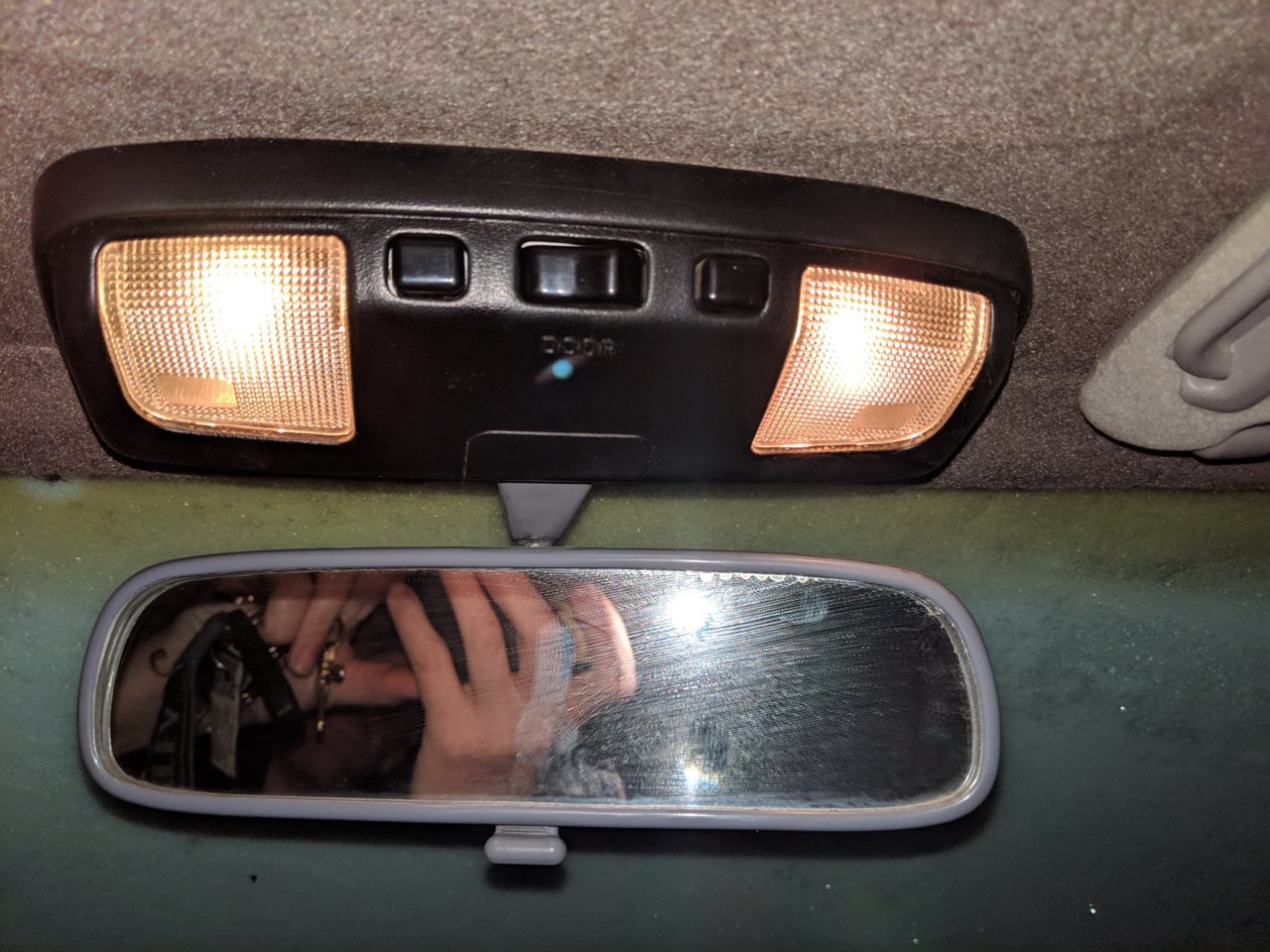

    I guess my next question is how to get them to turn on when the door switch is engaged. Then unit I’ve got only has one pin and no dome light to tie into. So I’ve got the ability to turn the lights on with each independent switch but not when the doors open. Any ideas?

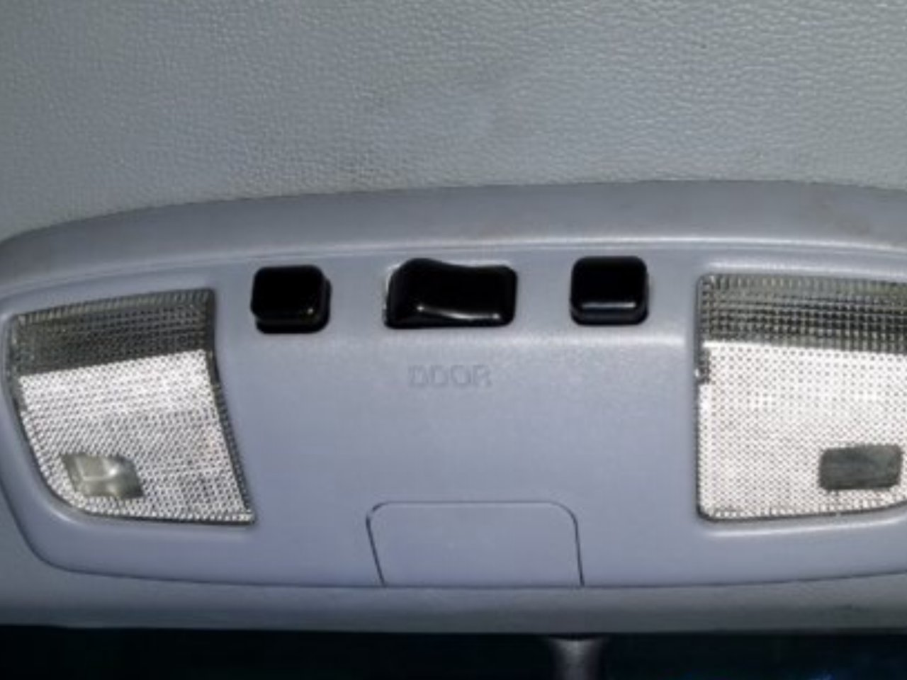

    Mine was plug and play and the lights turn on with the door. Maybe depending on the map light too.
    Not sure if that was an option or not.
    But my map light has a switch that says DOOR so you can have it working or not working with the door.
    I also replaced the oem lights with LED lights

    Yeah see mine doesn’t have the switch. It’s only got the two buttons.

    Yeah there are 2 different types. You can rewire the 2 button type to use 1 switch for the doors and 1 to turn the lights on and off.
