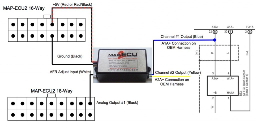

    Hey all, looking for some help. Have an email to the manufacturer with no response yet and for some reason I can't create an account for their forum.
    I plan on installing the MapEcu3 with AFR calibrator on my 2004 double cab 3.4l with Magnuson SC

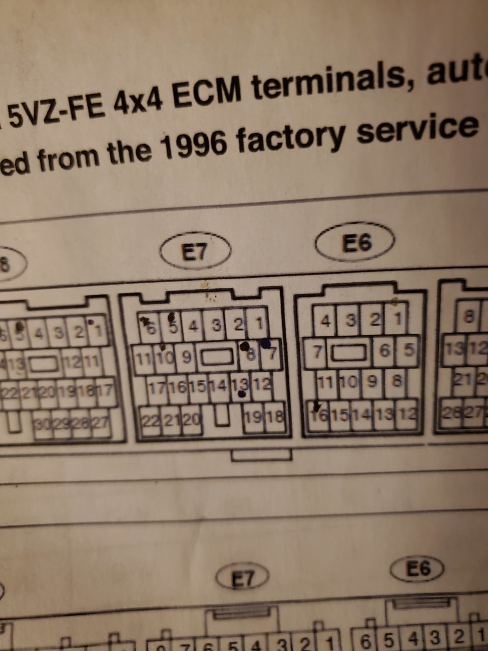

    Having a jumper harness made for the tuner and calibrator but waiting for confirmation on wiring the AFR calibrator. The wiring picture from their website differs slightly from what I was able to find from the FSM (for an '03)
    Basically trying to figure out what the A1A+ (blue) and A2A+ (yellow) is on the pin-out for the factory ecu. Closest I could find was AF1+
    Is this the correct connection? If so is the yellow wire for A2A+ omitted for the 5zvfe?
    Pictures included from manufacturer website and the referenced page of the FSM.

    Fwiw, I have a Fic6, on a 96 5vz, E7 pin 13 is used for afr input.
