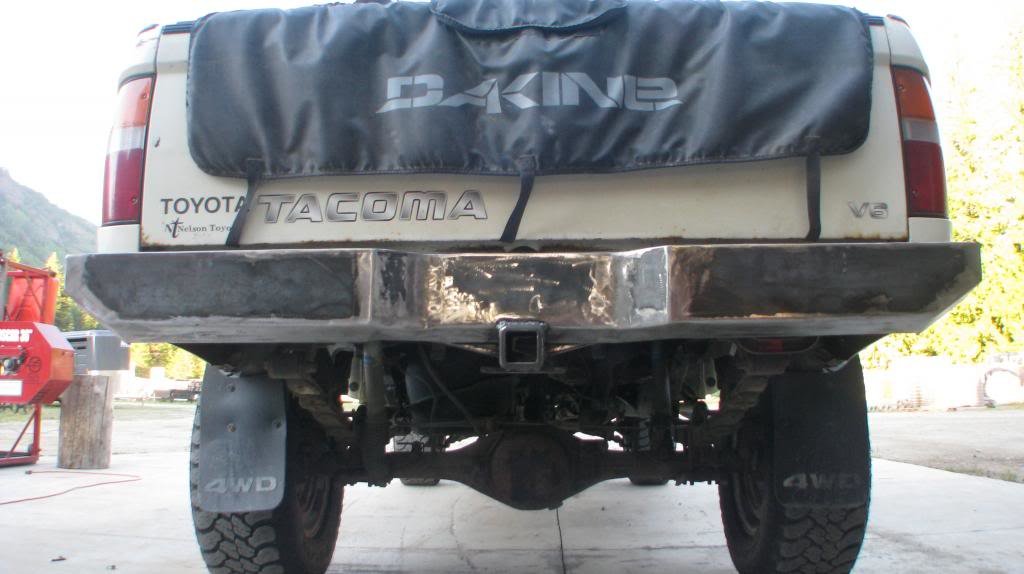

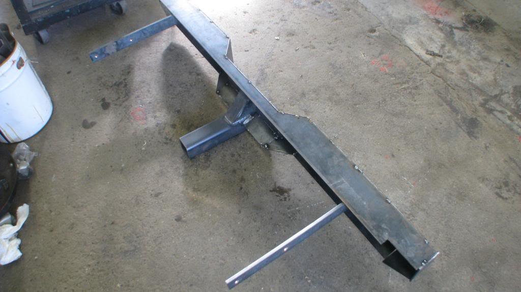

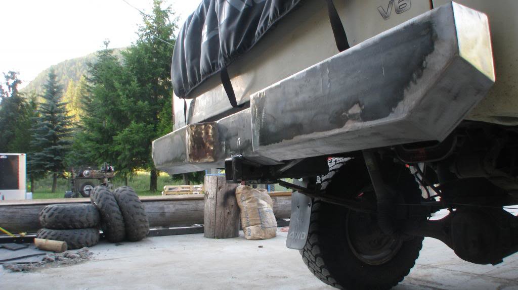

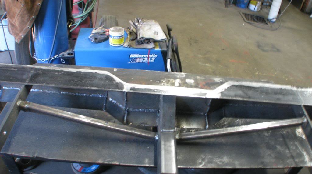

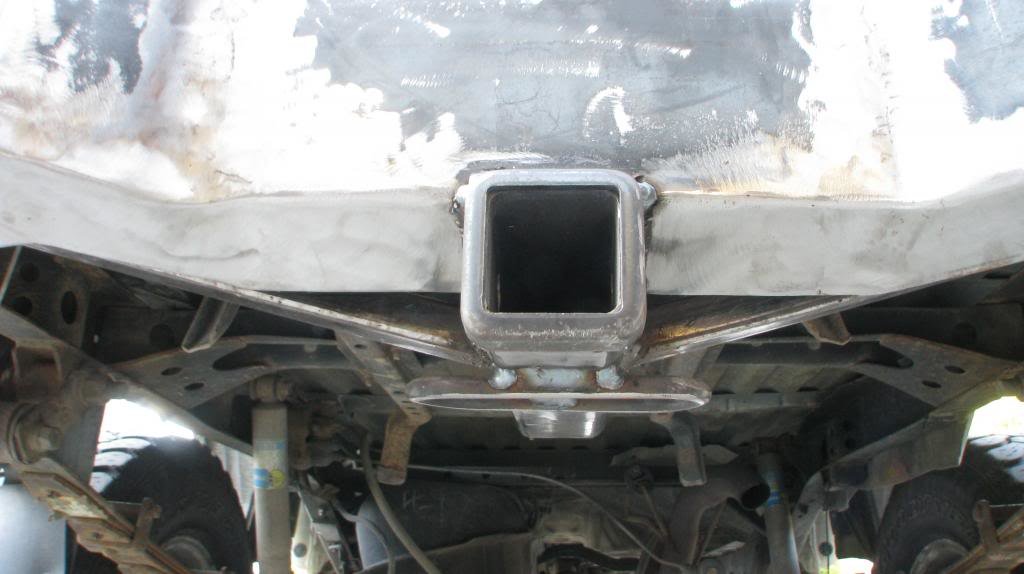

    Thanks man. It bolts on perfectly. I went with 2" Flat bar 3/8" thick and used the factory holes. You think 4 points will be strong enough? I also added 1" sq tub supports that go from the frame plates to the hitch

    Yeah should be good, my old hitch had 4 bolts. What are you hauling? If its not too heavy, I don't see a problem.
    If in doubt, add a couple gussets

    thanks man, i love fabbing with steel so easy! I wanted to leave room for my license plate since its only 5" plate
    I wont be hauling anything bigger than single axle 3000 lbs. So 300 lbs will be the max tongue weight it will see. Once bigger tires and armor go on, there isnt much power left to pull a tandem trailer. Plus i would have to wire in a 7 way plug and brake controller.

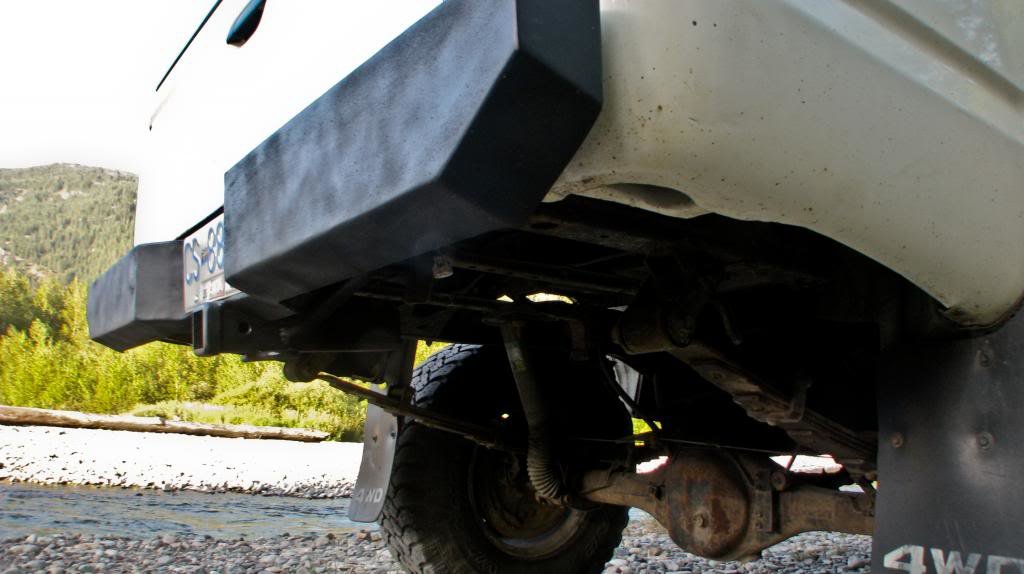

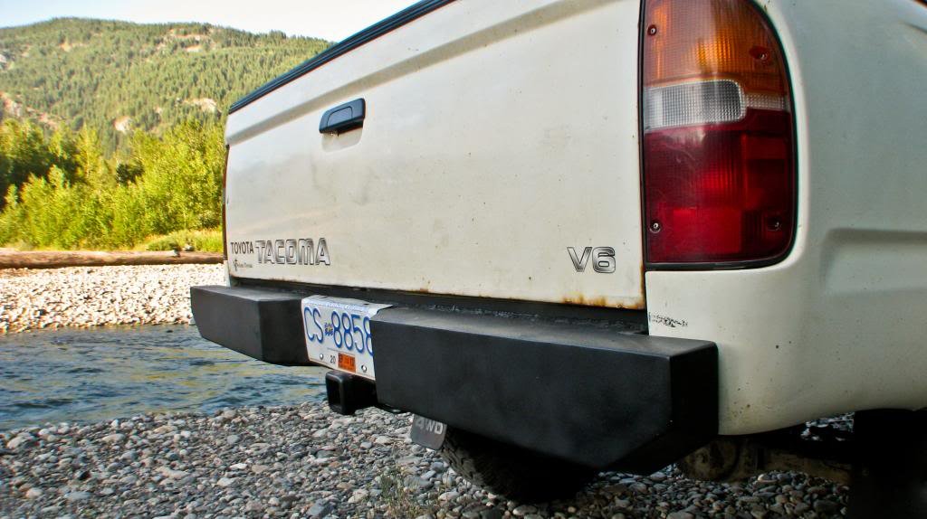

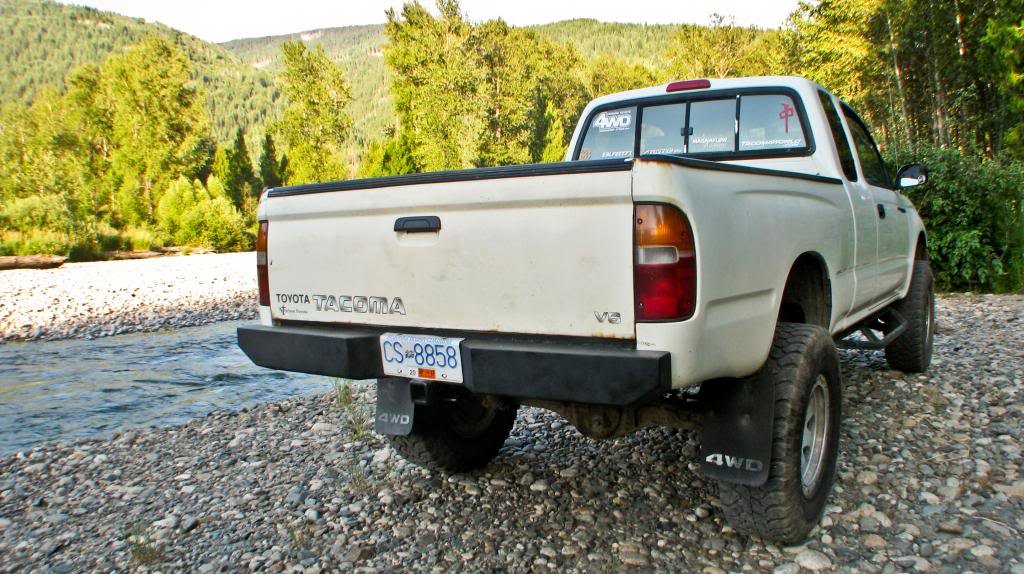

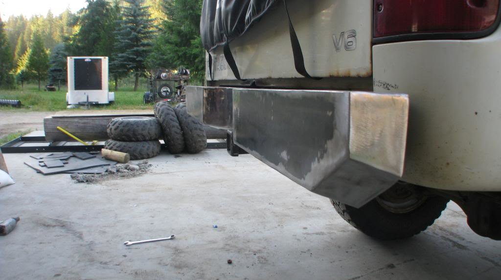

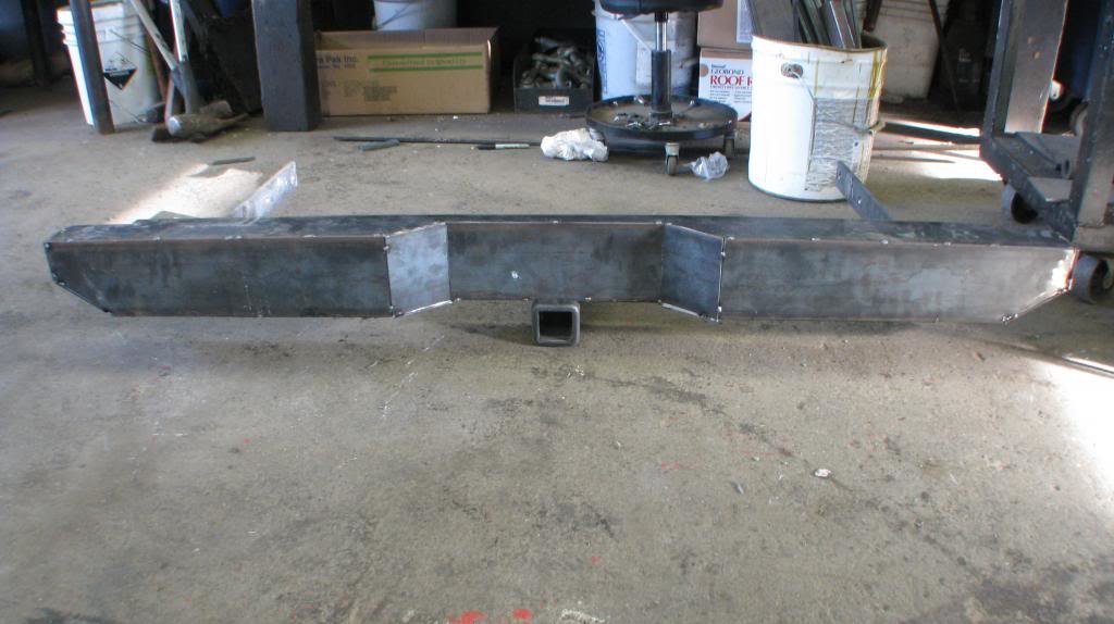

    Finished up the plate bumper today. Couple coats of primer and couple coats of Black Paint. Pretty happy with it overall.
    Specs:
    3/16" Plate steel for the main body
    1/2" x 2" Flat Bar for the frame mount
    1"x1" 3/16" Square tubing for the hitch supports
    1/4" Hitch tubing
    Couple thing i want to add:
    LED License plate light
    Recovery Points (Although i can use the hitch shackle)
    Bedside protection
    Tire swing mount
