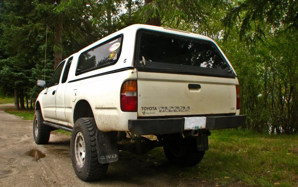

    Really like the bumper! This is exactly what I've been looking for but no one makes a plate bumper that I like. I'm wanting to build my own as well. What did the materials cost you, if you don't mind me asking? Materials for bumper build only, not hitch. Thanks

    Thanks! Not sure exactly as i got it all from my work at cost. Ill say about $100 maybe more

    awesome bumper build! I still don't know how I want mine to look

    Its a little bit heavier than my stock bumper. Not as heavy as i would have thought

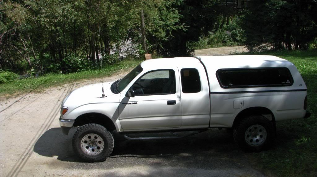

    Moving out of my place and out of town. Threw on the canopy to get it to the new place

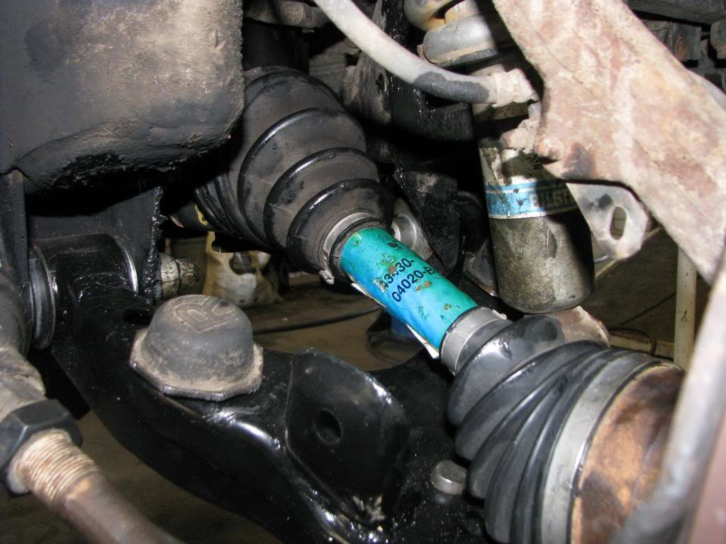

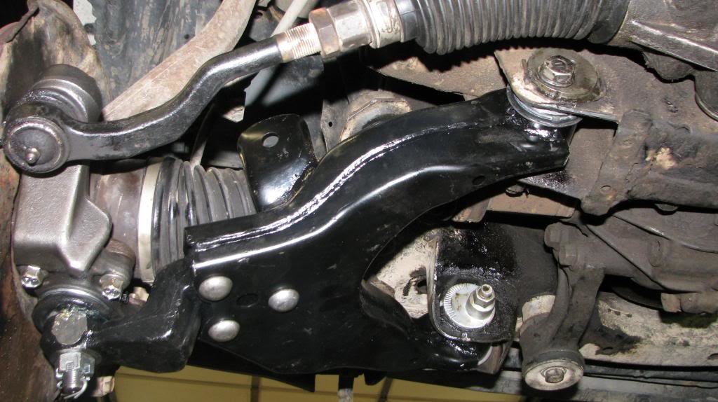

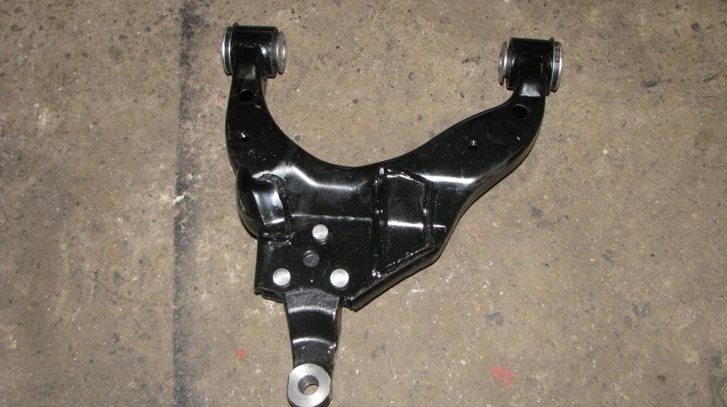

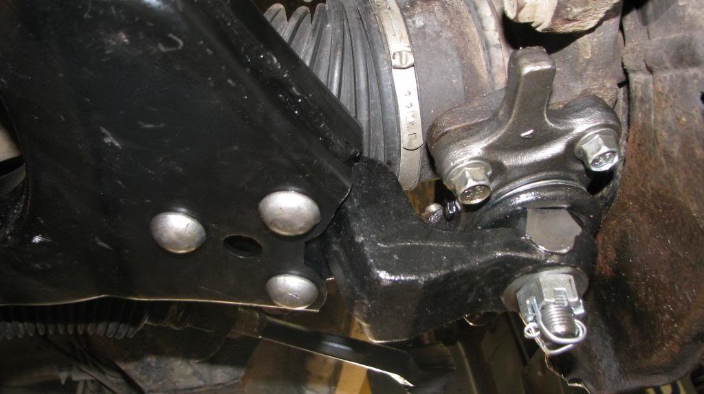

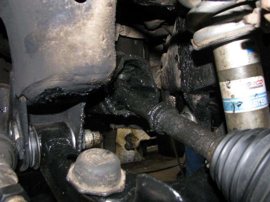

    New LCA, LBJ and coil top plates

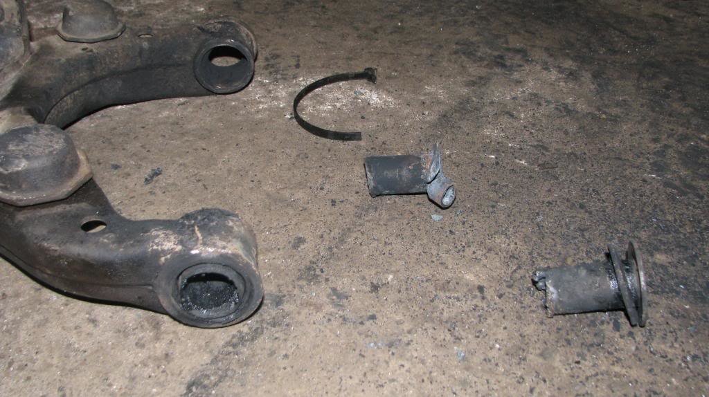

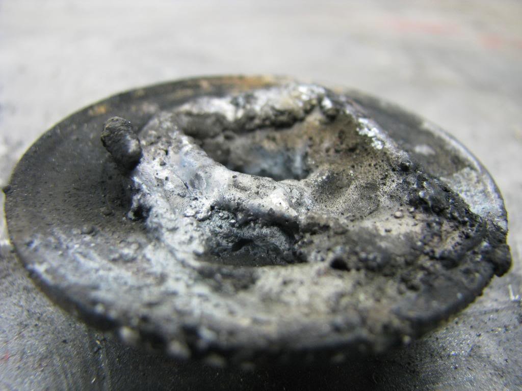

    Torched out the passenger LCA
    New LCA and LBJ

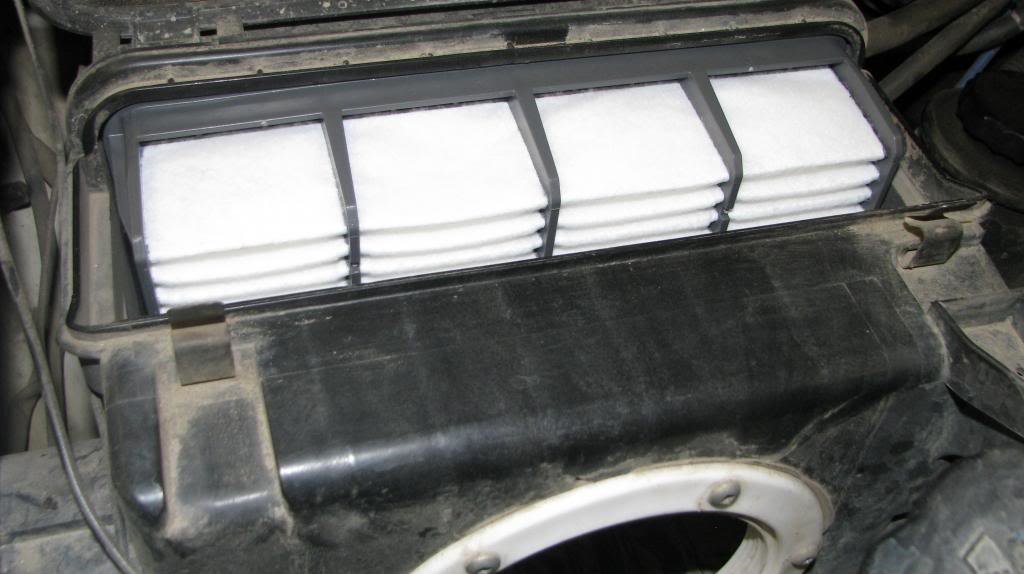

    Then spoiled her with a Toyota Air Filter :D

    I'm curious to why you had to replace the LCA...I seem to notice a constant looseness in my front suspension but I always chock it up to it just being a IFS thing.
  10. Sep 12, 2013 at 11:19 AM
    #230
    MapleMoose
    MapleMoose [OP] Drunk Canadian
    Feb 15, 2011
    #51211
    8,575
    Ian
    West Kootenays
    1996 Tacoma SR5
    3" Eibach Coils, 3" AP Springs, AP 6" Shackles Toytec Diff drop, BAMF Sliders, Deck plate mod,Volt meter, Highbeam mod, PIAA fogs, 18" Magnaflow, LED dash swap, Color matched Satoshi Grille, Custom Rear Plate Bumper
    Well last month i went in for an alignment and he said he couldnt align the cambar and caster because my LCA bushings were toast. Whenever i stepped on the brake the truck would pull to the left pretty hard. I thought it was just a rotor issue but it wasnt.
    I go quoted something like 7-8 hours plus bushings cost for the job. I said fuck it and ordered new LCAs for $100 each of RockAuto. But little did i know the passenger side cam sleeves were seized into the bushings. So i had to torch them out and order new sleeves from toyota. $27 each.
    So instead of $8-900 at a shop to just get new bushings pressed in, i spent $255 for new LCAs and new cam sleeves. It was a bitch forsure, but worth it in the end.

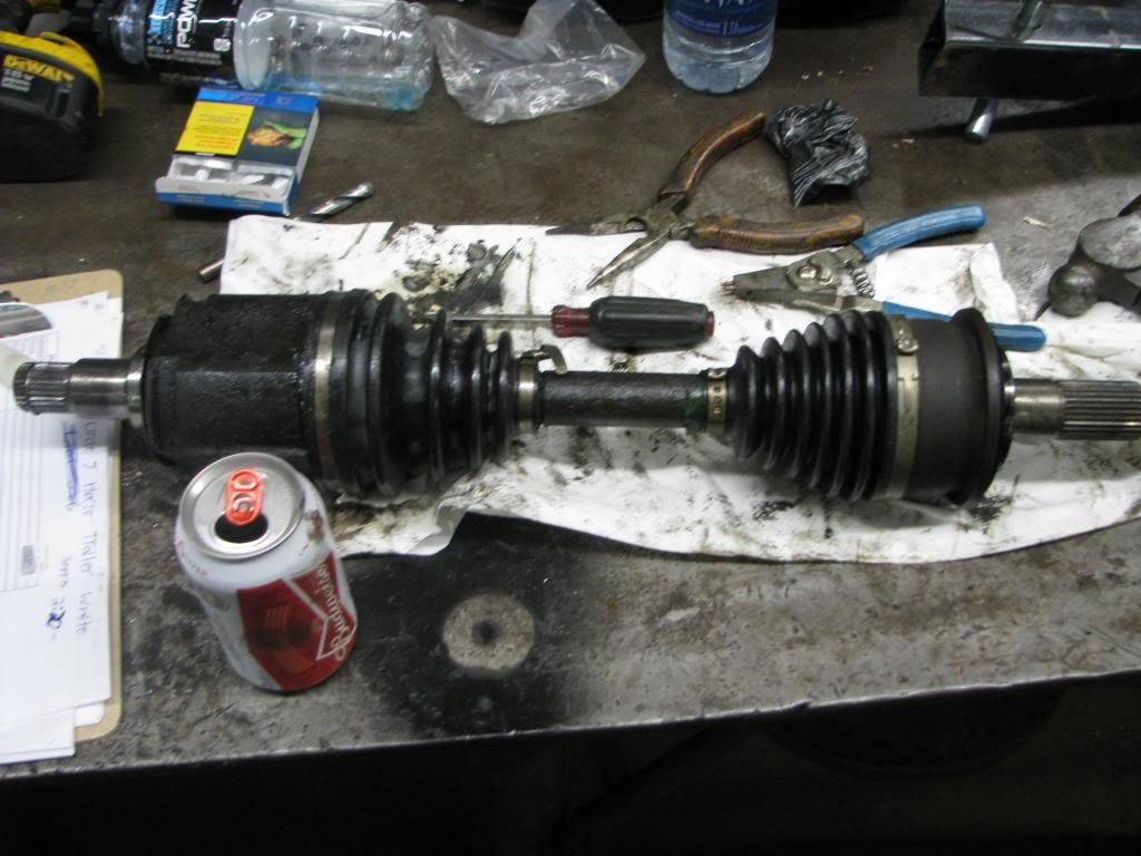

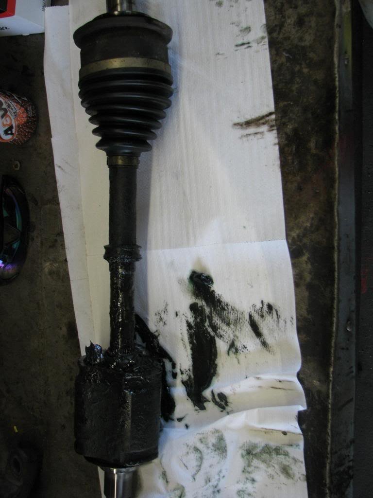

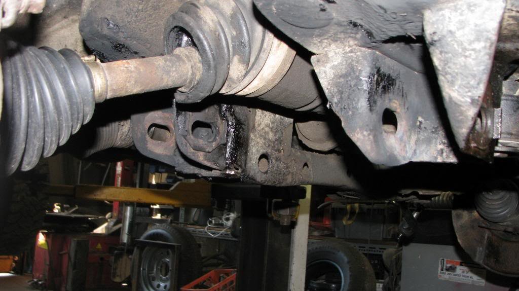

    CV boot was fucked so i ripped it off and got a used axle from the wreckers.
    Decided to attempt a boot change. After about an hour of sheer frustration, anger, and lots of beer i got it changed

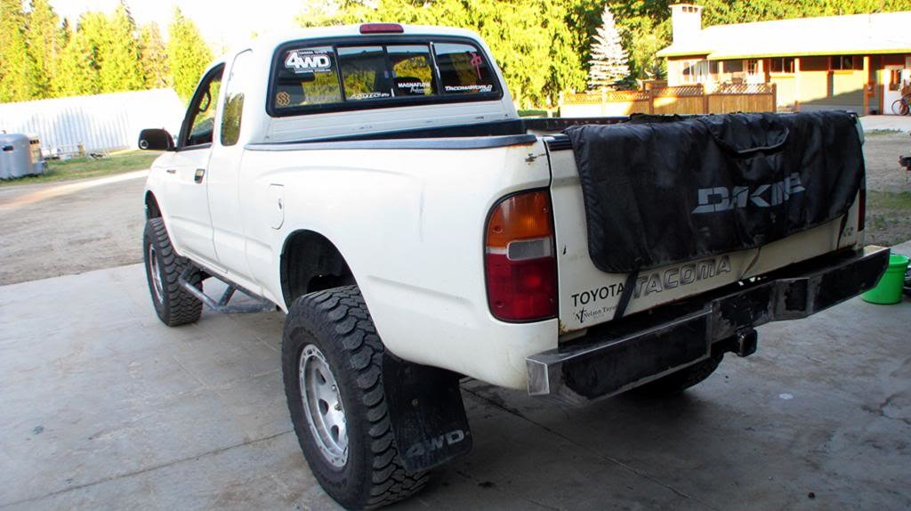

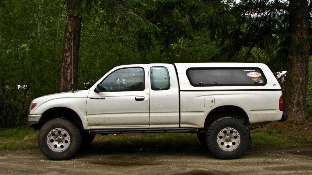

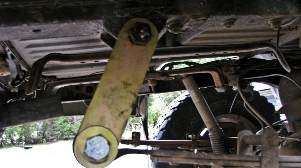

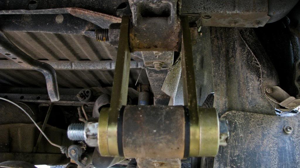

    Installed some All Pro 6" shackles last night. Really like the new stance. Gave me another 1" of lift in the rear
    New stance
    All Pro sent me the wrong kit, but i made it work for now
    Also got new RainX wipers

    Beautiful pictures. I like the new stance. Let me know how your droop improves with your new shackles.
