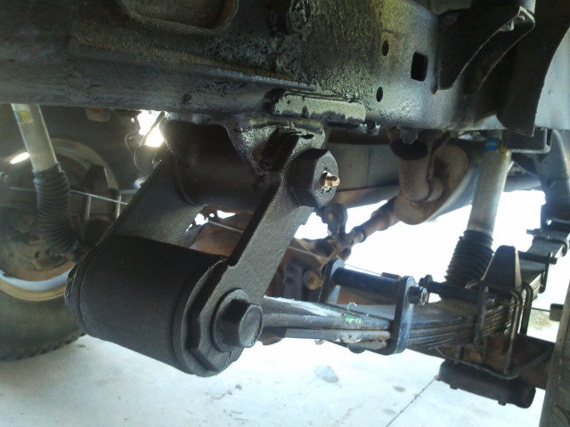

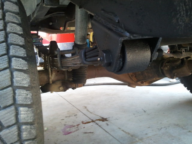

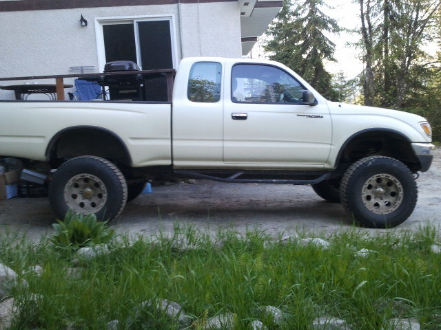

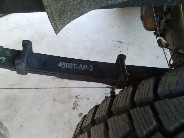

    All Pro 3" Standard Duty springs installed.
    New stance without blocks!

    ARB Safari snorkel, snug top, snug rug, yakima rack bars, ARB front bumper, plasti-dip camper shell windows, sway bar removal, turn signal reposition, led dome lights, recon smoke roof cab lights, 8000k xenon HIDs, 5100 Billy coilovers and rear shocks, tundra leafs, 3 inch lift rear shackles, 315/75-16 Bfg km2, 16"/8" Eagle Alloy 100 series black wheels, grey wire mod, deckplate mod, diff breather mod, Rola roof rack with tire carrier, trimmed front and rear fenders
    what backspace are you running?

    On the 16x8 eagle alloys was 4.5" BSing. The 285/75/16 tires that i recently sold were rubbing at full lock. I will be keeping my 265/75/16 winters on them and getting 33x12.5/15 MT's on 15x8 steelies with 3.75 BSing. I have already tested them and they dont rub at full lock.
    Eventually i will. Once i box the frame i will be putting a crossmember in there too so i can mount the shocks like this \/

    How hard was it to get those hangers on right? I just got my all pro springs in and I was wondering if you just chopped your hangers and rewelded or if you bought some new ones to put on
  17. Aug 15, 2012 at 1:26 AM
    #137
    01Tac0ma
    01Tac0ma Bash Fabriction & Off-Road
    Jun 11, 2010
    #38782
    6,304
    Chad
    West Columbia, SC
    SAS 01 TRD 4x4
    Look at build!
    Not to post for him but i would go ahead and get new spring hangers. If i had to cut mind id get the trailgear creeper joint hangers. Plus im sure after you cut
    /torch the factory hangers they wont be worth trying to save a reweld back on
  18. Aug 15, 2012 at 9:34 AM
    #138
    MapleMoose
    MapleMoose [OP] Drunk Canadian
    Feb 15, 2011
    #51211
    8,575
    Ian
    West Kootenays
    1996 Tacoma SR5
    3" Eibach Coils, 3" AP Springs, AP 6" Shackles Toytec Diff drop, BAMF Sliders, Deck plate mod,Volt meter, Highbeam mod, PIAA fogs, 18" Magnaflow, LED dash swap, Color matched Satoshi Grille, Custom Rear Plate Bumper
    I didnt do the install. I had a shop cut off the old hangers and re-weld the new ones. The Toyota hangers are very dinky so i would not use them again. I went with TG leaf spring hangers front and rear.
    Also the hangers need to be relocated. The All Pro springs are 3" longer than our 95-97 Tacoma springs. I believe its 2" forward and 1" back but not forsure. You can take a look at All Pro website for the details on that.
    Its a big job. And the measurements need to be pretty accurate.
