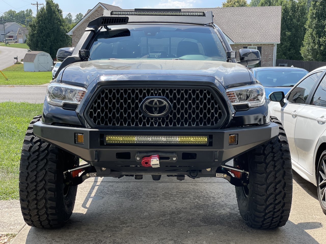

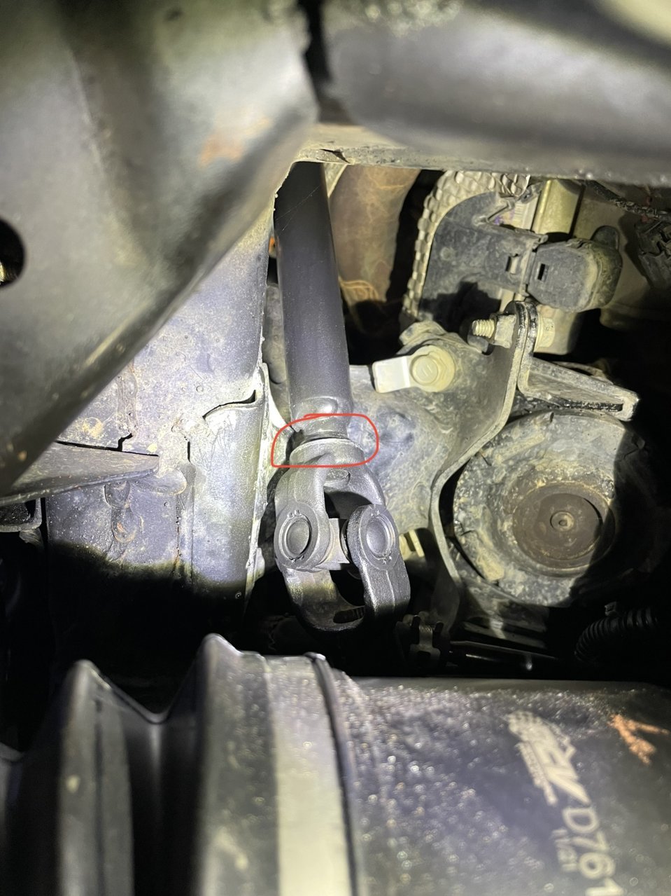

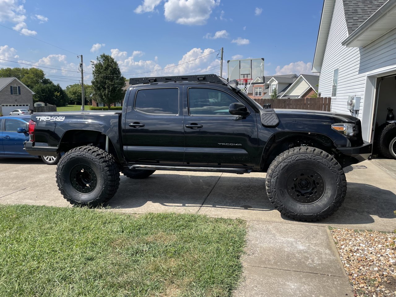

    I have just finished putting all the RCLT together on my truck and am having the heavy steering and the steering does not right itself like you previously posted. I have found that that there is slight rubbing of the shaft on the engine mount. In the attached pic it is circled in red. The dust on the CV is what came off of the contact area when I touched it. It is very minimal but do you think this is enough to cause the same issues yours had? Thanks for your time. I’ve attached pics of the truck in case you are interested in seeing it. Not nearly as cool as yours tho.

    Hello @Tacoma1192 and thanks again for doing the write-up! To share details here, Tacoma1192 measured that +2.75" RCLT HD is capable of 12.5" of suspension travel, and when installing RCLT HD in the up-travel limited configuration (the easiest and least labor intensive method), it achieves 8.75" of travel when using the factory Toyota bump stop. This, however, is an incorrect measurement because the kit includes a replacement Low Profile Bump Stop which when used calculates the travel to be very close to 11". For details on this, please see my reply here.
    The Results!
    RCLT HD +2.75" in limited mode install:
    Hub Travel: 10.98" & Tire Centerline Travel: 11.5 to 12"
    RCLT HD +2.75" in full-capacity mode install:
    Hub Travel: 12.50" & Tire Centerline Travel: 13.5 to 14"
    The info is really great to have and we thank Tacoma1192 for the effort in measuring and typing up the report! We added this info to our FAQ under a new "Suspension Travel" section located here.
    Hello JC, thanks for posting up! Great look'n rig!! I am going to add it to our Media section if that's okay! Last month I replied to the email you sent our sales team, have you seen it yet, and more importantly, have you seen the Owners Club thread on this subject, Steering Sector Shaft Clearance Notes and Tips?
    This video was made for another customer but it shows the steering power and smoothness of RCLT HD + 40" tires. This is the expected outcome of an RCLT HD install:
    https://www.youtube.com/watch?v=fhDgCJhRJM8
    Definitely make sure you have air gaps around the steering shaft
    https://www.youtube.com/watch?v=Uzsb0CWiTbE
    Here is an example of heavy steering:
    https://www.youtube.com/watch?v=c7iuuIV7va4
    ...which was a result of metal-on-metal contact
    Hopefully you get it handled soon so you can get back out and enjoy that beaut of a Taco!

    Sorry for the slow reply, but I was out of town. Yes that will cause the same steering issue. Hope you got it cleared up!
