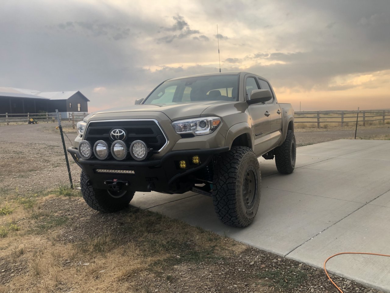

    I am southern Idaho and A full desert long travel does not meet my needs. I wanted the RCLT, but gave up and went the TC +2 expedition. ARB’s front and rear this has been great on my rough and steep roads for the mountain area I travel and sufficient for the desert runs that take me there. Would have loved to go 37’s as claimed by MC, but stuck with 35’s. The rear is a SUA with relocated shock mounts and so far looking like will need to upgrade to a bed saver cage, but the rest has been perfect for my trails. Fiberglass will not survive on my roads and it is in for a vinyl camo wrap now. This thread is exactly what I want to hear discussed. Would be cool to run the places you guys do, but not what we have here and the RCLT should have met the need.

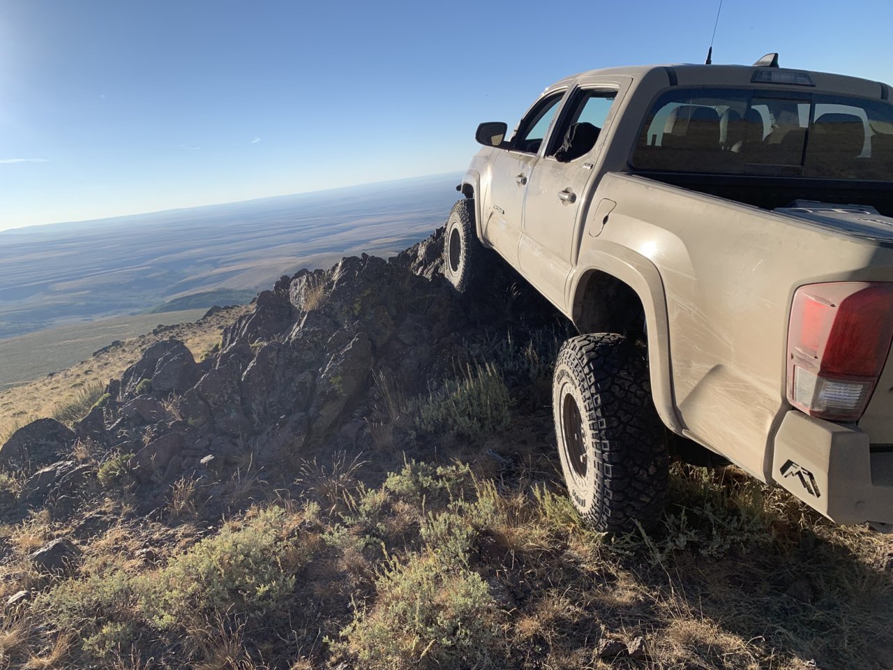

    365D4FE4-8794-4D4D-B14D-12E67A466830.jpg C5435F1F-552E-4E74-BB1F-D4D0670A1B7E.jpg Agreed. Wife demanded mountain smooth if modifying as much as we were and I need it to take me where she won’t want to go smooth or not.
    Just wish MC wasn’t so unreliable, wanted a taco box as well, but will have to go atlas or wait for someone else to make something similar. Atlas is a bit overkill for me.
    Camo wrap will look good and save it a little.
