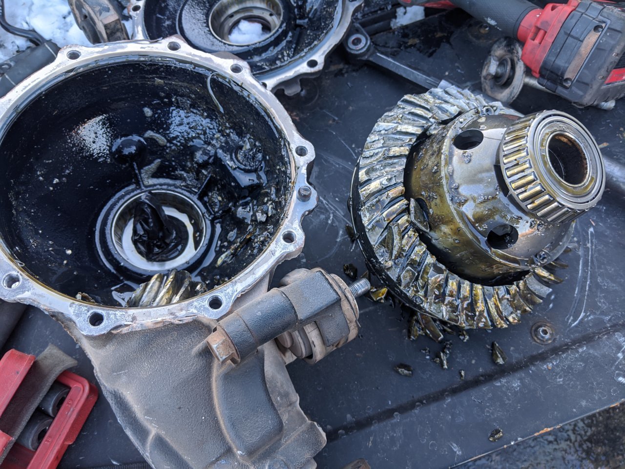

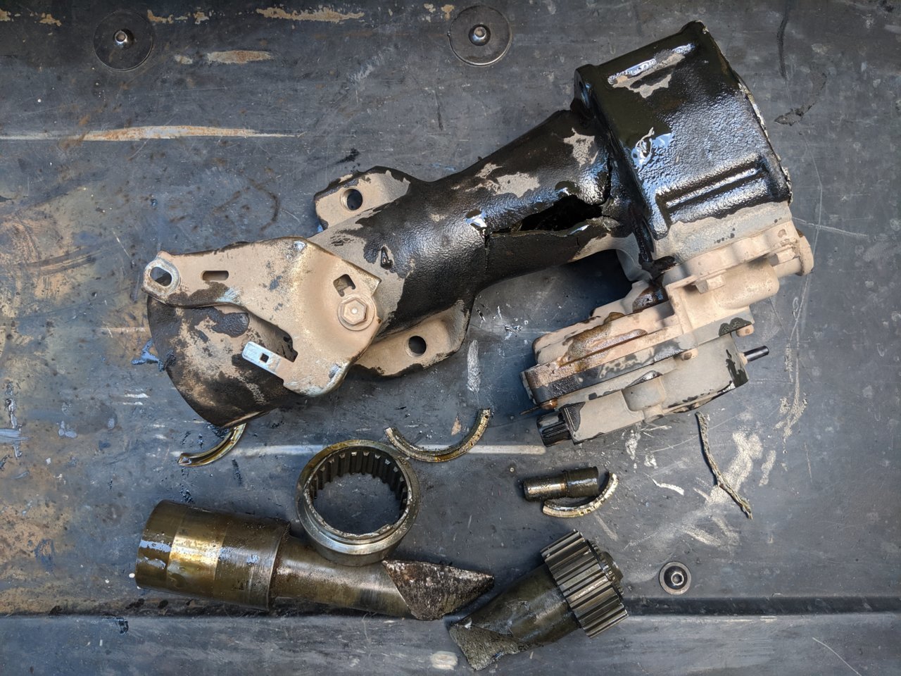

    I've got them, and I actually get out and use my truck a lot so I can actually speak from experience.
    They are a complete waste of money. For the price of RCVs I can buy 20+ junk yard OEM CVs or make 6 long travel CVs assemblies. This might vary depending on you location, but where I live in Socal I can get junk yard OEM CVs for $75.
    On top of that, the boots on them suck absolute ass and require their in-house grease if you try to pursue a warranty replacement....and it costs $50+ dollars to get the grease to your door. So every time a boot gets damaged and has to be replaced you get to waste money on their own in-house grease as well as the cost of the boot. So if you lose a boot it could easily run you $50+ dollars every time..in the year I was running them I think I replaced 4 or 5 boots for various reasons. The first set was their own in house boots which fucking suck. Did a short 70mile trip with some go fast and rock crawling and 3 out of the 4 boots that they came with ripped open before I aired up at the end of the day. I ended up getting a different brand boot that runs about $15-20 depending on the exchange rate.
    They also claim they get better articulation but on the outers, they don't. Since the outer joint has to have the same size OD on the cup they couldnt really make it larger to make it any stronger.... One of the things they did do was make the shaft bigger, which when they did that actually causes the shaft to hit the cup on the birfield side when articulated.
    They also end up causing this if you shock load the front end with them installed. If you think running RCVs will allow you to beat your drive train up, think again.
    If I can run Rubicon, Kane Creek, Cliffhanger, Pritchett canyon and more on 40s with beat to shit OEM joint CVs, there no need for RCVs.
