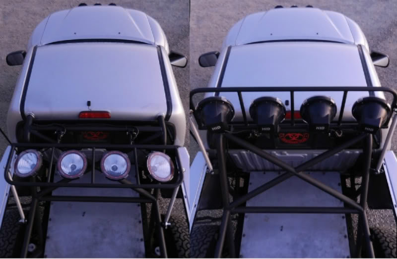

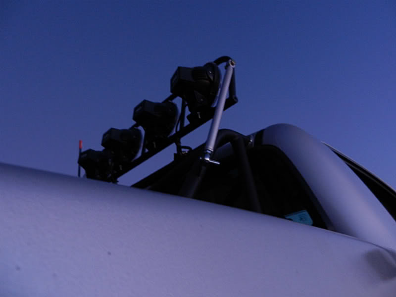

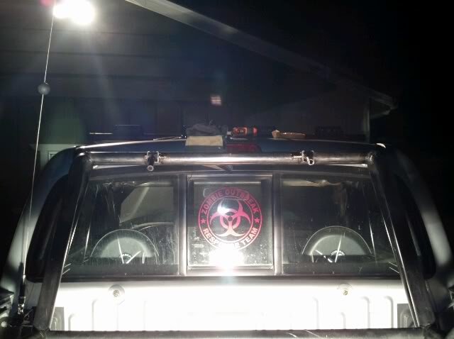

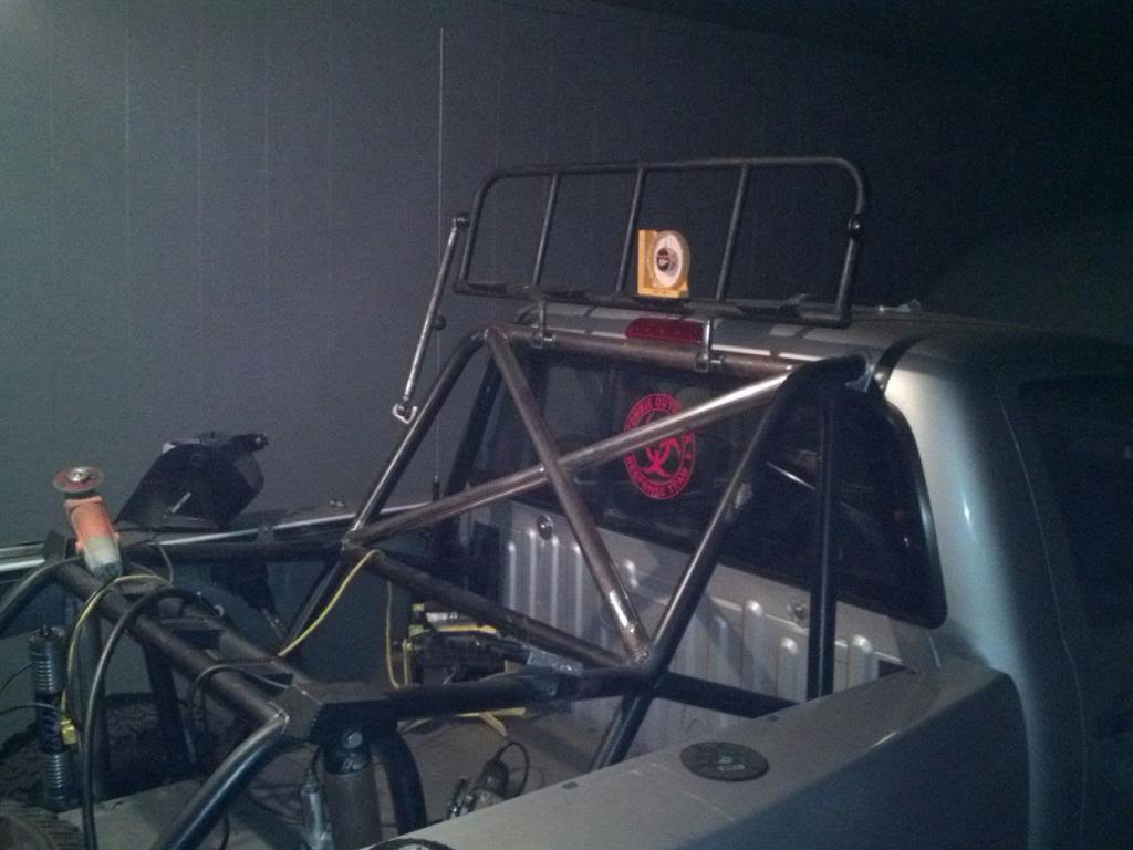

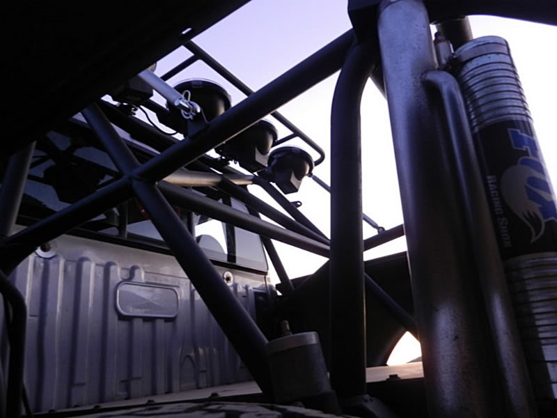

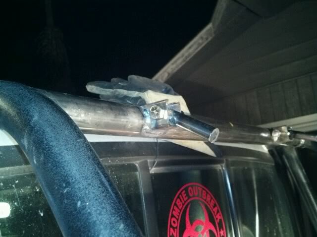

    Update:
    Not completely done yet so these are just "teaser" pics. Things are all coming together at B.A.M.F.

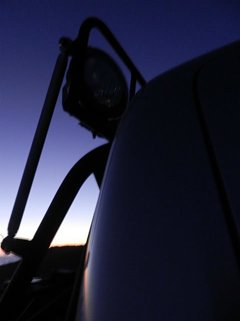

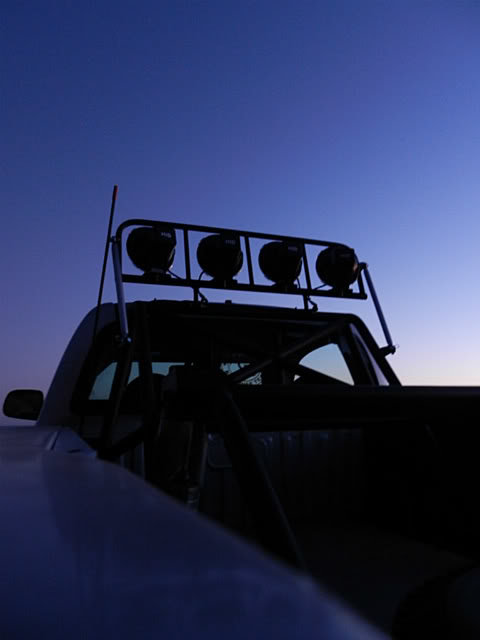

    I now have a cross brace on the cage which was Fabien's original intention to complete. I also have the light rack mounted.
    If all goes well tomorrow at the Mini mod day, I should have the lights installed in the rack and ready to go for Pismo!
    The bolts are 1/2" grade 8 bolts and the up tubes are 3/4" .120 wall DOM :D and the mounting brackets are 1.5" .120 square tube notched to fit the 3/4" DOM.
    In other words: This bitch ain't breaking.

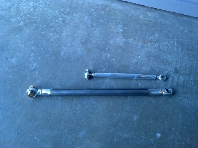

    Jerry made this beefier heim joint and rod. Mine is the wimpy one. :( I think I like Jerry's more. "That's what she said."
    Sporting the "Z.O.R.T." sticker.

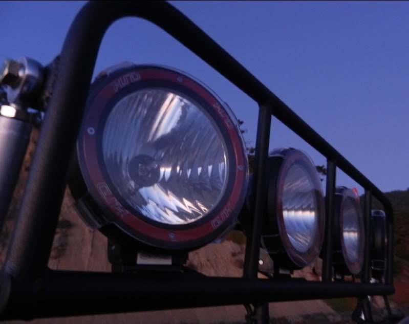

    And light rack to hold 4 HIDs which are intended to help keep me from falling into ditches at night... :(
    More pics to follow after the cage is painted and the lights installed. Jerry is blowing up my phone with updates as I write this. lol cage is already primed. :D

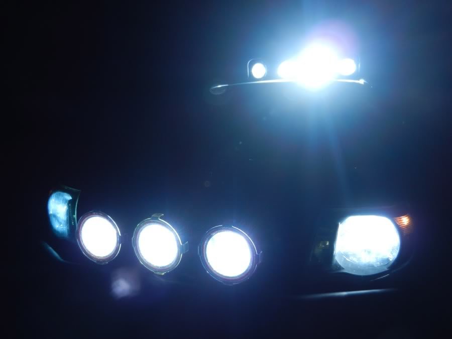

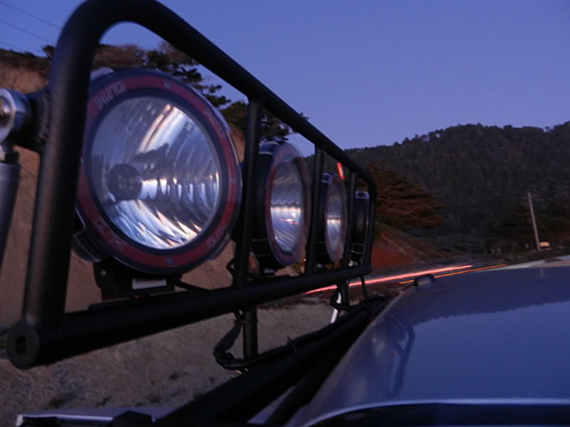

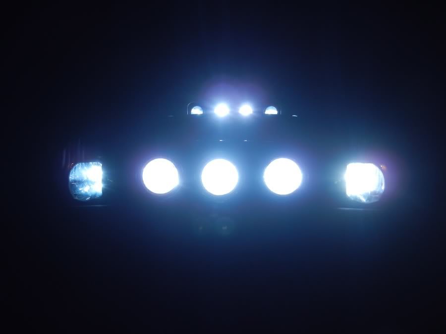

    Lighting!
