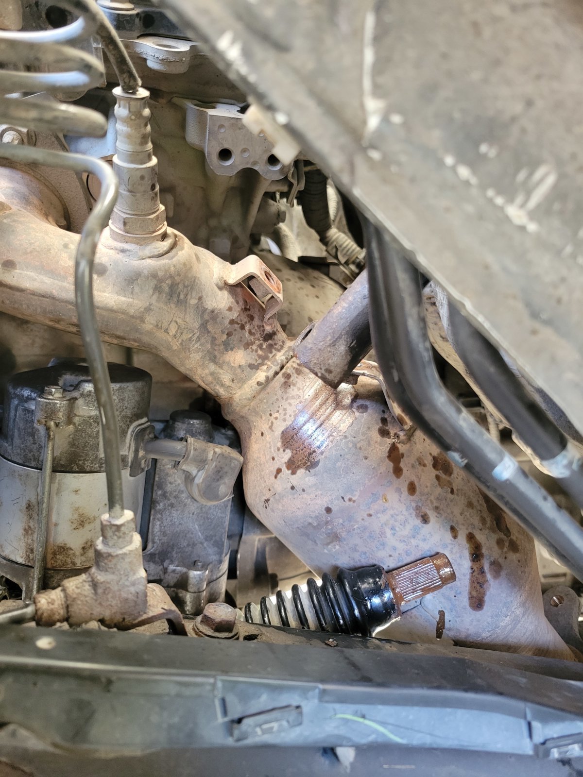

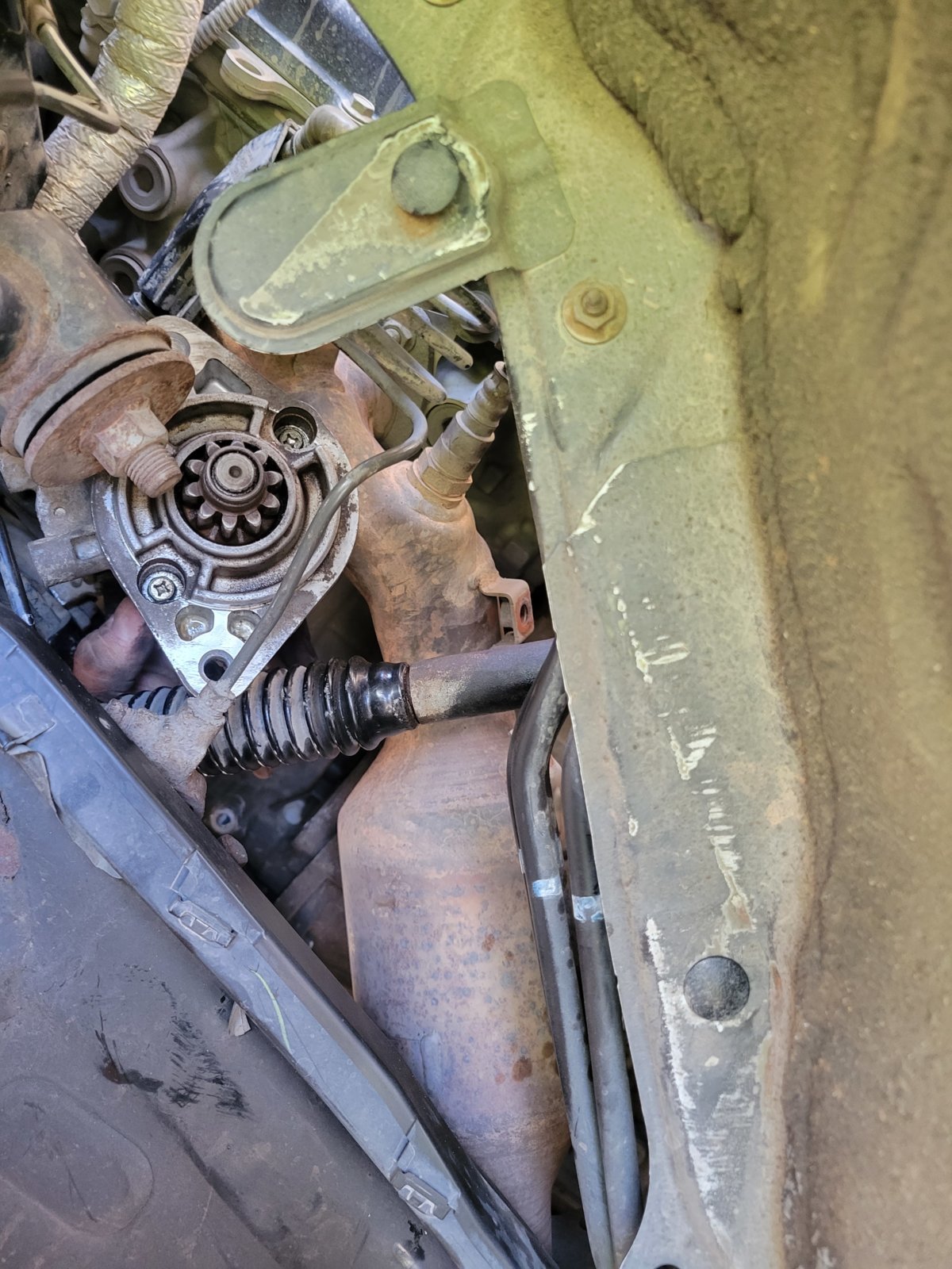

    I took a few mins and came back got it unstuck from where it was, which is great! Problem is this is as far out as I can get it. The steering column yoke doesn't want to slide at all so I can't disconnect it and move it out of the way.
    Whoever designed this should be clubbed.

    I hit it with WD40 and whacked it a few times with a hammer to try and loosen her up. No dice so far...

    Update: yoke disconnected!

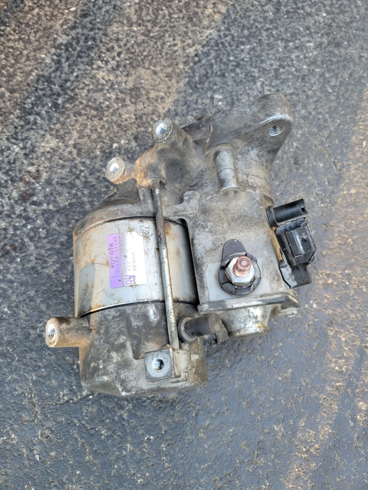

    Update, with a message to the 2016 Toyota Tacoma engineering design team:

    Anyone have an extra starter laying around? Advance won't get mine in until yhe 31st

    About 140k, mostly above water. When I went to AOAA for the takeover a couple weeks back, one puddle turned out to be significantly deeper than anticipated, water came up to just about the top of my 31" tires, so I'm pretty sure water got into my starter through the breathers

    Yeah, I suppose that would also explain the sticky yoke. I got creative with a few wrenches and a screw driver to get it off. Of course, the WD40 and my persuader certainly helped haha.
    I do have the old carcass so I can get thay core charge discount from trade in.
    Yeah, I'm trying to find an OEM, Advance ordered one from some manufacturer called Carquest, apparently it's their supplier or whatever. I may call my local dealerships in the morning to see if they have any actual OEM in stock, and how soon they'd be able to get one in. I don't want to have to use my roomie's car for a week and a half.
