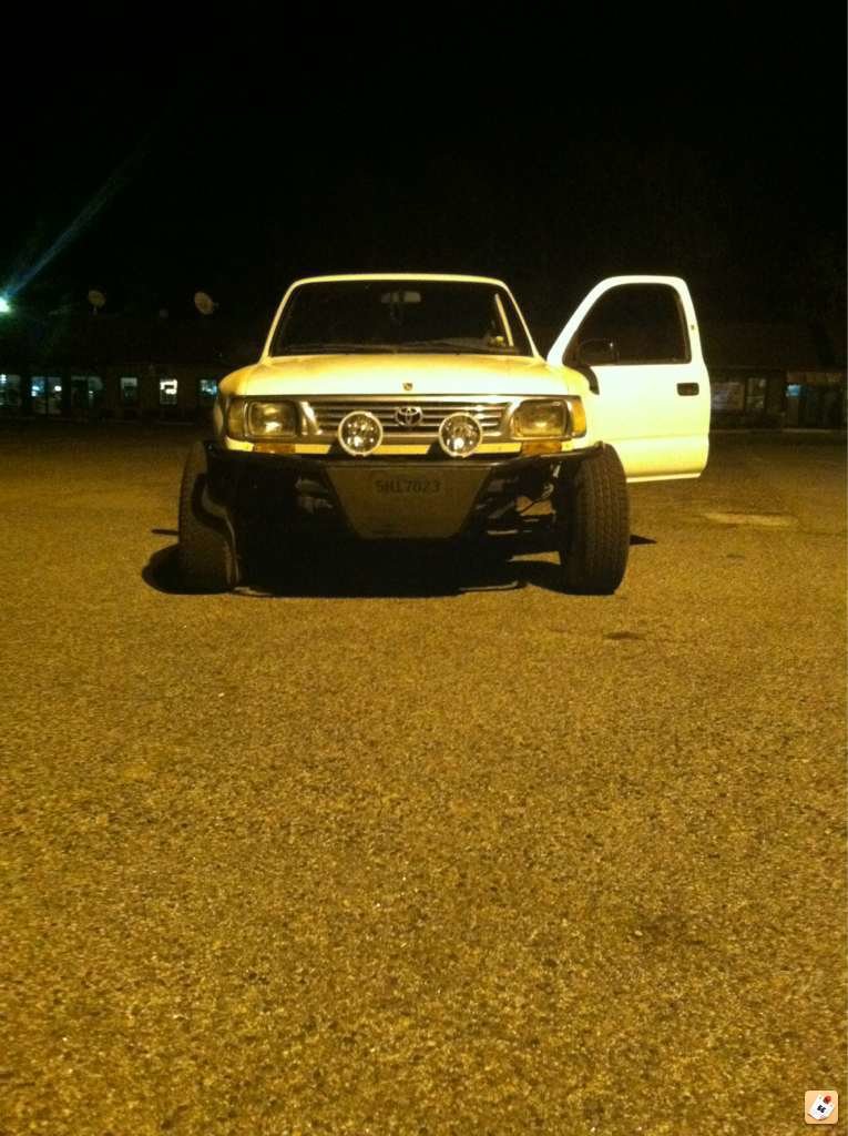

    y5y3u8uz_c746cfa2f36f6736e64bf6c2690033abaf5b607f.jpg with the new balljoints, fixed it temporarily

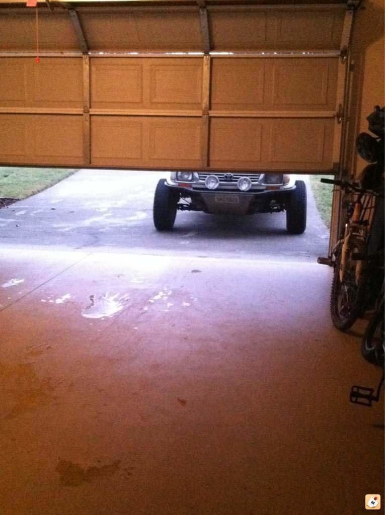

    u6e4edum_6cc7e0cd11d33f6bde7eca453b384982d8c67e38.jpg about a week later, all negative camber / \

    looks like you have super thick extensions/wheel spacers on the hubs or huge offset wheels, either way, the front suspension is taxed pretty heavy...
    pretty obvious, u trolling?

    No its a long travel kit. The arms are 3 inches longer then stock on each side. I had the issue even with the stock arms

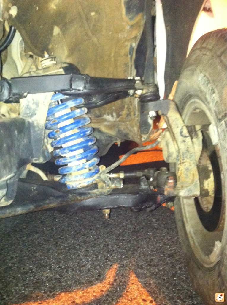

    anumehur_0030e14525671c846013267036687859379188a4.jpg the arms for those new to long travel

    The coil doesn't look right.
    And why aren't you running coil overs?

    Its fine, thats the way the stiffer fabtech coil sits in the 5 lugs bucket

    Is this "long travel kit" homemade by chance? Cause it kinda looks like you have 2 stock UCAs hacked together and a stock LCA bolted to another LCA.

    Yeah that's not a 'LT' kit that's the stock shit cut and extended with plate steel.... And it does NOT look very well done for suspension components. This coming from a half ass backyard welder. That looks scary dude

    In reality here though your problem stems from your extended arms. You've moved the wheels out quite a ways from the coils themselves. This introduces way more of a moment and makes the spring "feel" like it's holding way more weight than it really is. So you need either way stiffer coils (not recommended) or just take all that shit off and either go back to stock, get a manufactured long travel kit, or hell do a little more homework and make your own kit. I'm all for DIY stuff, it just looks like this one was poorly conceived. Time for version 2.0

    He is running coil overs.
    You are running coil overs.
    These are not coil overs (notice, coil not "over" shock, those are bumps in the coil):
