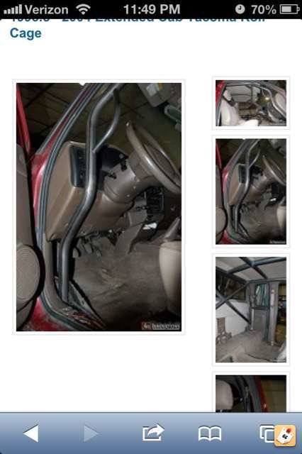

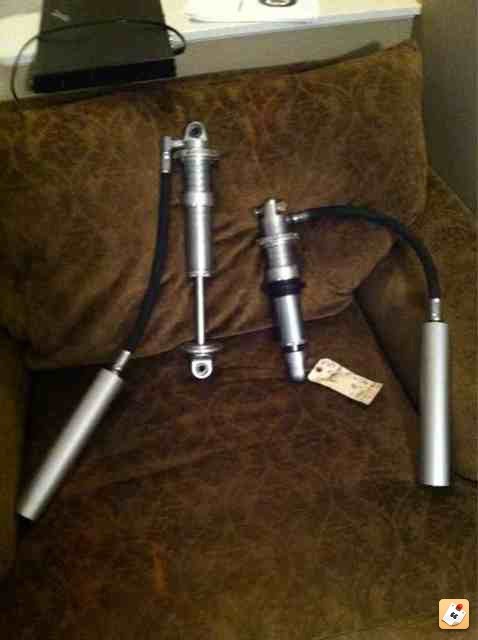

    I havnt died yo, trucks undergoing some much needed improvements, new lowers, coilovers, deavers and a cage 7aga9e5u_fbf4bd18bd9a8750f790cd4d51bd4f3541085039.jpg ygagyduq_3238dcd29e063ee2100fe9f3275a3887ed749b3a.jpg manabuzy_bcd7d0d09c0f94137a6755473b93ca778916abfb.jpg eryhe3uv_9862162ba7d2e3dc7d1464318e8e2f24e654dd7c.jpg buying the 4xinov cage

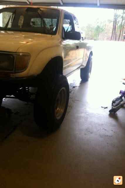

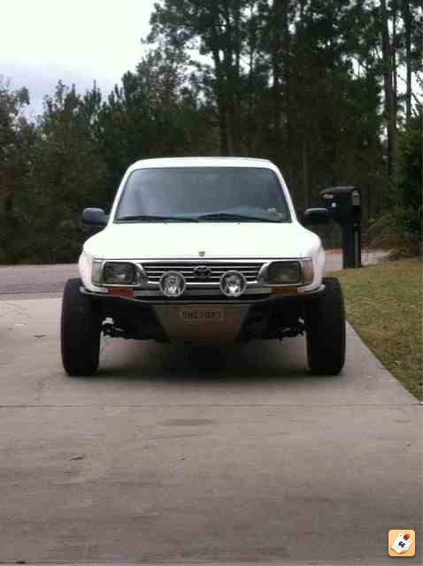

    6yry9uty_1ba0518eaa91d2500d544377124a29092f039e3e.jpg camber fix
    mypehezy_6f2e05331724ef22ef8fb50ab28b180eb11deea0.jpg cruzin
    Never got that jump vid tho... Trucks been off dirt while im putting on the C/Os

    How did you fix the camber issue?
  13. Nov 28, 2013 at 5:11 PM
    #333
    IDtrucks
    IDtrucks Unhinged and Fluid
    Jun 2, 2010
    #38254
    23,536
    Mark "Buck"
    Jackson Wyoming
    96' X-Cab 4x4 TRD Off Road Clusterfuck
    JVC Deck, 10" sub mountd in rear seat cubby, 2 LED off road lights mounted in grille, amber raptor style grille lights, LED rock lights, square led bed light, custom made fuse block tray, 12 blade Blue Sea fuse block, 100a marine circuit breaker, black plasti dipped full grille, tinted tail lights + third, Uniden 520 with 4' firestik, Bilstein 5100s with 620lb Eibach coils, Diff drop, Chevy 63 leaf swap, TG creeper joints, 14" triangulated biletein 5125s, 8" extended steel braided brake line, TG Rock Sliders, CBI Moab 1.0 front bumper, custom fabbed bed rack, full TRD E-Locker axle swap and matching re-gear with custom stand alone wiring circuit, 29 spline pinion flange from an 06 wishbone runner, tubbed for 35x12.5" general grabbers on Ultra type 181 wheels, crush sleeve eliminator, Mini ARB compressor, front ARB locker, garage fab aluminum front skid plate, custom built high clearence rear bumper, removable mothafuckin doors
    Hahaha ya I saw that too.
    So can we get pics of the new arms and cage design
  14. Nov 28, 2013 at 6:12 PM
    #334
    5lugger95
    5lugger95 [OP] Well-Known Member
    Feb 14, 2013
    #97501
    93
    The steering rack had shifted from bashing into stuff which caused very unequal tie rods which somehow screwed up camber. It was my understanding that tierods only effect toe but after talking to alignment shops and actually fixing it, the can cause bad camber issues. Ill be buying a new rack and the poly bushings soon so that doesnt happen again

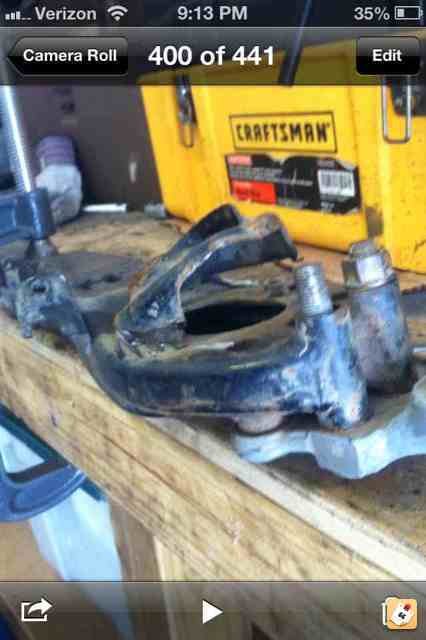

  15. Nov 28, 2013 at 6:16 PM
    #335
    5lugger95
    Feb 14, 2013
    #97501
    93

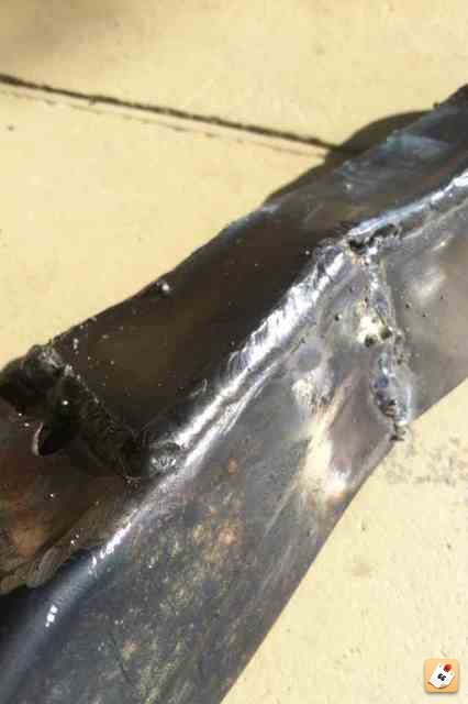

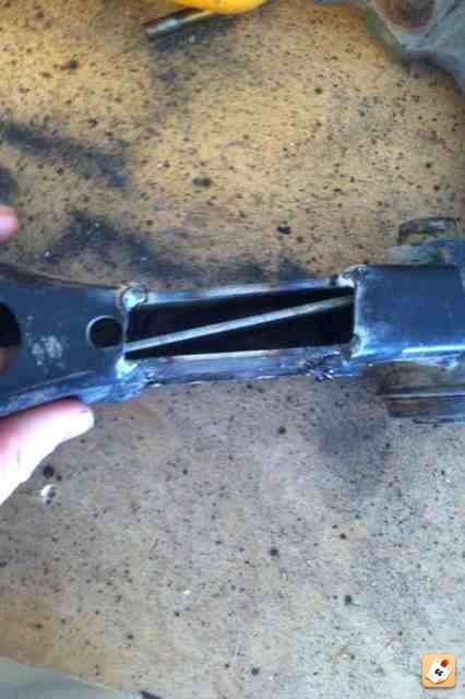

    geva6u9y_0a049eeca2b772cd22c0b272dfba454849eff3c0.jpg new ride heigth hopefully
    re3y5agy_69f258d94b9656d68ba21fd9bffcc235ac71f420.jpg coilbucket delet
    4uqysesy_6f4ca28a6e7c5ae417334453a2a41e5850ffe208.jpg welds are getting better
    qanubu2u_d89ed393526fb5b24ec3bb55896599f7dda83ef2.jpg arm extension
    Will be plating top sides and bottom of the arms

    And the cage is 4xintovations prefabed cage, dont have money for a bender just yet
