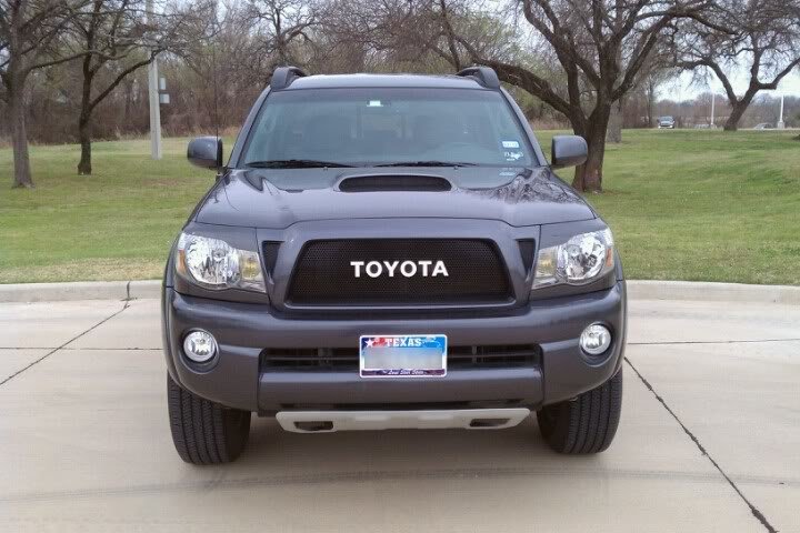

  4. Feb 20, 2012 at 6:22 AM

    Autolumination Yellow fog light bulbs, Dynomax Ultra Flo muffler, AFE Pro Dry S air filter, tailgate security mods, TRD skid plate, DeeZee bed mat, Armor Lid tonneau, OEM roof rack, TRD center caps, Satoshi grille, Sockmonkey tailgate decal

    Pretty good match there might be looking further into this.
