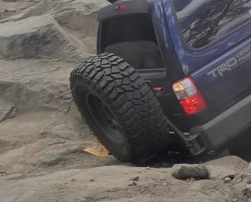

  20. Jul 8, 2021 at 2:22 PM
    #80
    MattJakobs
    MattJakobs [OP] Everything but a Tacoma
    Dec 12, 2014
    #144174
    7,305
    Matthew
    NorCal
    1985 4Runner w/ FlipPac
    [​IMG]IMG_6548 by Cory Bechtold, on Flickr
    @cbechtold takes good pictures.
    New rear shock hoops have been welded on. Rear disc brakes are in order. Waiting on new Kings...
