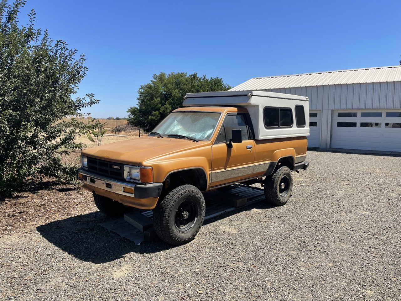

    Just picked it up from the previous owners house.
    I drove it around the block once I got it home. It runs okay, idles rough, and there are no brakes at all. The engine harness is messy, was chewed through by some rodents, and was put together with some quick splices. I'm hoping that replacing the harness, flushing the brakes, and getting a solid tune up done will get this thing road worthy again. If none of those items give me too many problems, I'm hoping to have it ready for some wheeling come spring.
    I'll update this thread accordingly.
