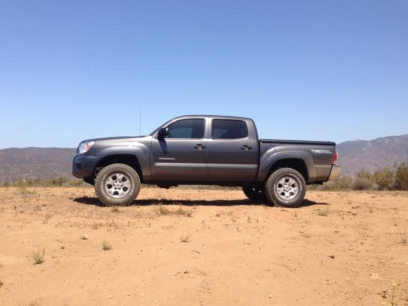

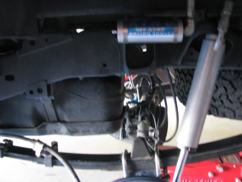

    This was with my first suspension and tire combo. I had my King coil-overs at zero lift and ran the Icon AAL with my stock leaf pack with overload spring removed. I ran my stock TRD off-road wheels with 265/75R16 BFG All-Terrains.
    This was a perfect combo that didnt rub anywhere and let me get 18-20mpg on the highway.

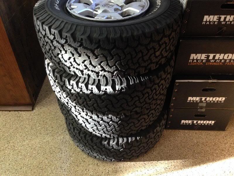

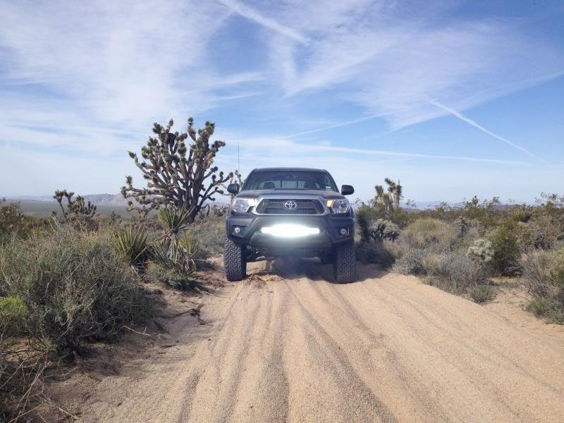

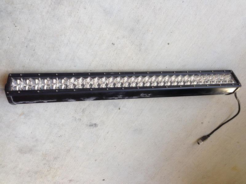

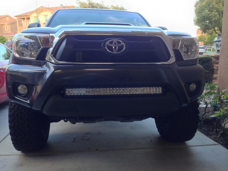

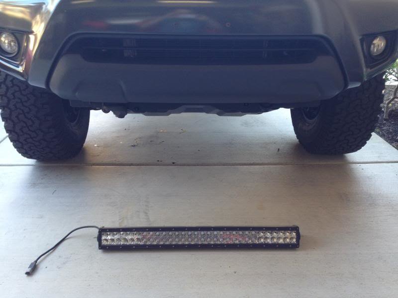

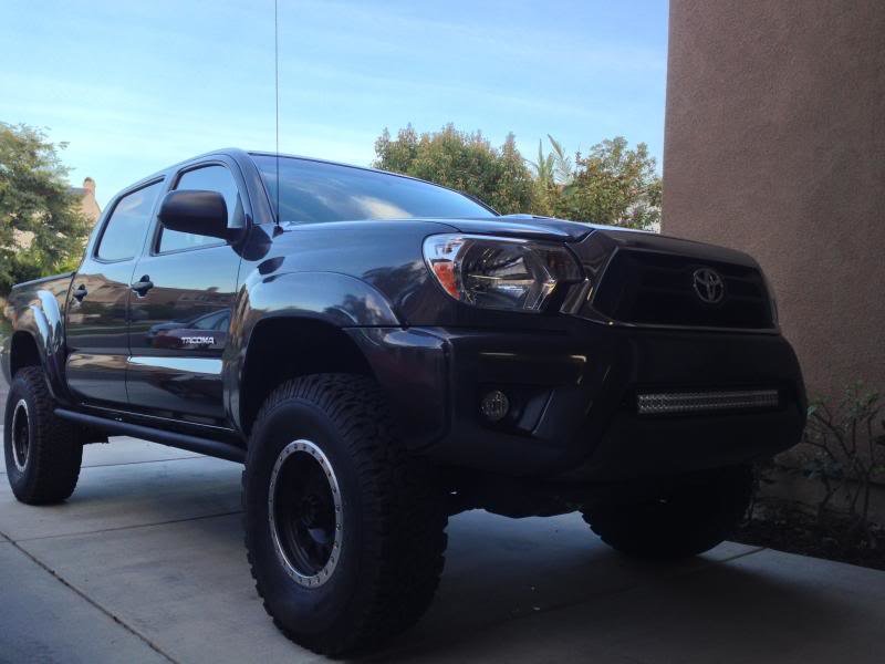

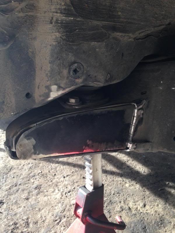

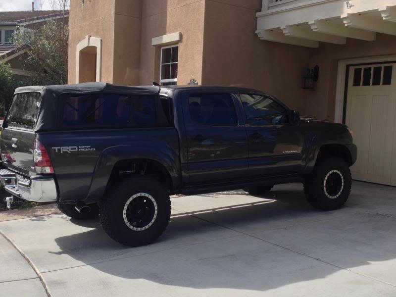

    I did the cab mount chop, raised my coil-overs, added the BFG 285's on Method wheels, and added the All-Pro standard leaf pack.
    I picked up a used Rigid 30" E-series LED light bar on Race Dezert for cheap that was originally used on a Class 7200 truck for one race. I used the Rigid brackets part #40156 to mount it in my lower valence. The brackets are designed to use with a Rigid 30" SR single row light bar. Other members have stuffed 30" LED double row light bars in the lower valence with good success so I followed a proven formula and did the same.

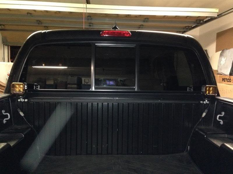

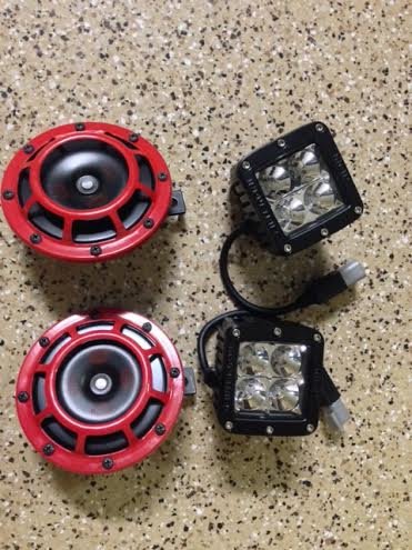

    I picked up these Rigid dually lights BNIB from a fellow TW member for a great price. I plan to use both of these as dust lights by buying the yellow clip on filters from Rigid.
    http://www.rigidindustries.com/light-covers/20193
    I also picked up these Hella Super Horns from 4WP. I used a $25 off a $50 purchase coupon and picked up these $60 horns for $35. I had these on my last truck and they are a great upgrade to the stock horn.

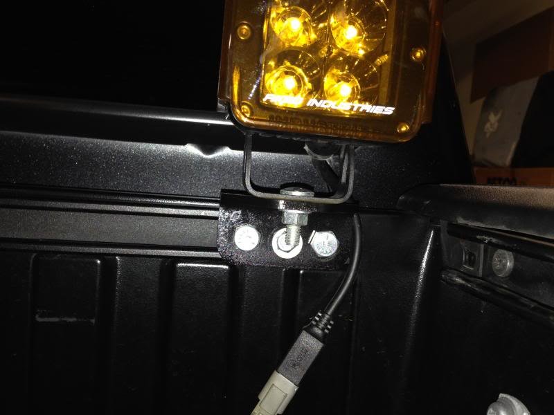

    My only new addition was wiring up the Rigid Duallys I picked up and buying yellow covers for them to use as dust lights. I mounted them on the rear bed rail with bolt on brackets.

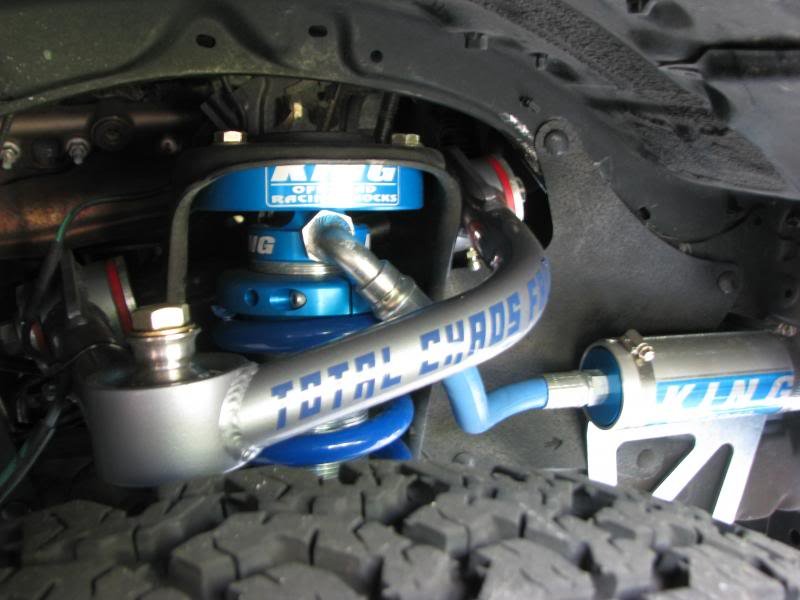

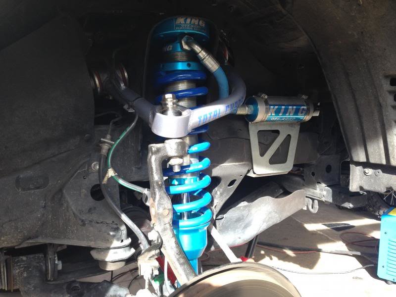

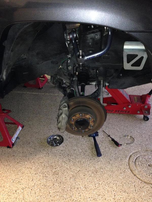

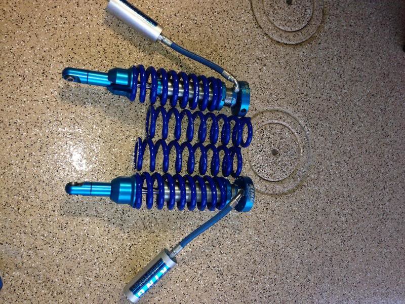

    My coil overs were really soft on my last offroad trip to Barstow so I contacted the crew at Downsouth Motorsports this week to swap out my 600lbs springs for a 700 lbs spring.
    Im a double cab short bed 4x4 without a plate bumper so I thought that I would be fine with the 600lbs springs.:confused:
    I have the coil overs back on the truck now so we will see how they settle. Im also curious to see if I need to go back down to a 600lbs spring when I add a secondary shock next year.

    Here is my take on the 700lbs springs. Driving hard and not bottoming out is amazing. I was bottoming out so hard the last Barstow trip and now I have to do something pretty stupid to make the truck bottom out now. Everyone's driving style is different but the 700lbs springs are what work for me.
    My front ride height is probably a tad too high for my CVs liking but Im hoping that the springs will settle down more after my next dirt trip.
