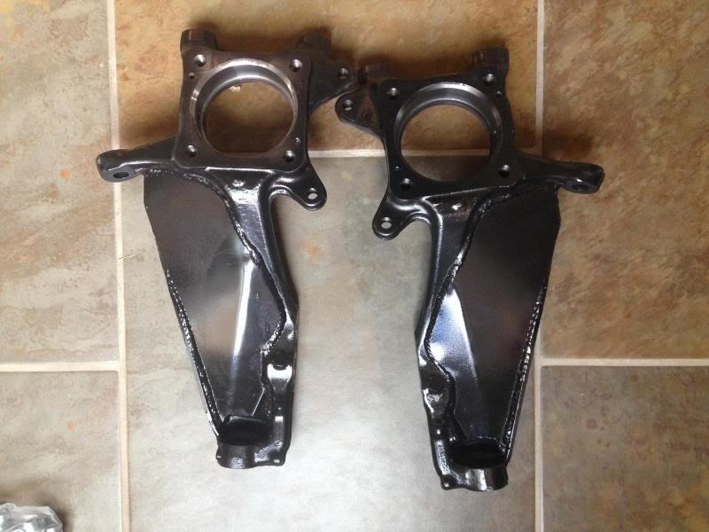

    I got a few parts in the mail and Im excited to install.
    My extra set of spindles just came in with Solo Motorsports gusset kit.

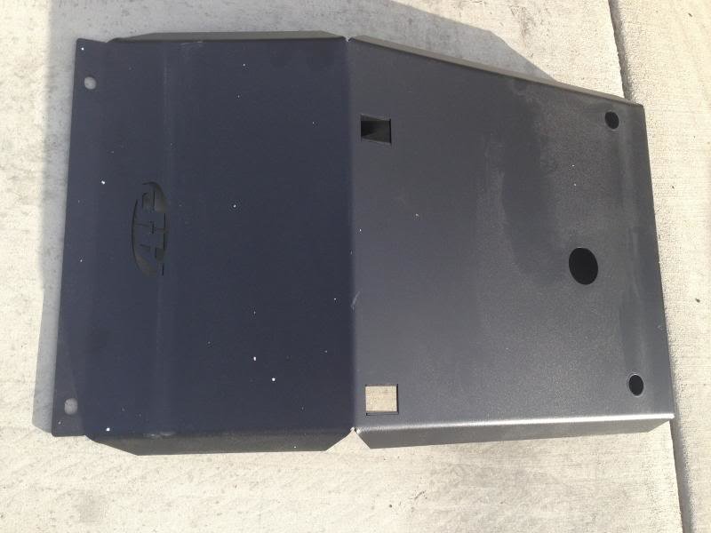

    I ordered this All Pro IFS skid and it is already installed.

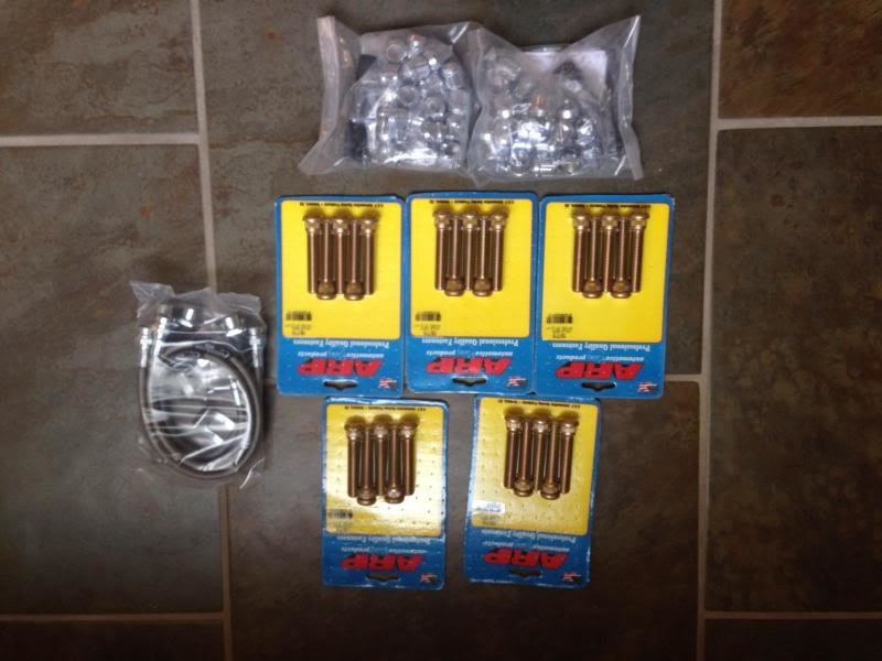

    I also ordered ARP wheel studs all around with new ET open lug nuts. I am having a new set of hubs built by a vendor on TW and I shipped him the studs so he can build them.
    I also picked up these stainless steel brake lines front/rear to help slow this heavy beast down.
