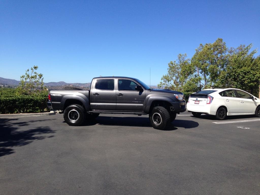

    My truck is all detailed and ready for her new owner that will be picking her up tomm afternoon to take her back to Wyoming. Ahhh Bittersweet
  16. Aug 14, 2014 at 5:28 PM
    #96
    06HAOLE
    06HAOLE [OP] Well-Known Member
    Jan 4, 2008
    #4102
    3,196
    Fort Worth, TX
    2019 Ford Raptor

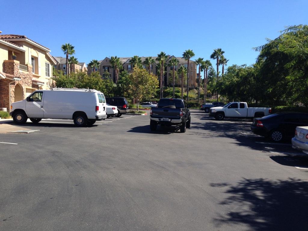

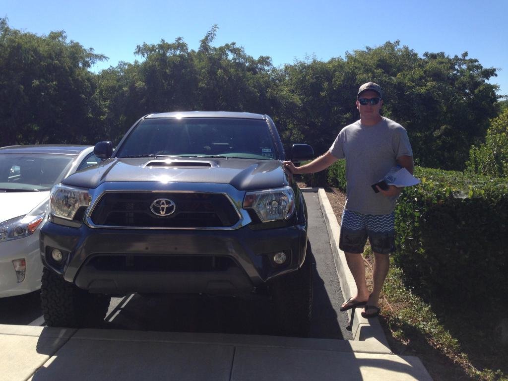

    Away she goes.

    Nope. It's not. I feel comfortable knowing that if my dirt truck breaks I can park it till I'm ready to fix it.
    If I kept that 2012 as a daily it really was dialed in. I kept up with all of the LT trucks in all but the deep whoops. Bypasses and bumps made it a whole other truck.
    Just my gas expense was so much that my Prius pays for itself in gas savings. Now more truck funds. Lol
