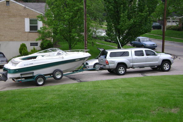

    I just towed my Four Winns 205 (20ft) from Cincinnati to Lake Norman NC. The boat is about 3500lbs and guessing the trailer is another 1000. That in combination with gas, gear, 4 people, luggage, and a couple of coolers I think I had to be close to 6500lbs. I would strongly suggest getting a trans cooler especially with that terrain. I averaged about 10mpg the whole trip but the truck really had no problem running 70mph. A few hills slowed me down and the trans. was running in 3rd gear and I never shifted it out of 4th gear. With this much weight I would suggest adding air bags or maybe a new leaf pack to stiffen up the rear suspension. I just added the Dakar leaf pack and didn't bottom out once on the whole trip. Overall I was really impressed w/ the power and performance during the trip but take it slow. Its a lot of weight behind you and make sure the boat trailer have trailer brakes that are working. This is what i towed for 8 hours.
