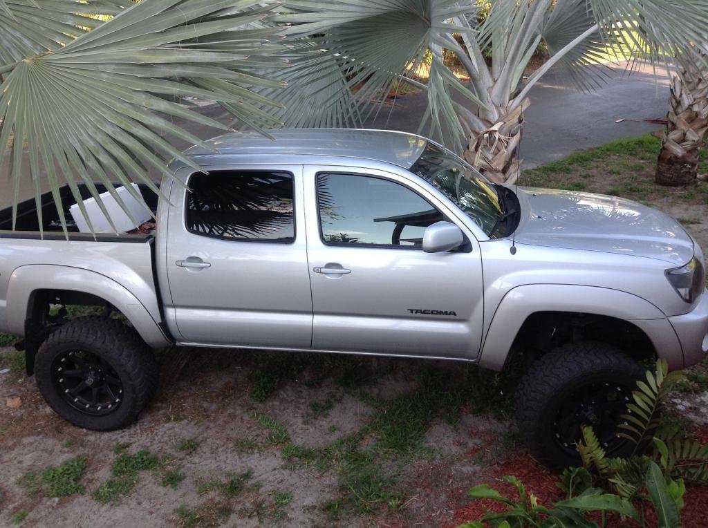

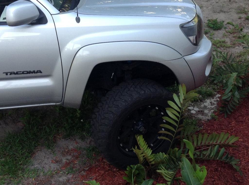

    Ok here ya guys go!! First off check out the amazing ground clearance.....I love it!!
    And a few crappy pics I took off my front porch this evening with my ipad:
    I can't stress enough how much bigger this truck is after I put the rest of the lift on!! I feel like it was more than 2.5" more over the 4" spindles I originally went with. I would however like to put on a 2-3" body lift on top eventually and then go to 35s

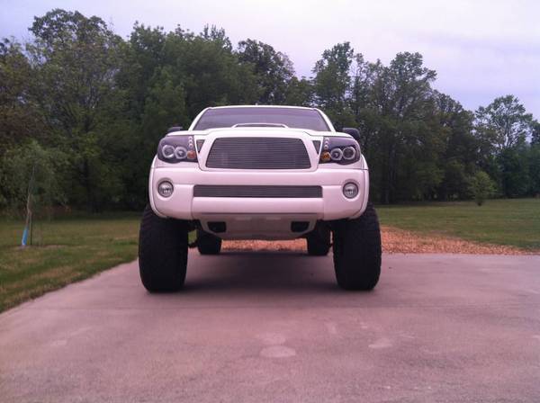

    Everything was installed yesterday! Step up as of now:
    Front- Maxtrac Spindles, bilstein 5100s set at 0, and eibach coils.
    Back- OME Dakar leaf springs, 2.5" blocks
    Total lift in front - 5.6"
    Total life in back - 5.5"
    It sits almost level, I believe I was holding my camera crooked because it's not leaning that bad. The front is slightly higher than the front but it isnt noticable at all. I'm extremely happy with it. It rides a little stiff but not bad at all. I may need to replace my UCA's asap. What do ya'll think?

    Looks good, shouldn't have to replace UCAs as the eibachs only give about 1.6 inches of lift, if you were closer to an extra 3 inches in front you'd need to.

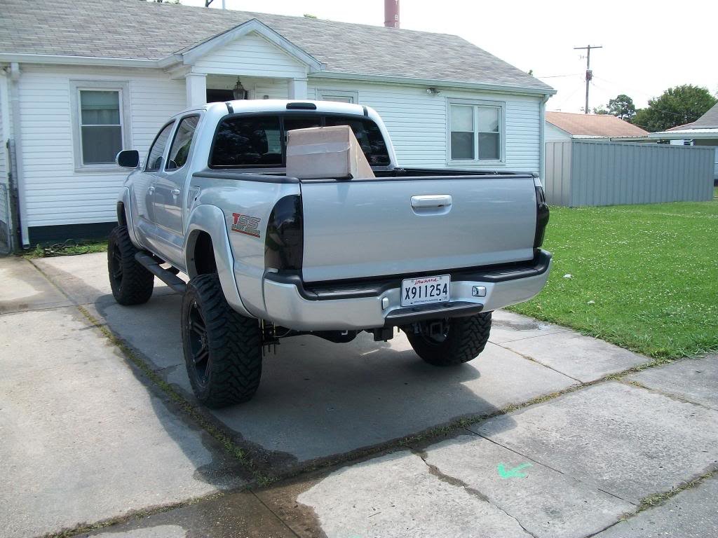

    So found one downside to all my lift...outting the kayaks on the roof is a pain in the ass...but they look pretty sweet up there :cool:

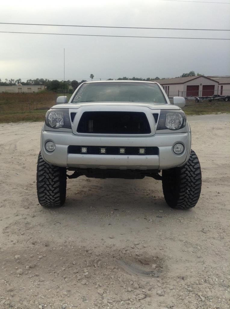

    I think I did a write up on the process somewhere....the jasper Offroad group buy thread I believe.....they are not rigid lights (brighter and cheaper) I bought a lower valance mesh piece on here from a member awhile back and just cut four squares in it and mounted the lights to the aluminum bumper support directly behind the opening and a little lower. It couldn't have worked out any better honestly ill post some pics give me a second

    As you can see I had to drill holes in the top of the aluminum bracket and holes in the front to get a wrench in there to tighten the nuts on the light mounts

    The two center lights are flood pattern and the outside two lights are spot......light up the night pretty good :D
