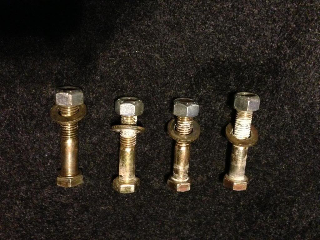

    Quick question for all of you installation experts: I bought my spindles used knowing that I would need new brake lines. The seller told me i would get everything I need besides the brake lines. I got 4 bolts, 4 nuts, and 4 washers with the spindles. Is there anything else I need besides the brake lines?

    Did he give you the brackets that the ABS sensor cable attaches to. They mount up with M8 bolts to the smaller holes about halfway up the spindle. There are pictures of them on the installation instructions on the maxtrac website.

    No brackets or any other bolts, just the spindles and those 4. I'm having brake lines custom made.

    If i remember correctly, the spindles didn't come with the brackets...the stock brackets were cut and used, i think.
    edit: and brake lines were included with mine.

    Seems like I need to make a call to Maxtrac and see what I need to get. I don't have the brackets and I don't think I have half the other parts on the list. I literally don't have anything but the spindles and those 4 bolts.
    I'm hoping this is the case. I bought these knowing that I would need to buy brake lines, but didn't think I needed anything else.

    U do modify a stock bracket but also there ahould be like 8 little clamps

    ^^This. Brackets are existing as he said you just need modify them.

    I have some extra clamps. Also you need 8 of the washers not 4.

    Do you guys think I should try to get the clamps and washers through maxtrac or could I find the right sized alternatives at a hardware store?
