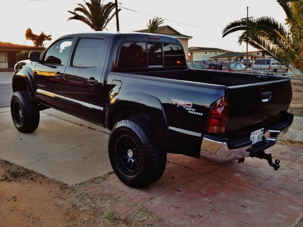

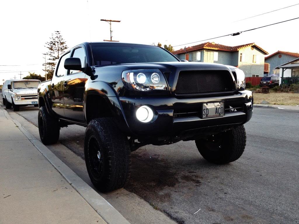

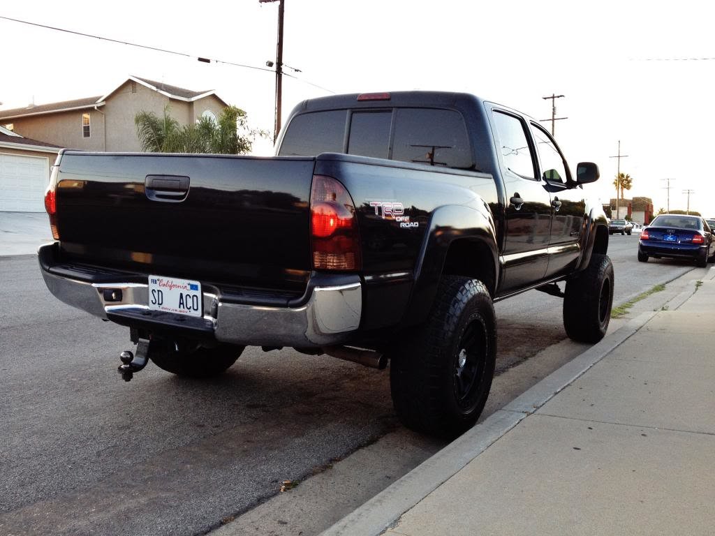

    Holy mother of bro lean!! ahahaha. Looks like it gave you positive camber. Im pretty sure I have some negative camber on mine.

    HAHAHA! I have 3" all pros leafs... It's because I left the 2" spacers in during the install. Too much? lol
