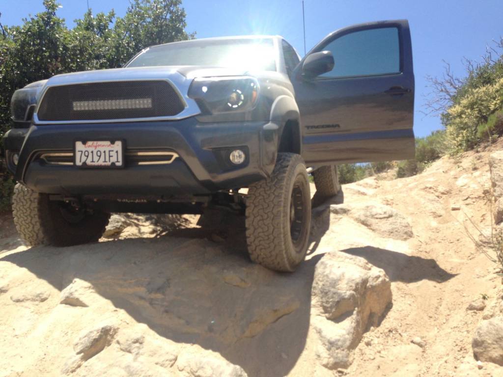

    Well I just put these Icon Resi's and UCA's on last Wednesday and took them out for a test run on Cleghorn road in the SoCal Mountains.....all I can say is there is no comparison between my 5100's and these bad boys...was like riding on butter all day!

    LOL. I still stare at them every time I walk in the garage and after the ride they gave me this past weekend I got out of my truck on the trail and proposed to both of them!

    Is there something wrong with the gravity in SoCal? :rimshot: Ride looks good with the Icons though, wish I had me some of those!
