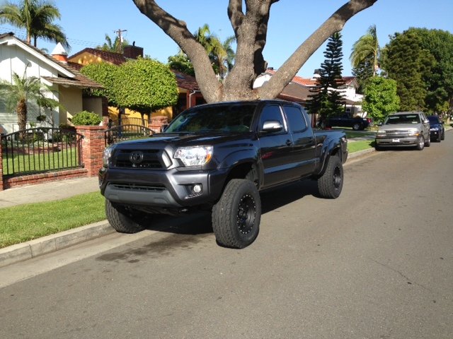

    2013 DCLB TRD Sport
    King 2.5" Coilovers, Total Chaos UCAs, Maxtrac Spindles, 2.5" King Rear Shocks with Compression Adjusters, Wheelers 1.5" AAL, 18" Magnaflow muffler, 30" LED Lightbar, Ultragauge, Tinted Windows
    Yeah, maxtracs up front and stock 4 leaf pack in the rear

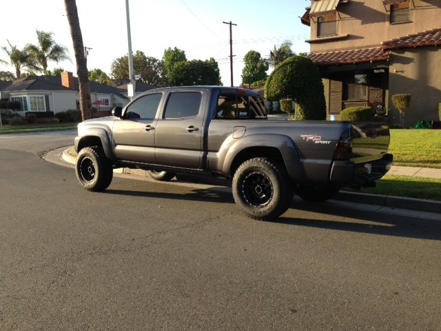

    2013 DCLB TRD Sport
    Yeah my second picture is a little deceiving too. It sits with a bit of bro lean. Not as much as I thought it would though.
    Anyways, I have a question for those running aftermarket coilovers. Do i need new uppers even if I run King standard travel OEM replacement coilovers with no preload? I want new coils but don't want to crank them up. I might try with a little preload but probably 1"-1.5" additional lift at most. I know stock uppers should be fine with those angles but I guess my question is will I be limiting the coilovers' performance by using the stocks?
    The truck is a mall crawler 99% of the time but i do like to get it off the pavement once in a while.

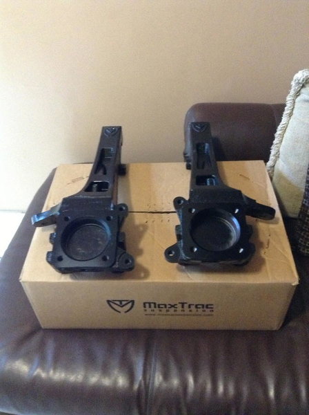

  20. Jul 12, 2013 at 6:37 PM
    #2460
    tacomonazul
    tacomonazul Well-Known Member
    Mar 4, 2012
    #74163
    3,384
    Luis
    SOCAL
    07 DCSB LT/4LINK
    http://www.tacomaworld.com/forum/2nd-gen-builds/227832-my-never-end-build.html
    Just got em' painted matte black
