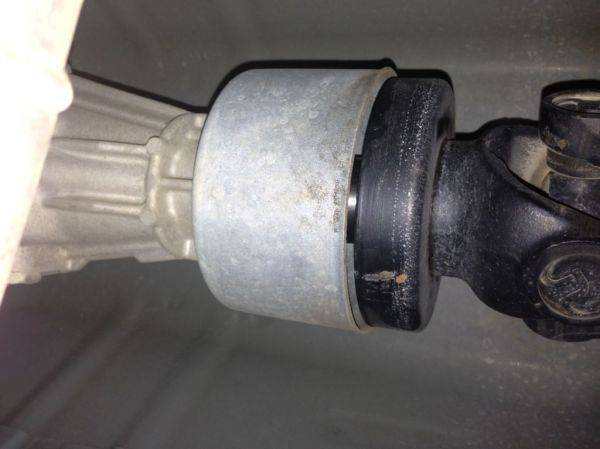

    So after heading down to a driveline shop and being recommended to have my driveshaft extended 1" I went ahead and ordered a driveshaft spacer from 4crawler.com. I received it today and installed it, only take about 30min to install. I took the truck for a test drive and had nearly no vibrations, I'd say it cured my vibes 99%. My carrier bearing is starting to whine a bit so that 1% could be due to the CB being bad so I'll have to replace it and see how it goes from there. My only complaint is I wish I would've a ordered a 3/4" spacer cuz it looks like the shaft might be sitting a little to far inside the trans housing. I wasn't sure how far in it needed to be so I figured 1" would be fine.
    I'm keeping the 1" spacer for now since I'm able to drive with my truck with no vibes but already ordered the 3/4" so the 1" will be up for sale in a few days.
    I couldn't be happier with this product though!

    It should be almost flush like this

    From the looks of it, your slip yoke doesn't look to be too far out to begin with. I have an inch before mine sits flush in the trans housing.

    U can actually see up inside my the shaft and everything. .its real bad

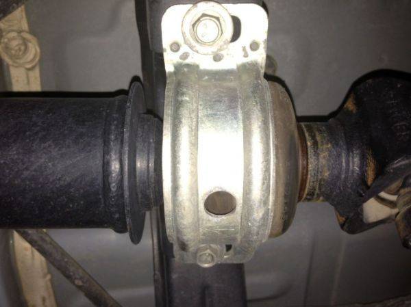

    Heres mine...didnt get before shots..but it was bad....I used a 1.25" spacer

    I ordered an 1.25" spacer this morning. Mine is bad.

    Thats EXACTLY how mine was...I just had my bearing and driveshaft replaced.."under warranty" so dont wanna blow out another...was gunna do the 1.5 but the 1.25 was perfect. ..I have 5 inches of rear lift on 35s
