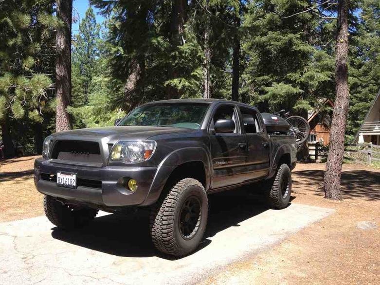

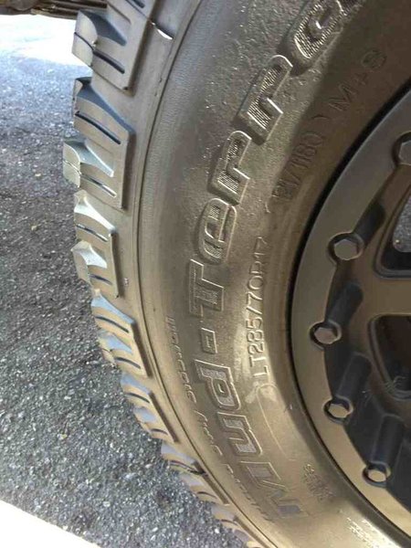

    Lol! Yeah, they're 285/70/17 which is ~32.8". However the outer diameter measures 33.3" (per Treadwright website). ImageUploadedByTapatalk1378236814.734265.jpg
    I trimmed some plastic, and the only rubbing I get is on the cab mounts when the suspension compresses while turning (still need to do a cab mount chop). I'm wondering if they just look big because the dust on the tires make them pop out more in the previous pictures?
