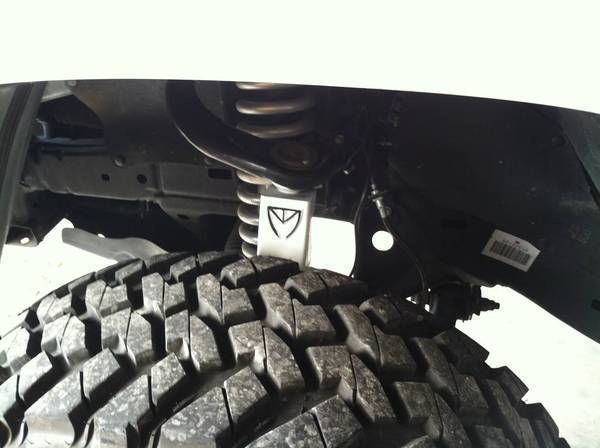

    Bruceleeroy30
    Bruceleeroy30 Well-Known Member
    Nov 1, 2012
    #90273
    73
    Ed
    SF Bay Area
    2010 mgm Dbl Cab TRD OR PreRunner Short Bed
    Satoshi Grille, Yellow Lamin-x Fogs, Maxtrac 4" Spindle, All Pro Expo Leaf Pack, 5100s, inverted Daystar bumps
    I do try to do as much offroading as I can.. And no probs at all. When I lifted my truck, I ran with my stock 16s and stick BFGs. I ran a 1.25" wheel spacer in front to clear the spindles. It didnt look retarded at all.
  6. Sep 4, 2013 at 7:18 AM
    #2706
    Bruceleeroy30
    Nov 1, 2012
    #90273
    73
    Ed
    SF Bay Area
    ....at least I didn't think it look wetodded. Lol.
    Here's a pic, post lift with stocks.
  7. Sep 4, 2013 at 7:49 AM
    #2707
    Biscuits
    Biscuits Thorny Crown of Entropy
    Aug 8, 2010
    #41397
    15,577
    Swiggity swangin' biggity bangin'
    I have the UCA's already as well as the extended brake lines that came with the spindles. I'll look up what I can do about the stock bumps in the meantime before I buy new ones. As far as the carrier bearing drop is concerned, I remember reading about that so I'll have some washers in hand to measure the thickness of shims that I need should I need them. Good looking out!
  8. Sep 4, 2013 at 8:21 AM
    #2708
    BytorTruck
    BytorTruck Well-Known Member
    Oct 24, 2011
    #65792
    167
    Brandon
    Scottsdale AZ
    That looks really good, good work!!

  11. Sep 4, 2013 at 7:12 PM
    #2711
    87twentytwor
    87twentytwor Well-Known Member
    Nov 19, 2012
    #91423
    242
    Jake
    Hawaii
    Sport
    none
    Looks good!!! You got a slight rake yes?
  12. Sep 5, 2013 at 8:42 AM
    #2712
    Bruceleeroy30
    Nov 1, 2012
    #90273
    73
    Ed
    SF Bay Area
    Yup
