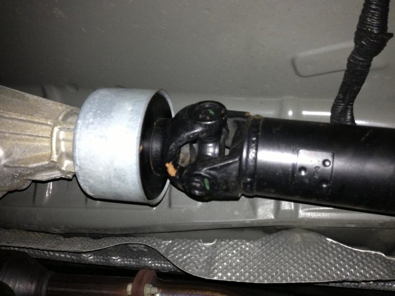

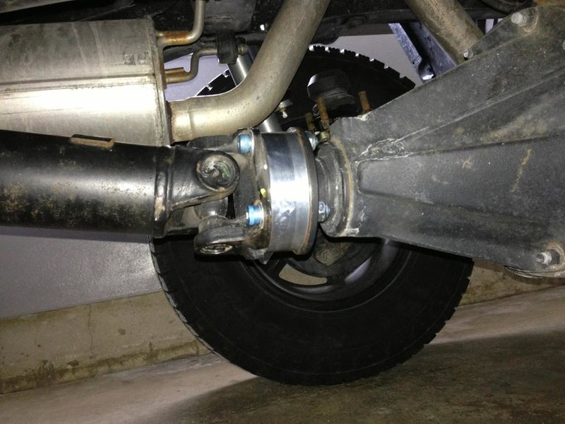

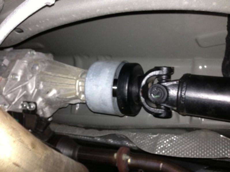

    Do the driveshaft spacer which will push the driveshaft where it should be. I also posted a pic of how your driveshaft probably looks now and where it should be coming out of the tailshaft of the transmission. You can get these here and they sell them in different thicknesses so you can get the one that is right for your application. I run the 1.25 and im at 5" front and 4 rear as well. No vibes or shutters at all.
    http://www.4crawler.com/4x4/ForSale/DriveshaftSpacer.shtml#Note3

    Holy crap bro you are a life saver this is exactly my problem!!!! Dude you are awesome!!!this is what I need!!!!:yay::yay::yay:

    Is anyone running these drive shaft spacers? My slip yolk looks EXACTLY like the sample photo above. I'm currently running an Expo leaf pack with a homemade driveshaft drop to fix the angles an I have no vibes? Should I buy one?

    Yes buy one
