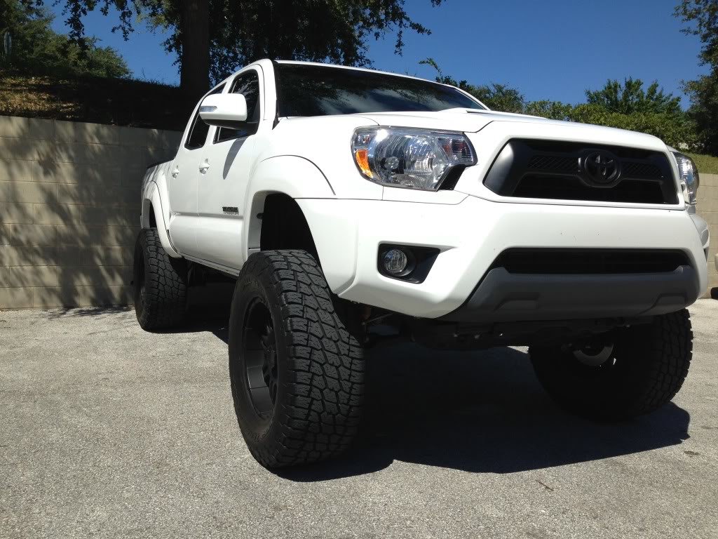

    How the rubbing?

    On your way to beast mod I see. Truck looks bad ass man nice job, I am thinking of going 35's how are they working for you. Did you need to trim much and it looks like your on stock suspension how is that working out with the 35's did you re-gear.

    Dr Doom doin it right! Nice work bro. How you liking them 35's on the highway

    I want to know how bad the rubbing is and if he had to trim the flares and do a CMC?

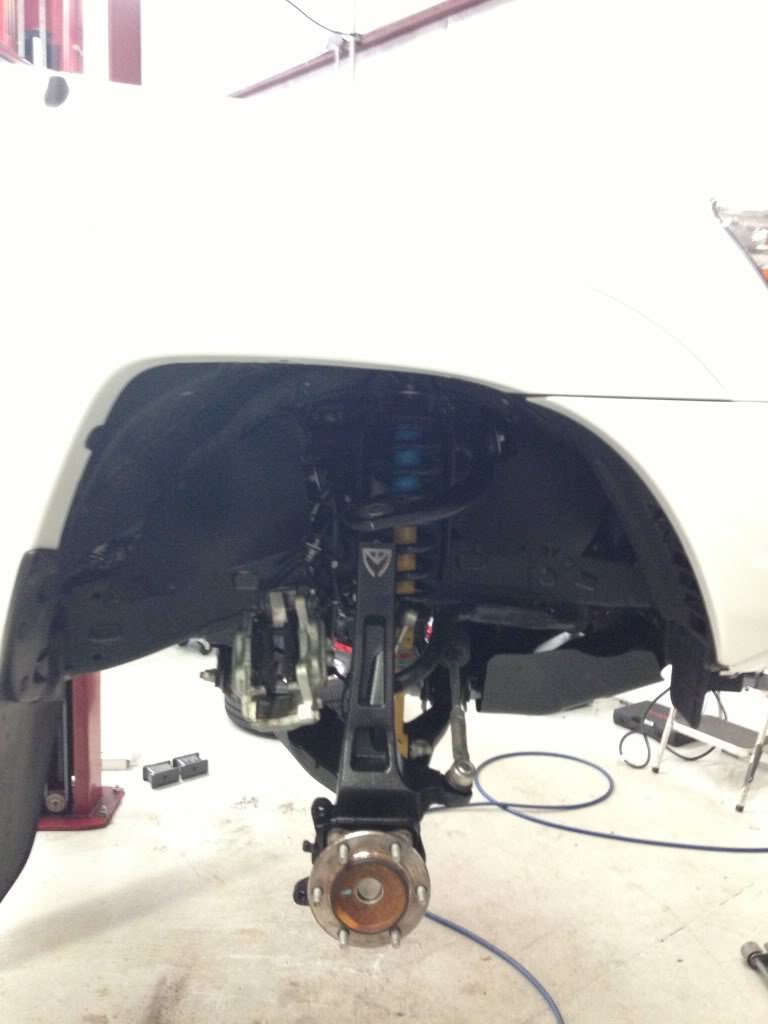

    How did you guys route your ABS lines? The suggested routing in the instructions is somewhat vague for me to understand, so if anyone has some pictures or diagrams I'd greatly appreciate it.

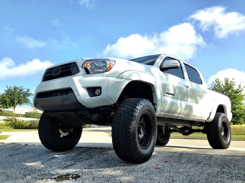

    The lift I got came with front spindles, a 2inch front strut spacer, and rear 4" blocks. The truck drive great for being as lifted as it is and the tire size, it rubs a little bit on full lock. I had to trim a decent amount in the front, like the coroner of the flare and the splash guard in the front.
    I haven regeared it yet but I need to for sure. At 70mph I'm at about 1800rpm. And my adverage mpg is right about 16.

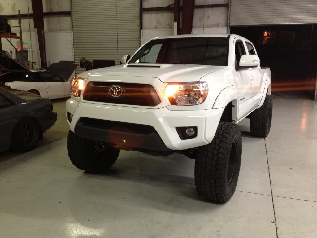

    if you wanna offroad with 35s then you will need to do the cmc lol

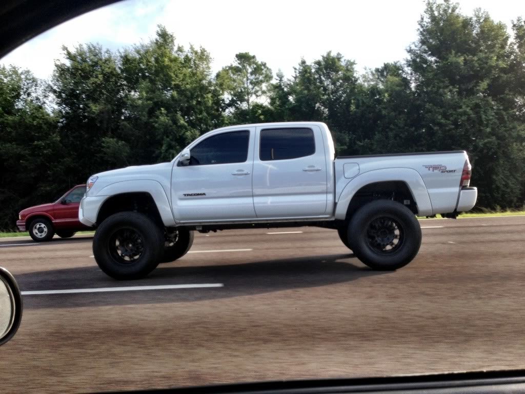

    looks like giant ass blocks

    yep, think he said it was 4 inch blocks.

    Might want to change that as soon as you can. I had 1 1/2" blocks and could not wait to get rid of them, four inch blocks must be like riding on stilts.

    Never mind. I answered my own question. The pictures on the online .pdf version of the instructions are much clearer.

    yeah haha for sure, it rubs all over the cmc haha

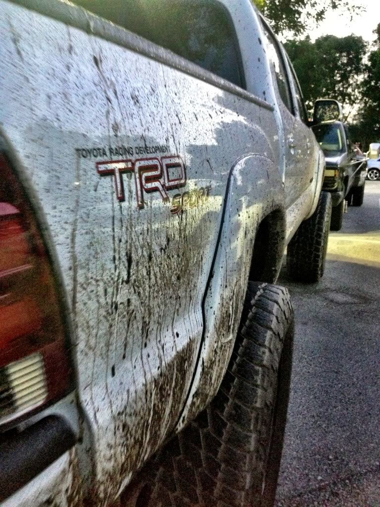

    rubbing is like a never ending battle

    i thought i was clear of rubbing...till i landed like this lol
