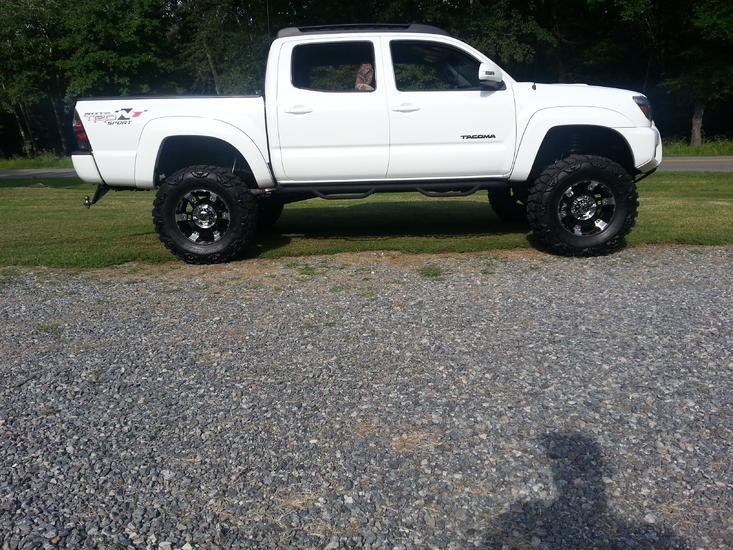

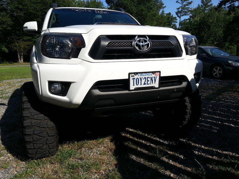

    Im running the spindles..5100s at 1.75" and eibach 1.6" springs..3 inch block and 1.5 aal pkus tsb springs....35x12.50x17..17x9 4.5bs and -12mm offset..1.25 spidertraxx spacers all around..I rubbed pretty damn bad...ive done tons of cutting and grinding but no longer rub..most recent pic with my new emblem and with the new 35 mud grapplers
