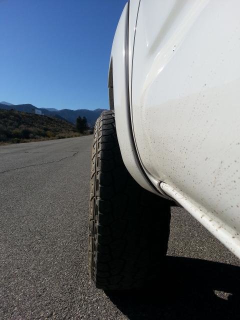

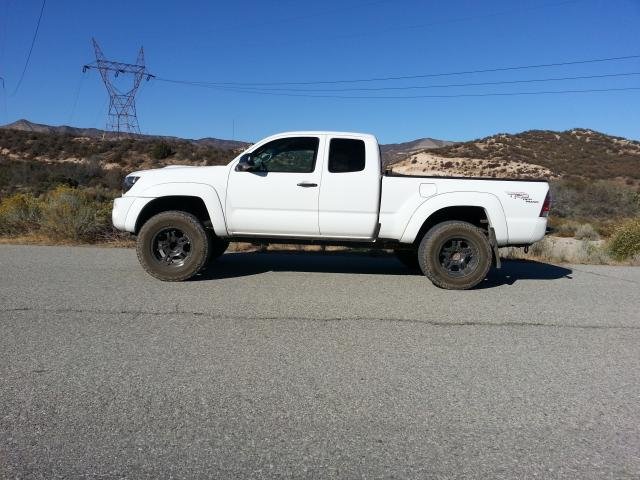

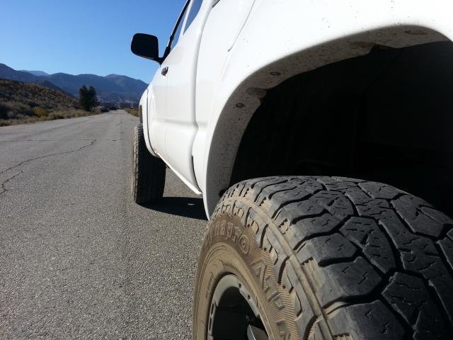

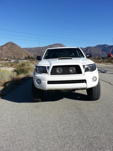

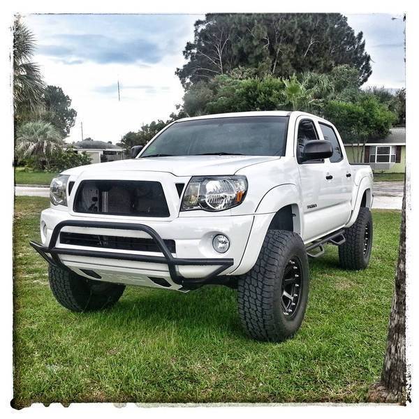

    Love my Maxtrac spindles. Installed them about 3 weeks ago by myself. Took me 11 total hrs to do front, back and all four shocks. Running 3" blocks in the back (till I can swing the Allpro Expo Leaf Pack) Bilstein 5100 Extended Rears, 5100s in the front set at "0" for now. Plan to bump em up to .85 since I've got a little rubbing with my 295/70/17 (33.5x12) Terra Grapplers. The ride so far is rock solid, even with the rear blocks. 85 mph on the highway with no vibrations at all. But I do plan to do some towing in the future so the blocks are gonna have to go.

    Looks great!

    Thank you sir!

    Yes it does look great....

    Looks sweet Jason

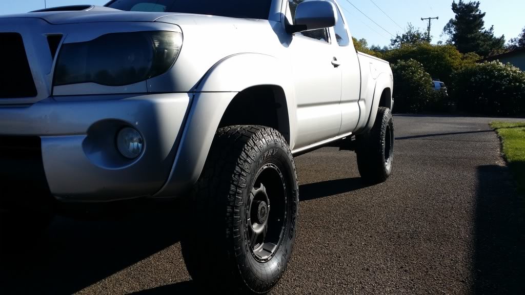

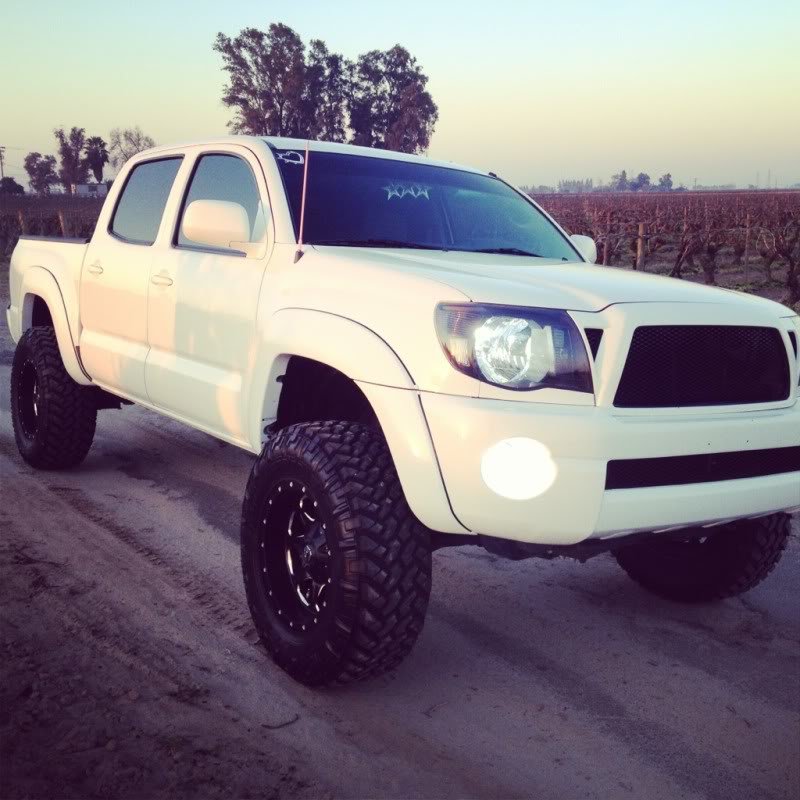

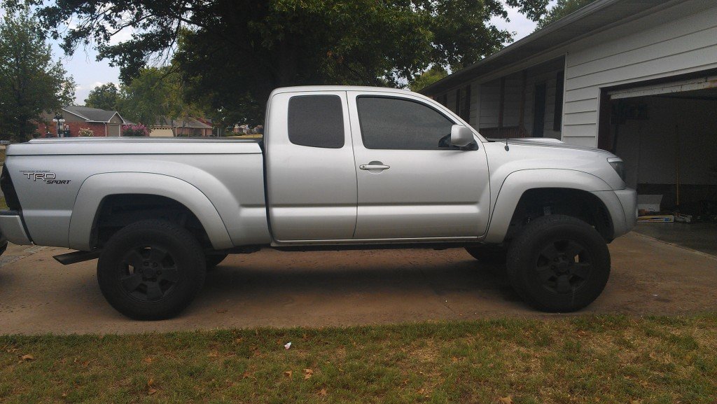

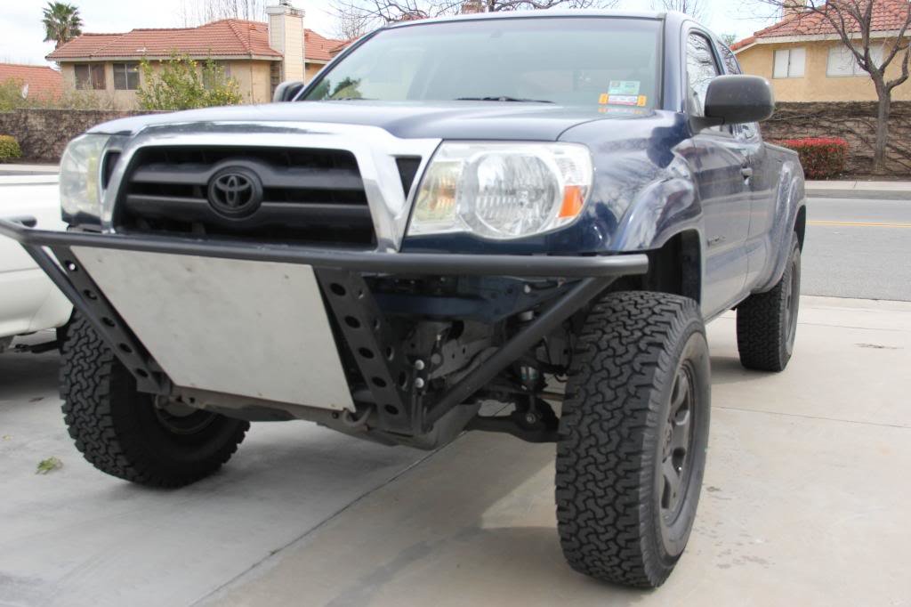

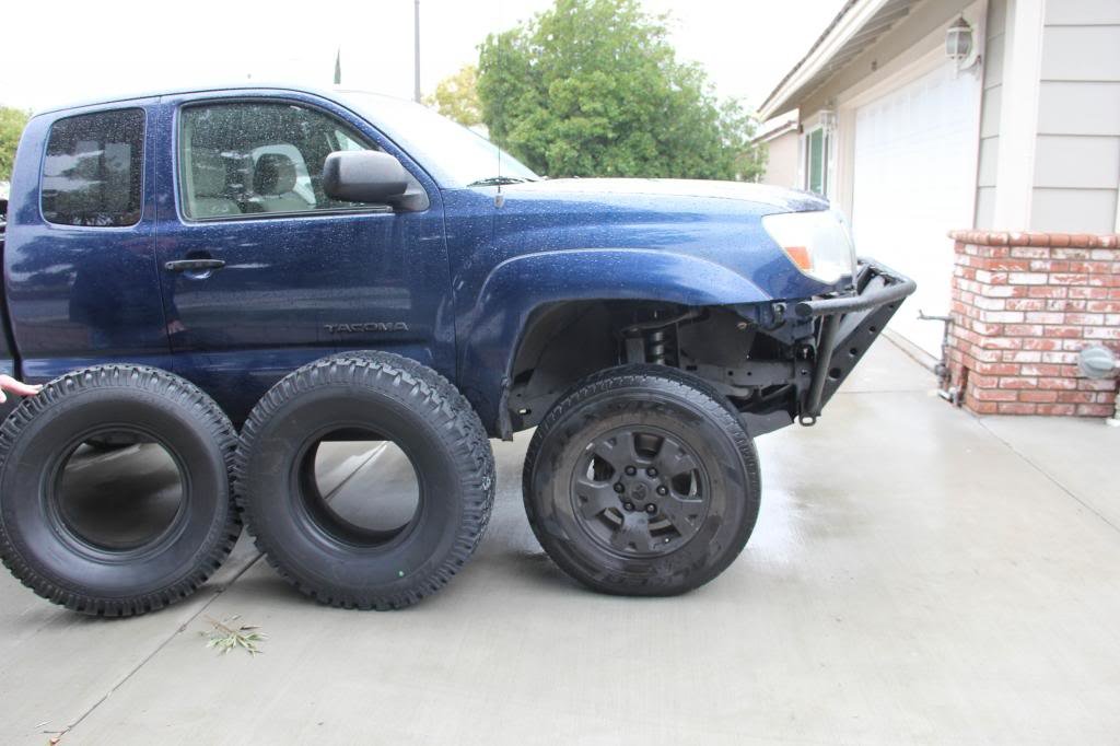

    Here is some input for you. Here is my truck with the stock tires still on them and then the second picture is with 285's
  11. Oct 14, 2013 at 11:56 AM
    #2811
    CDSurfPhotography
    CDSurfPhotography Well-Known Member
    Jun 28, 2012
    #81527
    922
    Cody
    San Diego
    06 PreRunner
    265/70/16
    285/75/16

    But what size add a leafs are you running 2"?

    man this looks great! you have to do something about your grill tho.
    open the hood, mask off the paint/headlights/other stuff and use some black radiator paint and paint the stuff behind the grill (radiator, exap core, lines) so u cant see it all thru the grill.
    it will look 100x better!

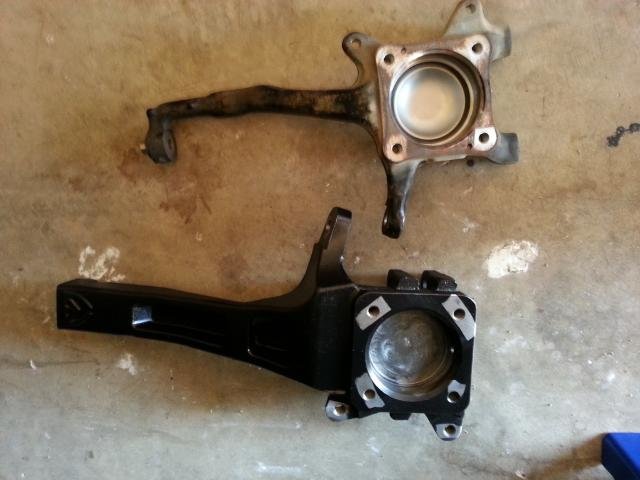

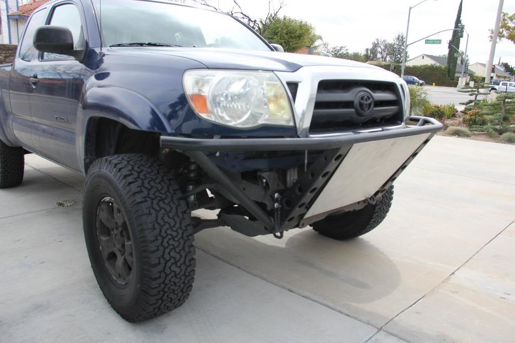

    Finished this a couple weeks ago. Purchased from HeadStrongOffRoadfor a great price, customer service and fast shipping. Install is pretty straight forward except when the brake lines wouldn't come off. Big thanks again to Chris for the help. Truck rides like a Caddy in the front with no sway bar and all the preload backed off the shock.
    Sits even. 24" center hub to fender in the front and back with a TSB add-a-leaf and extended bilstein 5100 shocks that have been in the back for 50K miles now.
    weak sauce vs strong sauce. Love the double shear lower mounts..
