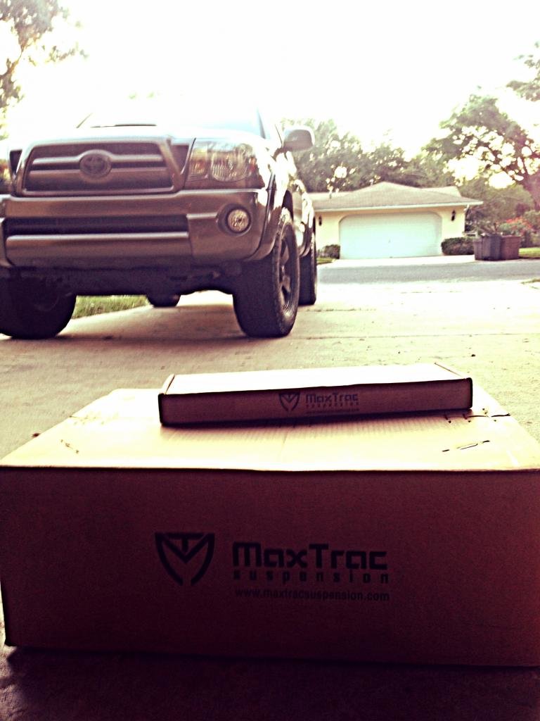

    Rear came in today, spindles will be here Friday. Can't wait to get these on
