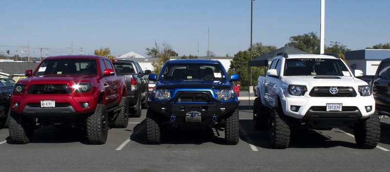

    :cool: the pic with all 3 trucks is...
    Red Truck has fabtech 6" drop bracket and coil overs cranked up for about 7.5 inches of lift
    Blue truck has icon suspension at about 3.5" of lift
    White truck (me) with maxtracs..billies..and eibachs for about 7 inches of lift
