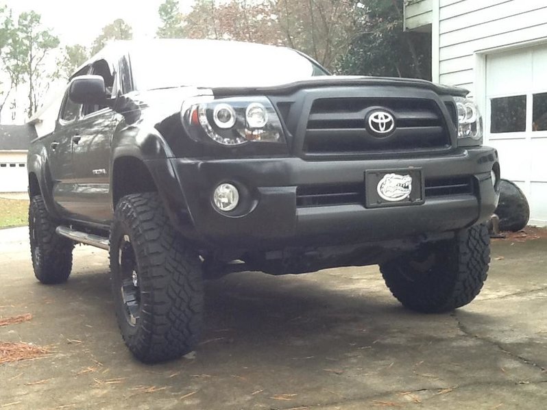

    Finally got a pic of my spindles installed. If debating on this, pull the damn trigger!! U will not disappointed and go with headstrong off-road. Will be your cheapest and best bet! Gave me an awesome deal with rear extended bilseins!
    Also finally made up my mind on duratracs. LOVE EM
    THANKS for all the help from u guys. Install was pretty simple and decisions were well made thanks to the forum!

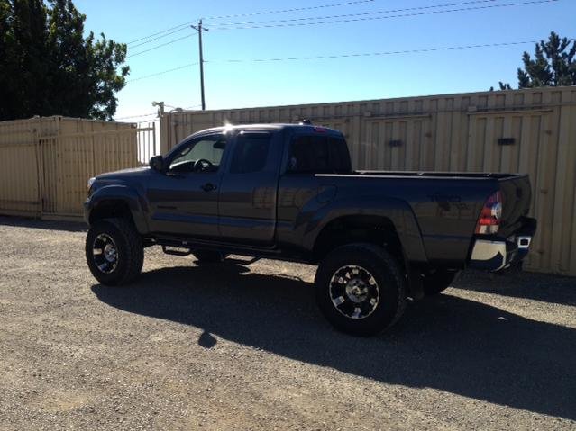

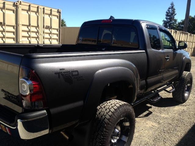

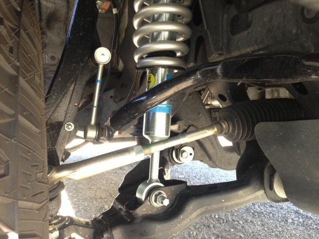

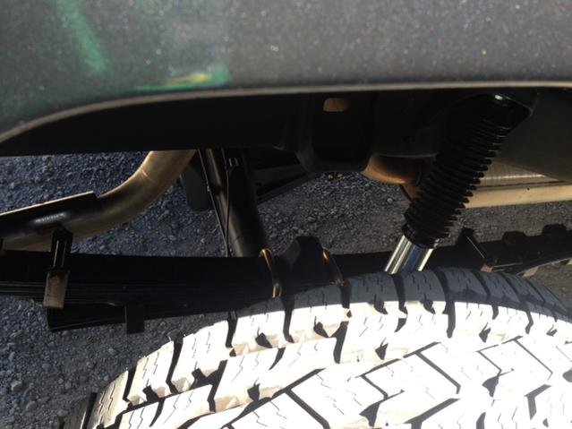

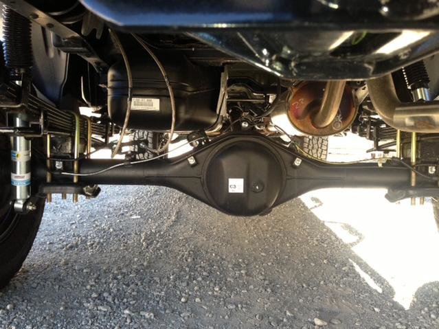

    I know that this has long been over due but just wanted to thank Yotamatt for the inspiration and great advise on my lift project. Also wanted to give a shout out to K9COP and MAXTRACBOB as well. Thank you guys! So this is what I did:
    Wheels n' Tires:
    KMC XD Spy 797 17x9, Toyo Open Country AT II LT285/70/17
    Modifications:
    Yakima Locking Bike Rack Mount
    N-Fab Nerf drop step bars 2" tube Powder-coated Black
    4" Maxtrac Spindles
    Steel braided extended (front) brake lines
    Bilstein 5100 Adjustable Front Shocks
    1.6" Eibach Coil Springs
    3-4" Bilstein 5100 Extended Rear Shocks
    2" Toytec Progressive 3 Leaf AAL (made by Deaver Leaf Springs)
    2" Rear Blocks
    Steel braided extended (rear) brake lines
    1.5" rear wheel spacers
    Black TRD NORCAL Bedside Vinly Stickers from Sockeye Monkey
    10g Powder-coated BLACK Skid Plate with TRD Logo from Matt123
    (Black) Plastidip emblems
    (Black) Shark Fin antenna
    And this is what it looks like now.

    Anybody have problems with the longer brake lines rubbing the sway bar mount?
    I also have bistein 5100's at 2.5 inches
  16. Dec 8, 2013 at 4:04 PM
    #2936
    TRDtexasTaco
    TRDtexasTaco Well-Known Member
    Oct 11, 2012
    #88770
    487
    JP
    Sunnyvale Trailer Park
    06 TRD PreRunner
    Billy shocks, Maxtrac spindels, AllPro standard leafs, BAMF shock relocation, King 2.5 smoothies
    yeah just take off the sway bar
