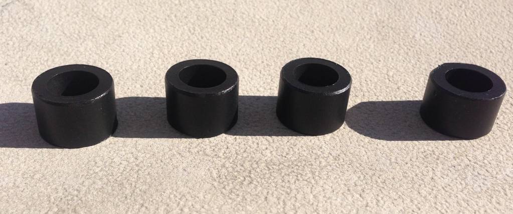

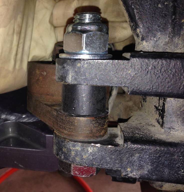

    I machined up some spacers for the Total Chaos LCA's to adapt to the Maxtrac spindles. Much happier with this than the washers I was using.
    Steel rod 1 inch OD, 5/8 ID and .680 height. They fit absolutely perfect. Just had to tap them in lightly to fit.

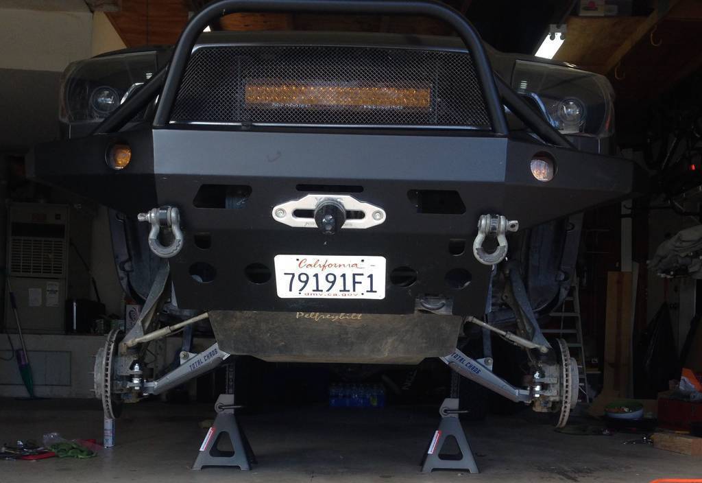

    finished product, they do work easily with the tc kit :D
