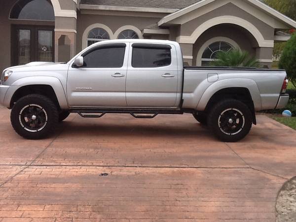

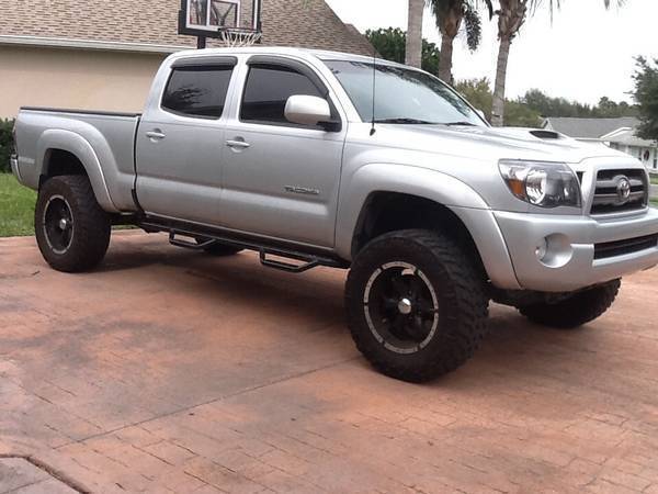

    For anyone that wants to see what maxtrac spindles in the front (everything else stock in front) and Allpro standard 3" leaf packs look like....here ya go, just got done installing the leafs, ubolt flip, ext brake lines and bilstein shocks in the rear.
    The front fender to center of hub measures are appx 24"' and the back are appx 25", i used to have a aal in rear and the front and back are about even.
    Im putting some billies up front next on the .85 setting....just wanted to take pics for anyone wanting to see.

    With just spindles up front you'll be at 4". 885 coils will give you 3". YotaMatt is running Spindles, 5100's, and eibach springs up front and it's probably just over 6". Looks damn good too.
    My truck on the left with spindles and 885 with about a 34" tire (worn out 315)
    YotaMatt on the right with spindles 5100's and eibach springs[/QUOTE
    Thanks man. Sick trucks btw. I'm jealous. haha. Think I'll just stick to spindles and billies then. Just wanted new coils because I wanted to improve the ride quality. But dont want to go higher than 4. Probably going with allpro standard 3 inch leaf pack in the rear too. Are new uca's needed as well?

    Very nice! Thinking about that exact set up too. How's it ride?
  7. Dec 28, 2013 at 5:01 AM
    #2967
    spencer00si
    spencer00si Well-Known Member
    Mar 16, 2013
    #99878
    74
    Clermont, Florida
    09 DCLB
    Maxtrac spindles, billies at 1.75, allpro stnd leaf pack
    Ride is great alot better than the aal.
