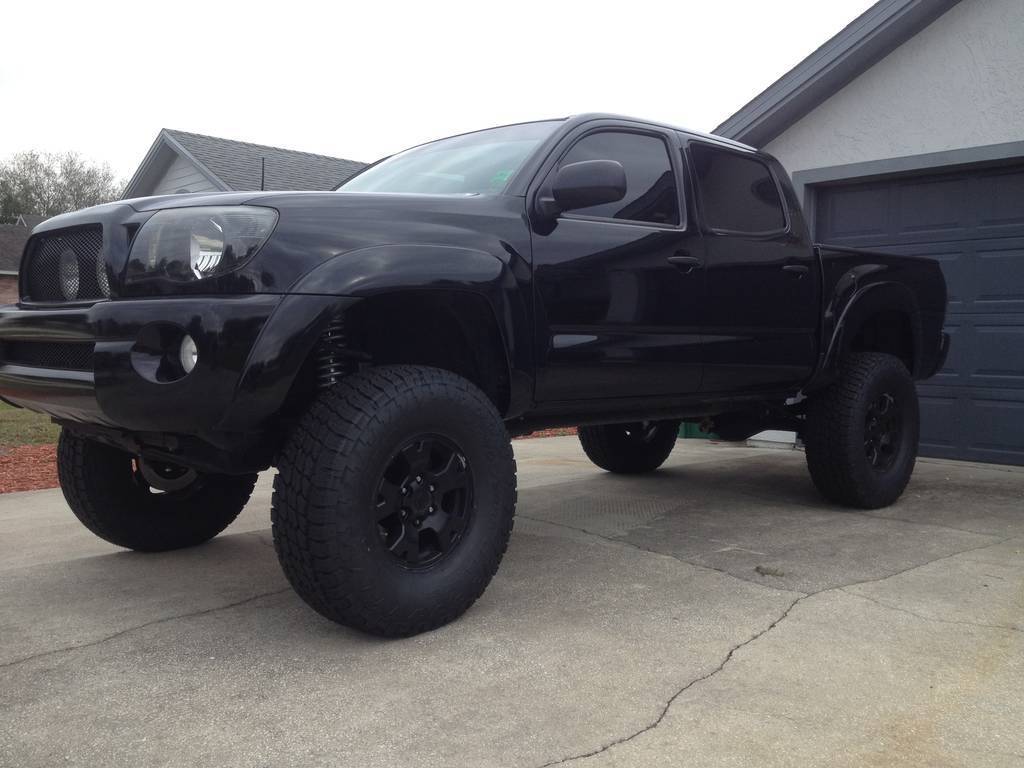

    Installed my lift with Maxtrac Spindles last week! Sitting high now...:cool:

    You have any down travel left up front? Those UCAs look like they are point to the pavement.
