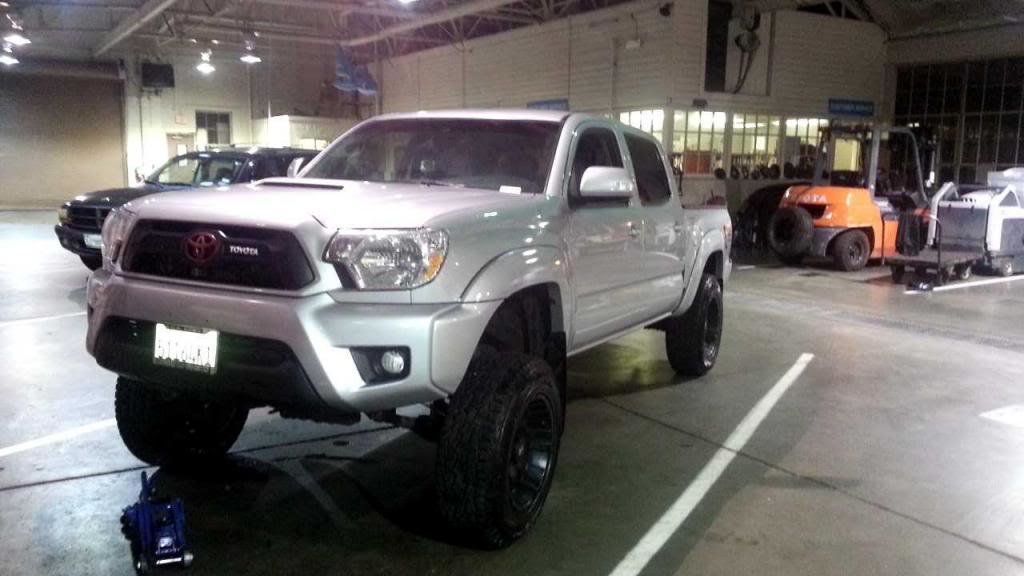

    Maxtrac 4'' Spindes -Bilsteins 5100 @ 1.75" - All Pro Expo Leaf Pack - Extended Rear Shocks - PC 5001 wheels - 285/70/17 Goodyear Duratracs - Debadged -Red emblem - AFE Pro Dry-S Filter
    With Benson X expertise I got the front end installed. 4'' Maxtrac + 5100's @ 1.75'' ... 2''Rear block going on today!
