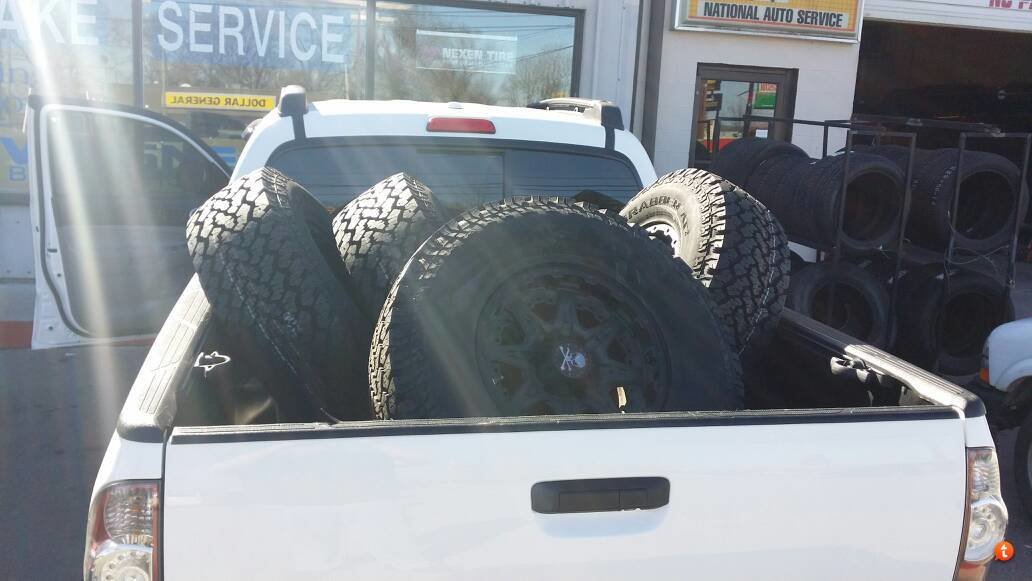

    It's beginning y2uqeryg_dee489daaea7e017287e737307dfcc8658433ca2.jpg Thursday can't get here soon enough

    Those are the same rims i have!

    Seriously?
    How far do they stick out with just the spindles.

    I couldnt tell you. Im running 6.5" fiberglass...
