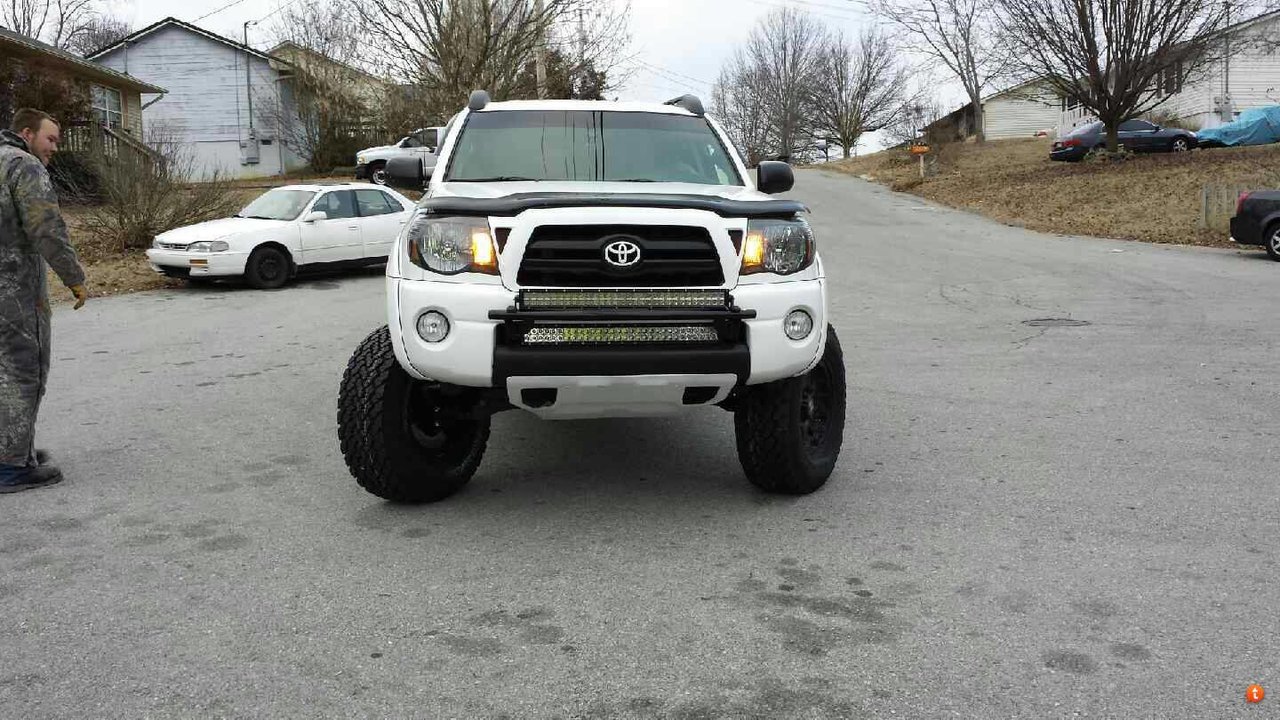

    Don't f's do it. I'm just now getting to sit down lol. Jk it's really and honestly not that hard. I did it in a day with one helper. Well two but he just grabbed tools for the most part and applied ky emblem to the spindles. I can tell you this if you sit in an office all day and and like warm weather don't do it today. I'm so sore across the shoulders it ridiculous. But I am also 6'6" and all that bending over sucks

    Really concerned about this. At full lock the tire is almost out of the truck

    Talking to me? Is it normal or did I screw something up.

    Can they fix some of that with the alignment.n

    Your toe is off, Get an alignment and see what happens. Should be good to go.

    Took 4 alignment shops to finally find out that could do the alignment. At firestone went ahead and got the lifetime alignment for 139.99 + tax

    looks good! how much was the whole set up?

    Alignment was 139.99+ tax, lift kit was 1146.00, tires 645.87 labor was free since I did it myself.

    Firestone got me right in and right out. Sounds like you went to a shitty one. Sorry man. But They did the alignment and Brought me out to the truck to watch. The whole I was on TW looking for specs incase they didn't get it like it should be. They got the toe at 0 the camber at 0 and caster was like 2.3 I think or maybe 0.23. Truck it at a friends house getting mocked up for new sliders since I don't want to put the step bars back on. He's been dabbling in metal welding and bending so I told him he could use it for mock up but not allowed to weld anything to it.

    I sure hope it 2.3 cause at .23 you will be wandering all over the highways.

    it was 2.3
